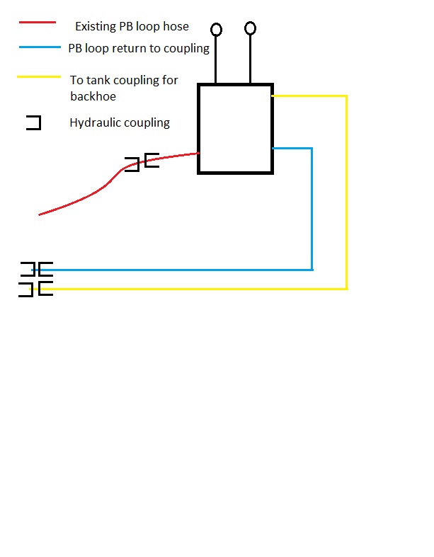

Anybody have a hydraulic Schematic for a BX25 TLB?
I want to add a set of rear remotes. I understand there is no factory kit available for the TLB, but a homebrew setup should be relatively simple to make.
I should be able to plug the rear remote valve into the PB loop and hook the Tank port to the tank fitting used when using the rear backhoe. Correct?
I'd like to have the valves removable so when im using the backhoe they wont be in the way.

I would like to do the same thing.
Selecting the valve seems the hard part. I don't know what specs to shop for.

i think that any open center dcv should work
