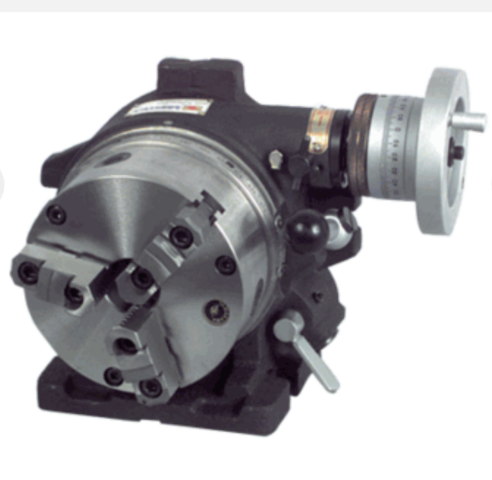

If I try hard I can probably get access to a Bridgeport but not that chuck! Now to find me a nice snowblower like yours.
   / Hydraulic snowthrower chute re-do #12
I tacked a piece of 2" scrap into the bore of the sprocket, then clamped that in my super spacer's chuck.
You don't need a mill to do this job. I will say it's nice to have one though.
All you need to do is figure out how to rig up a circle cutting attachment and then use either a cutting torch or a plasma cutter to cut the sprocket to size. The accuracy would be close enough for this application.
#13
Plasma and torch both leave dross that's gotta go before welding, but if it's what ya got - then yes, they'll get the job done. If you're using one of those methods, it'd make sense to cut 3 or four pieces of "pie" out of the sprocket, while leaving yourself some "legs" towards the center. That way you have less surface to grind clean, and fitting it up tight for the welds should be a snap.
If you have access to a lathe, you could cut it on that as well.
I love my super spacer! :D They're crazy expensive now, but I got mine 10yrs ago for $400 and it's been worth every penny.

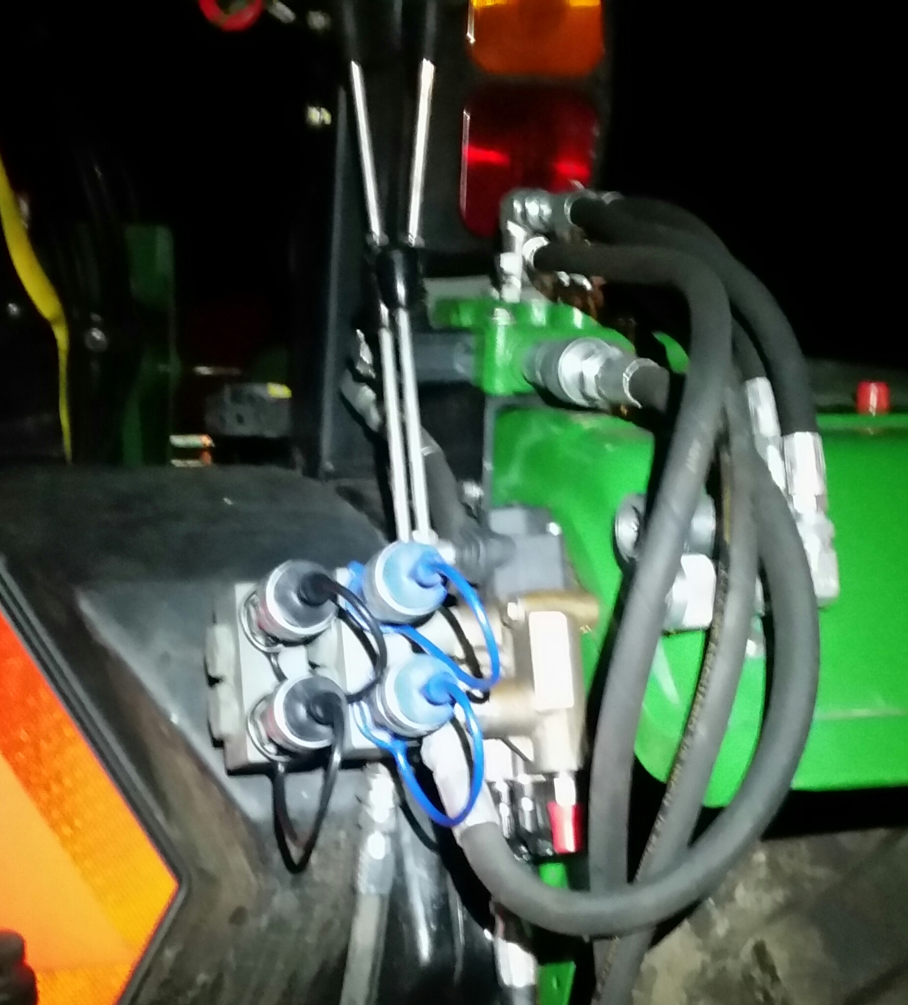

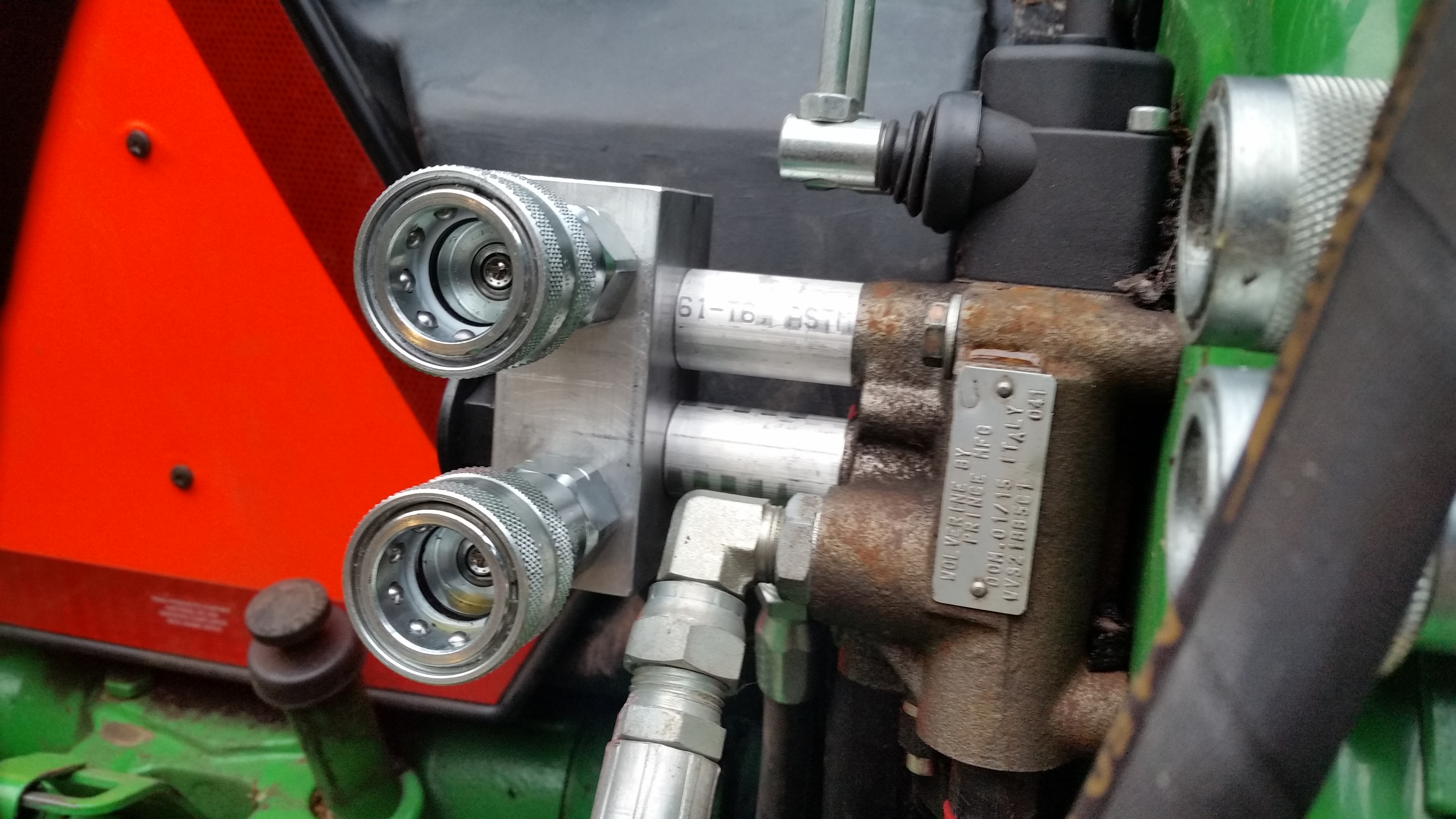

I've got 3 empty SCV's out back when the snowthrower's hooked up.
I have a 2-spool valve dedicated to top & tilt, then I have a 2-spool I use for my stump grinder.
It'd actually be more work hooking up an electric device.
Not the best pic, since it was taken at night:
Had to make some 90ー blocks and custom banjo bolts to give the QD's room to work.
