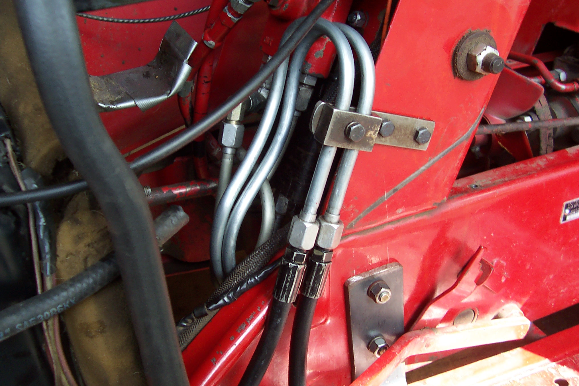

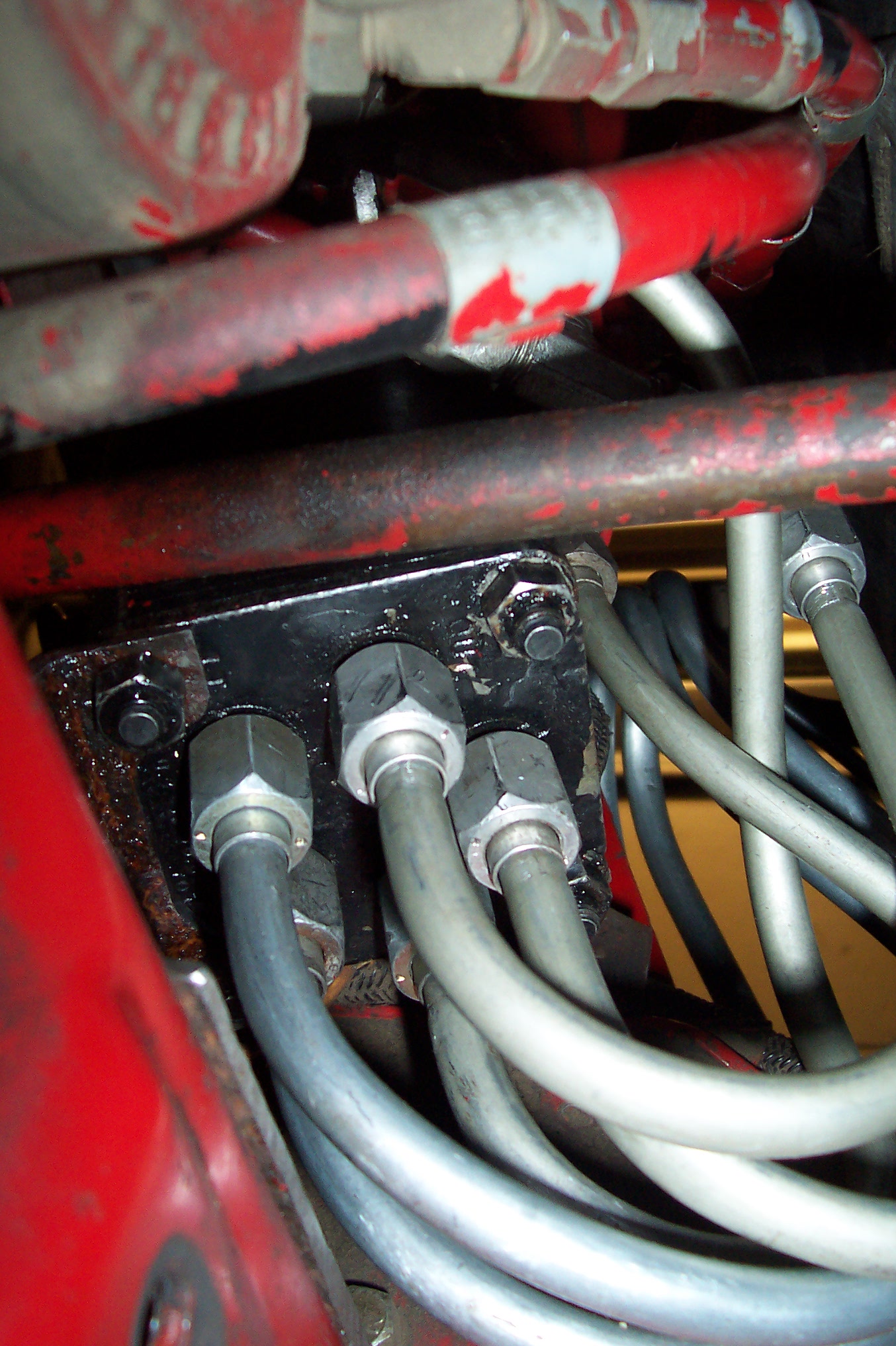

Bending tubing:
This is what I got using my hands bending around a ball bat.
It is 3/8" Hyd./Fuel/Brake line from auto parts.
CAUTION:
Do not lend your bender out when you can't remember to who it went :eek:
