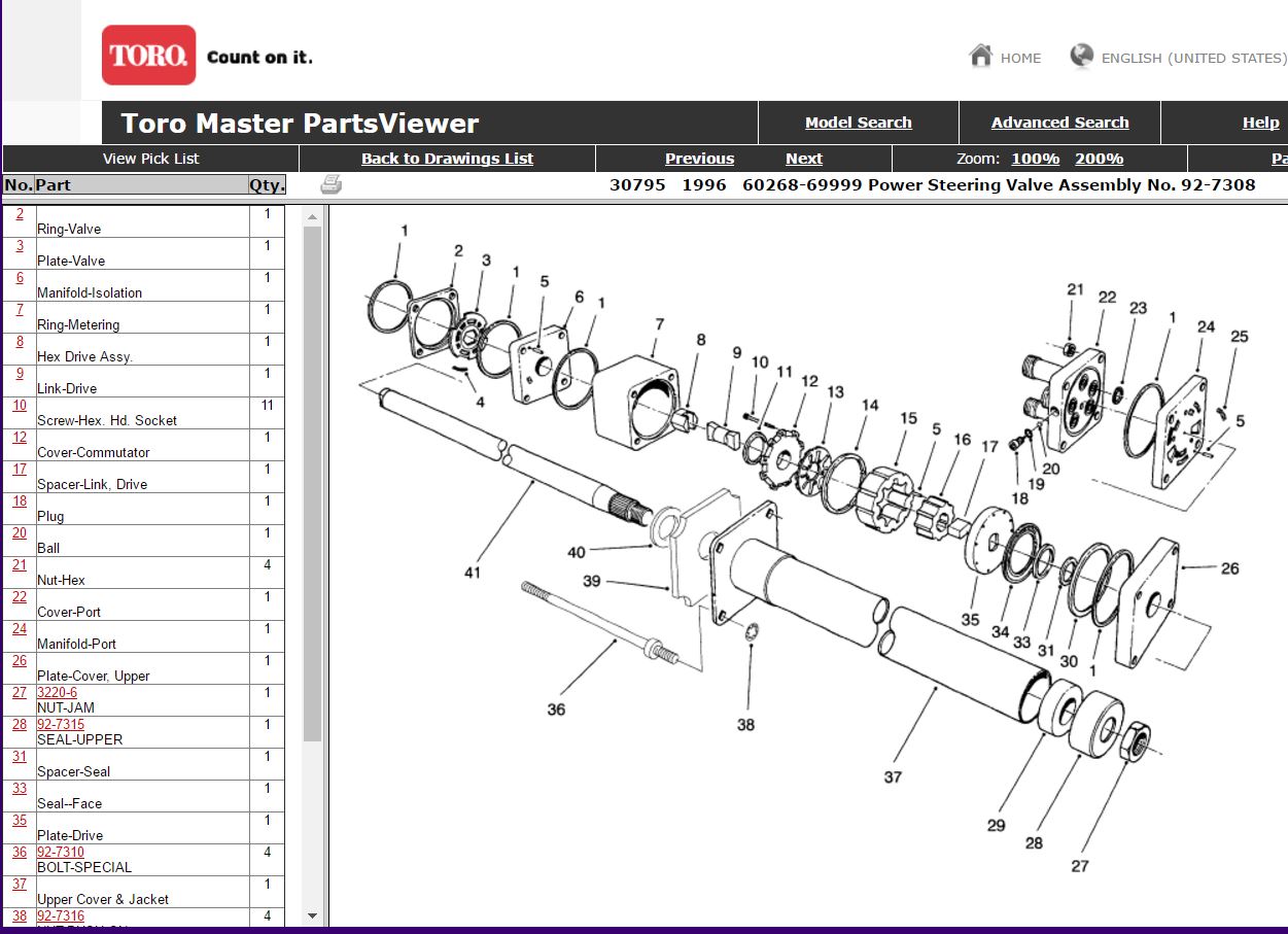

With no fluid moving and no fluid pressure, it can't push the cylinders in or out to steer. How is it your 'pieces' work without a direct linkage or hydraulic pressure?
I don't know what the system is called, but the steering valve turned by the steering wheel acts as a pump to move the steering cylinder, if the engine isn't running. It is slow, but it will move lock to lock.

It's called a hydraulic steering valve HSV or sometimes is called an orbital valve that is used in almost any kind of hydrostatic steering system. It's just a valve that meters and directs pressure from the hydraulic pump to the steering cylinder in relation to where the steering wheel is pointing. It can generate no pressure on it's own.
Although this link is on a rock crawling board, it is descriptive of the valve and the role it plays in a hydraulic steering system. All hydraulic steering systems work pretty much the same whether they are in a small tractor to those huge dump trucks used in open pit mines. Pirate4x4.Com - Extreme Four Wheel Drive

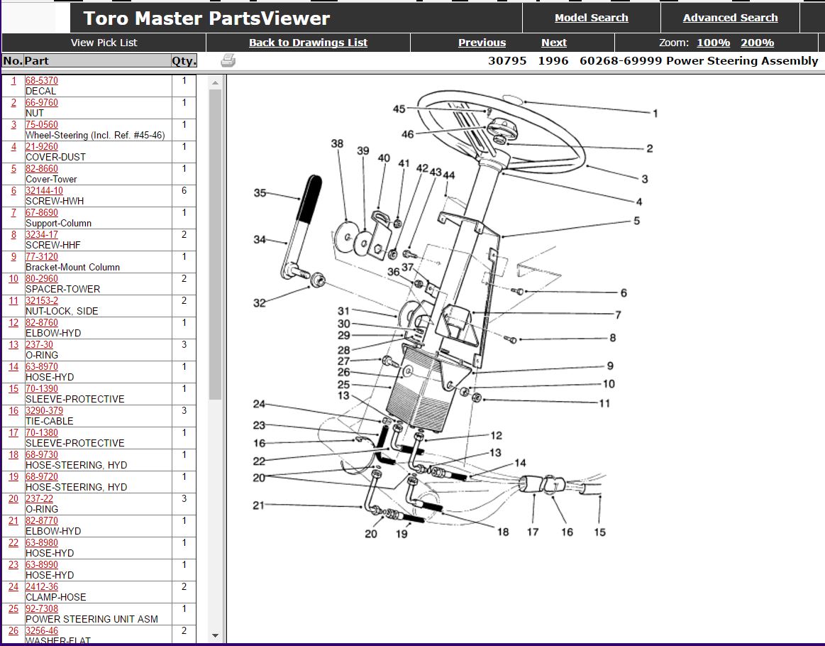

Since there is no standard hardware connection between the front wheels and the steering shaft, only a couple of hydraulic cylinders, if one is unable to start the engine and needed to pull it somewhere, how would you steer it?
You will have a limited amount of steering till the circuit is pumped dry by the steering valve(geroter type pump/valve} The wheel will be hard to turn. when the circuit is empty and the wheel turns easy just crank the engine to refill the system.:confused3:
