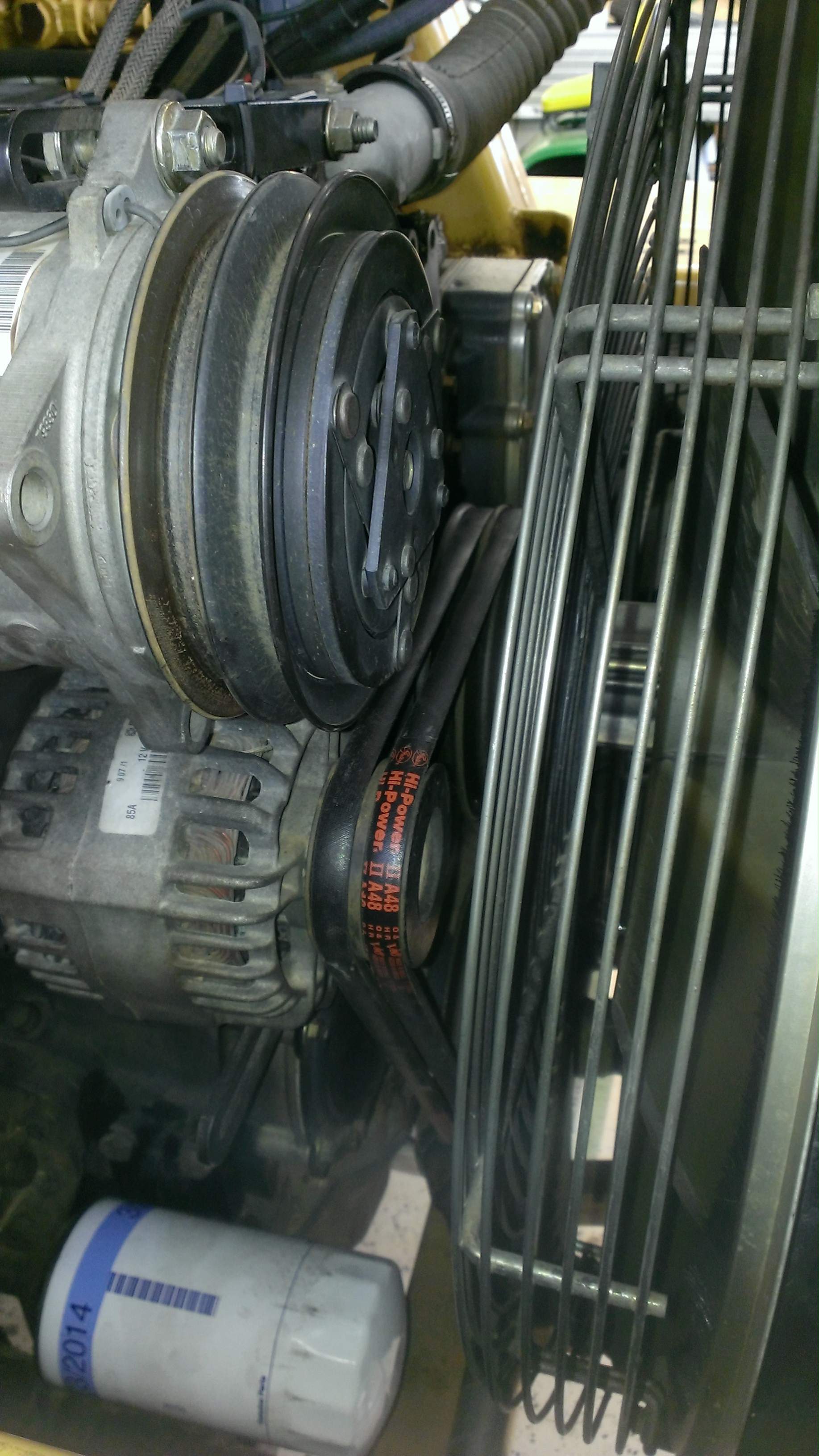

Overheating is a chronic problem for me. Over 80 degrees outside the water or hydraulics will overheat in an hour. Tried cleaning & flushing without noticeable change. I stopped fixing the ASV AC system because of chronic failures in addition to taking noticeable horsepower from the mulcher. This allowed putting a double belt on the fan and alternator which helped more than anything else. In northeast, I really don't need AC. Seems like the fan belt slips when things get hot.
I'm thinking about adding electric fans to the radiator as next step.
