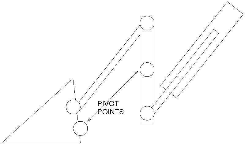

Ever wonder why our loaders seem more powerful on the curl up than the dump down? I always thought the linkage on payloaders was for torque amplification. I never could figure out why they had all that linkage instead of just putting the hydraulic cylinder directly to the bucket. Well, if they did, it would have more power down than up. Look at the attachment.

Great post, MR. This hadn't occurred to me, but you're absolutely correct.
