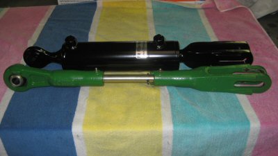

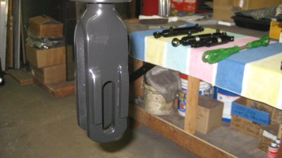

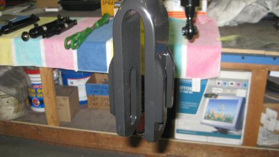

I take exception to that statement. :laughing: Here are some pics of the clevis on a side link for an 8540. Don't know why I don't have a complete picture.:eek: The black unit is for a john Deere 5085, it has more stroke than an OEM unit. Collapses more and extends more. :cool:
