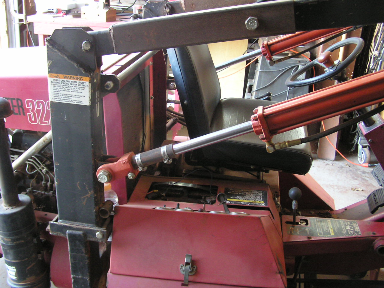

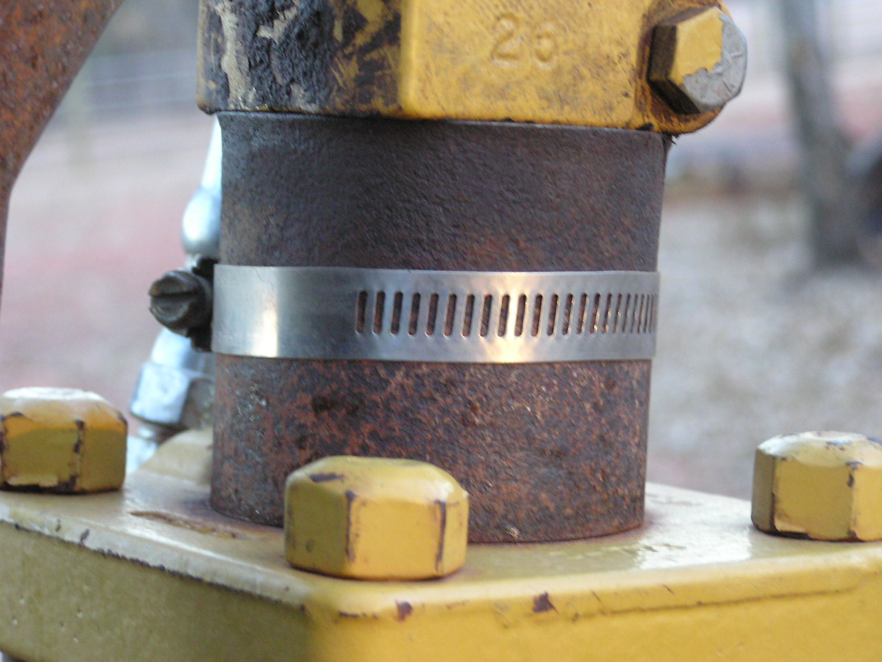

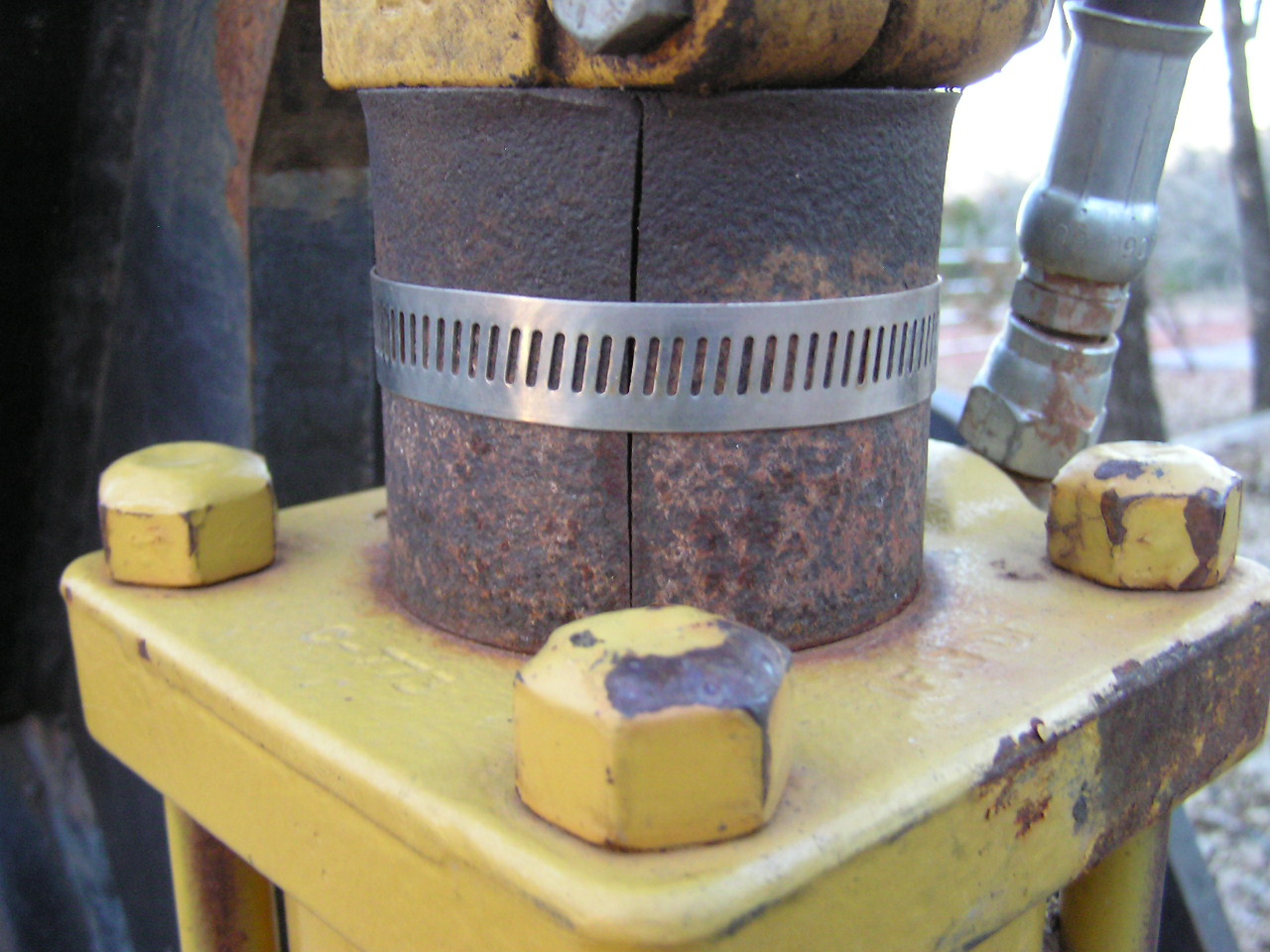

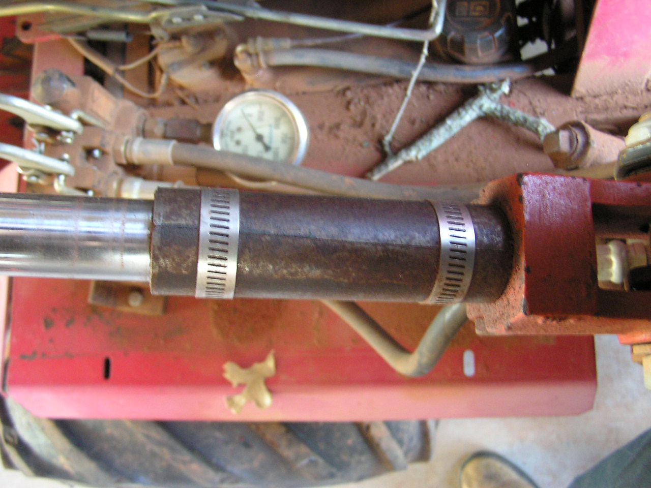

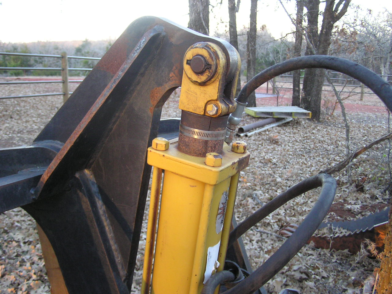

I made mine from thick wall tubing, slit on the bandsaw.
On the Gorrilla Grapple
Works good like stroke stoppers should.:thumbsup:
