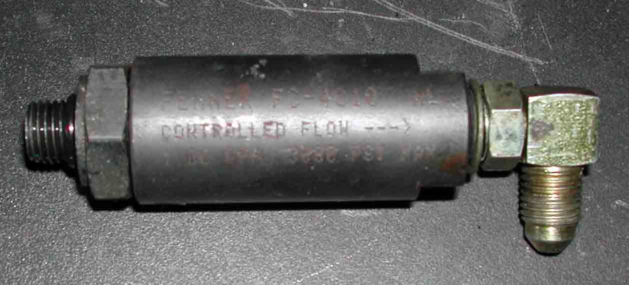

...working in the utility field all aerial units use check valves.
So, when power fails, how do you lower the aerial unit?
This is what Genie uses.
