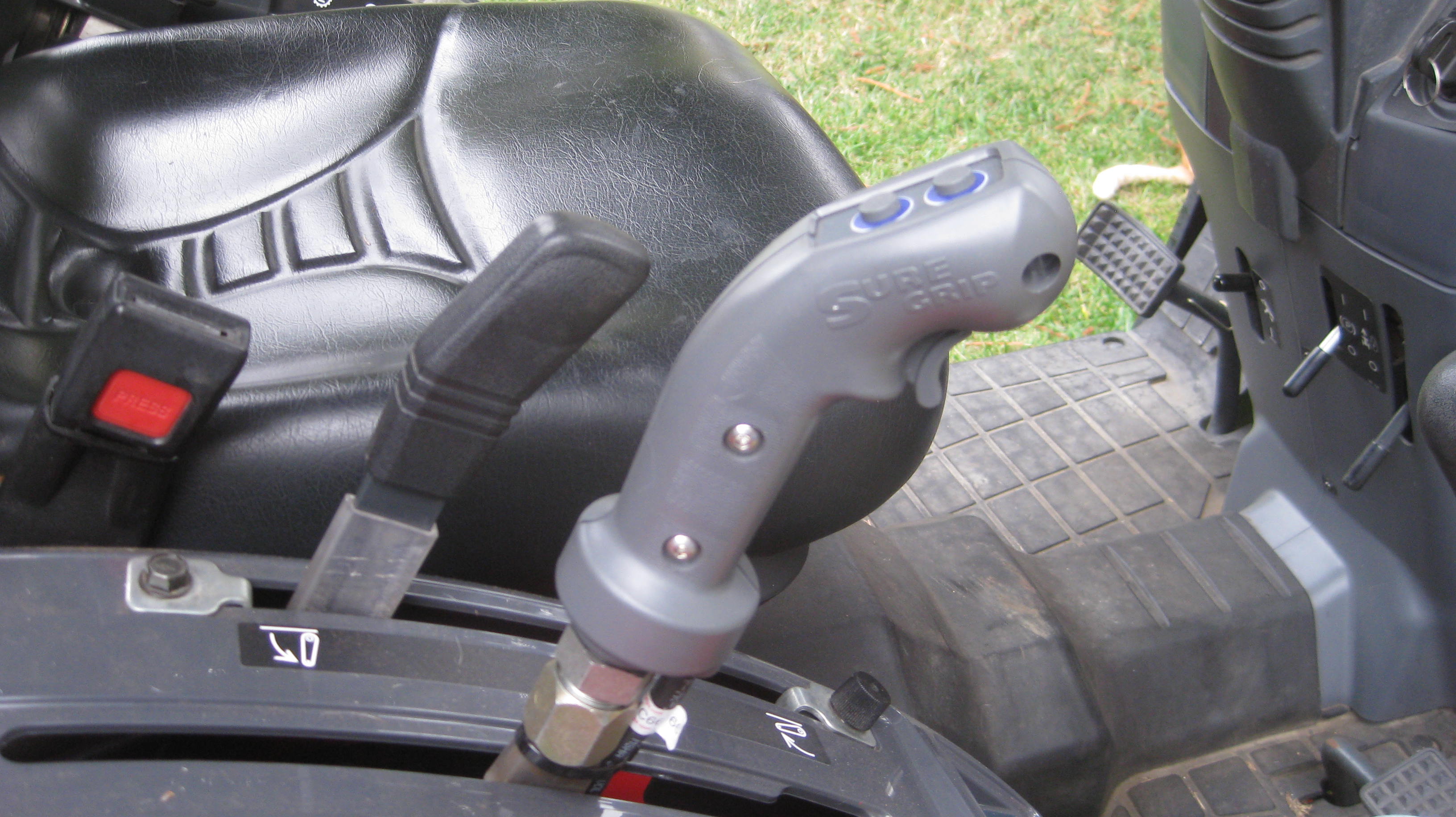

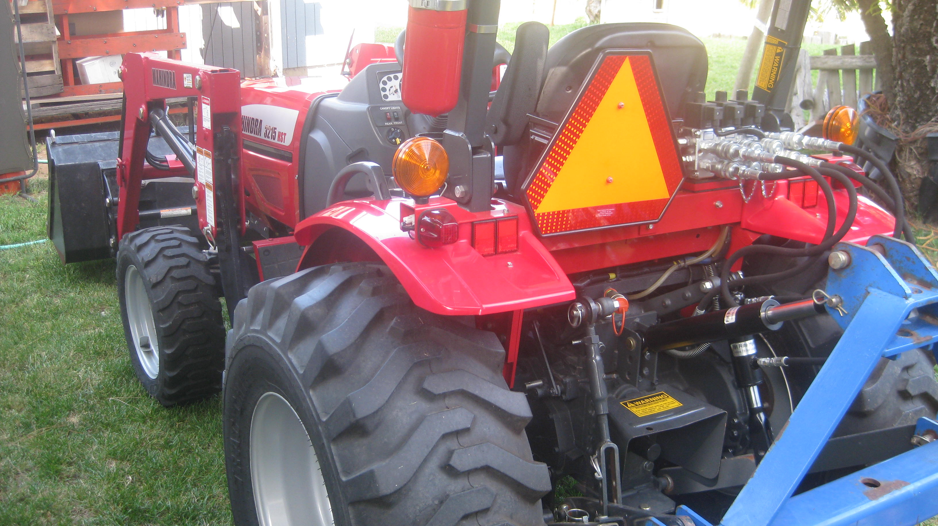

As long as you get a full 3pt quick hitch, the top link remains standard. If you were to go with a Pat's type quick hitch, then you need a 4" longer top link.
As far as a typical hydraulic top link, you need something around a 17 1/2"-23 1/2" working length.
Do yourself a favor and just get the factory Mahindra rear remote set. A lot of $$$$, but really the best option without getting into a full custom system.
If you decide later that you want-need more, then you can add diverters to that set and still have all the controls in a control grip on the factory control lever as pictured. ;)

Lead times are longer than you want to wait, (currently 18 weeks) and I quit doing complete valve systems for various reasons. I really think that your best option is to get the factory rear remote and a top link. Here is an off the shelf unit that is probably the closest that you will find other than mine for what you should have. The valve system is easy to expand from the factory rear remote set using the diverters and can be added at any time. :thumbsup:

If I were in your shoes, that is what I would do. Don't forget to order the hose kit that goes with that top link.
One other note, and only because it HAS been a problem with some of the dealer valve installations. The valve lever should spring back to the center, as in let go of the lever and the lever goes back to neutral (closed) by itself. If the kit is not installed properly, the lever has to be manually moved to any and all locations and that IS NOT how it should work when installed properly.
