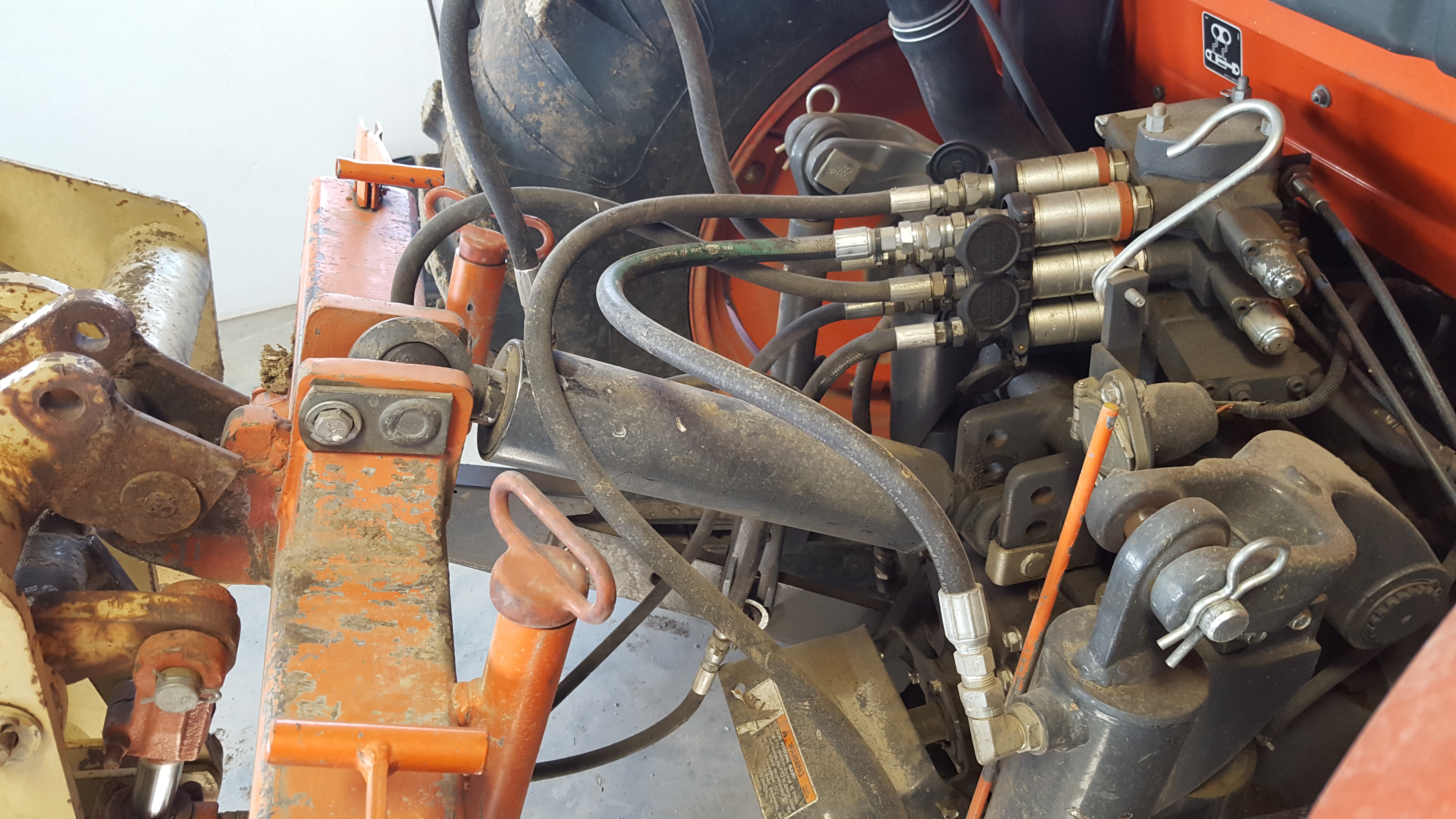

Anyone install a HTL on the M9540?
If so what size did you install?
Have a 1 inch pin Cat 2

All Kubota M series tractors less than 100HP have 3/4" pins at the tractor end and 1" pins at the implement end. I post this so that others as well as you know what to look for. Easy enough fix for you when looking, just get a reducer bushing. ;)

Thanks will do
Should mention I'm looking for adjustment length. You mentioned in other post of 23.25 to 35.25
Would like to know of actual users what adjustment lengths they have needed?

Take a look at this link. This works for about any implement really.
Your front-back level point adjustment should be right around 29" if I remember correctly. So you will have 5"-6" of adjustment in either direction. ;)

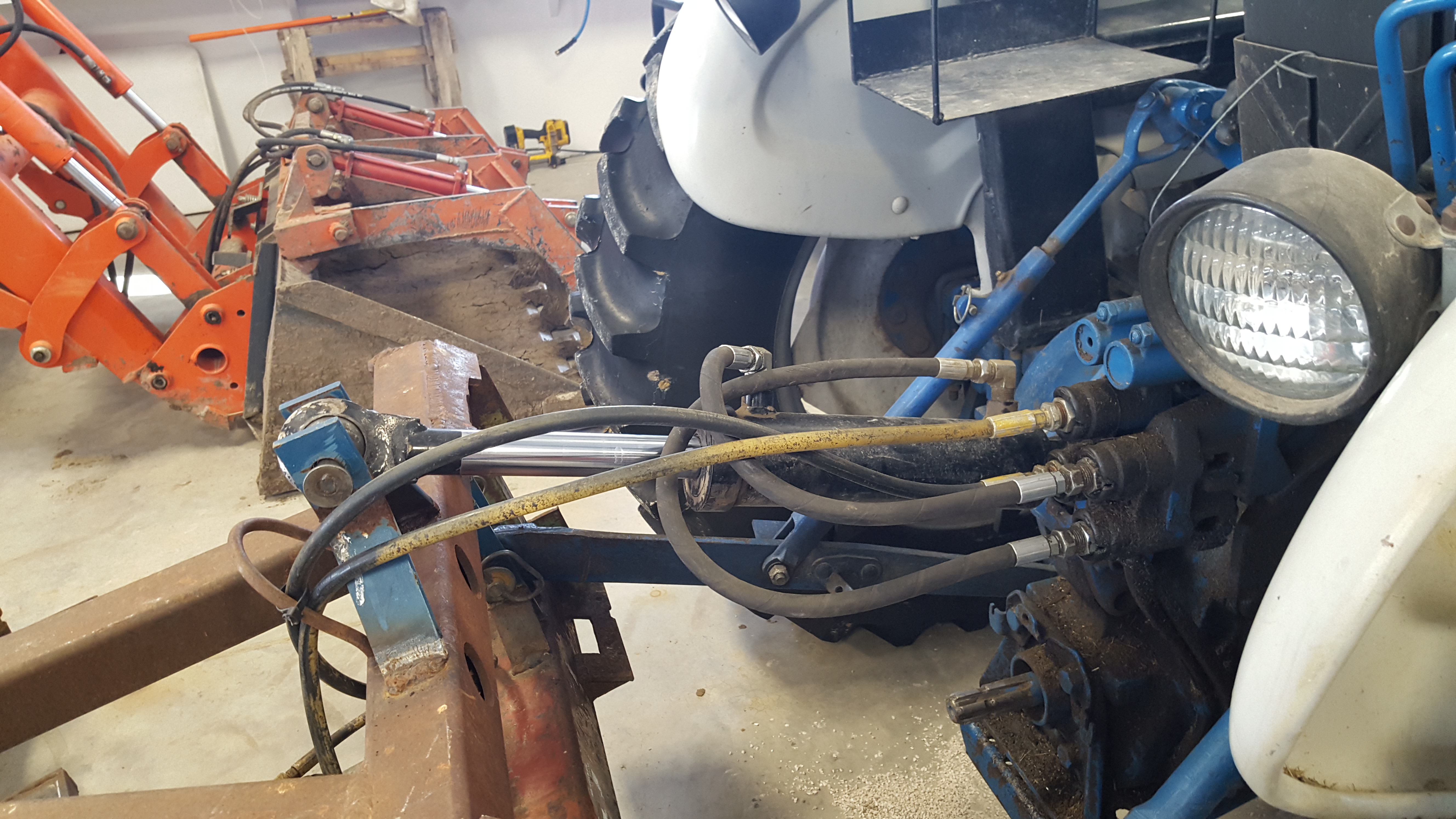

My 2 cents is "the bigger the better" on the link. Get as much in/out range and diameter as you can get that is still compatible with the tractor and implements. Especially on that size tractor an Hyd Top Link will take a serious beating. In my case I use one on a MF2660 (81 horse) tractor mostly with a 7ft bush hog. Also with box scraper, 7.5 ft flail mower and other things. I find it to be a very good investment and very valuable being able to move things around with the help of the HTL like when hooking up, scooting things too heavy for a person to scoot, etc. I got mine from a dealer who had a combination parts and service guy that was really good about researching things. He sold me an HTL and can't find out what brand or source at the moment. (My tractor is 300 miles away.) Anyway a dealer or someone like that who is close enough to visit, willing to talk and assist, etc. and has supplied them before is very valuable. No idea if your local Kubota dealer fits that description or not.

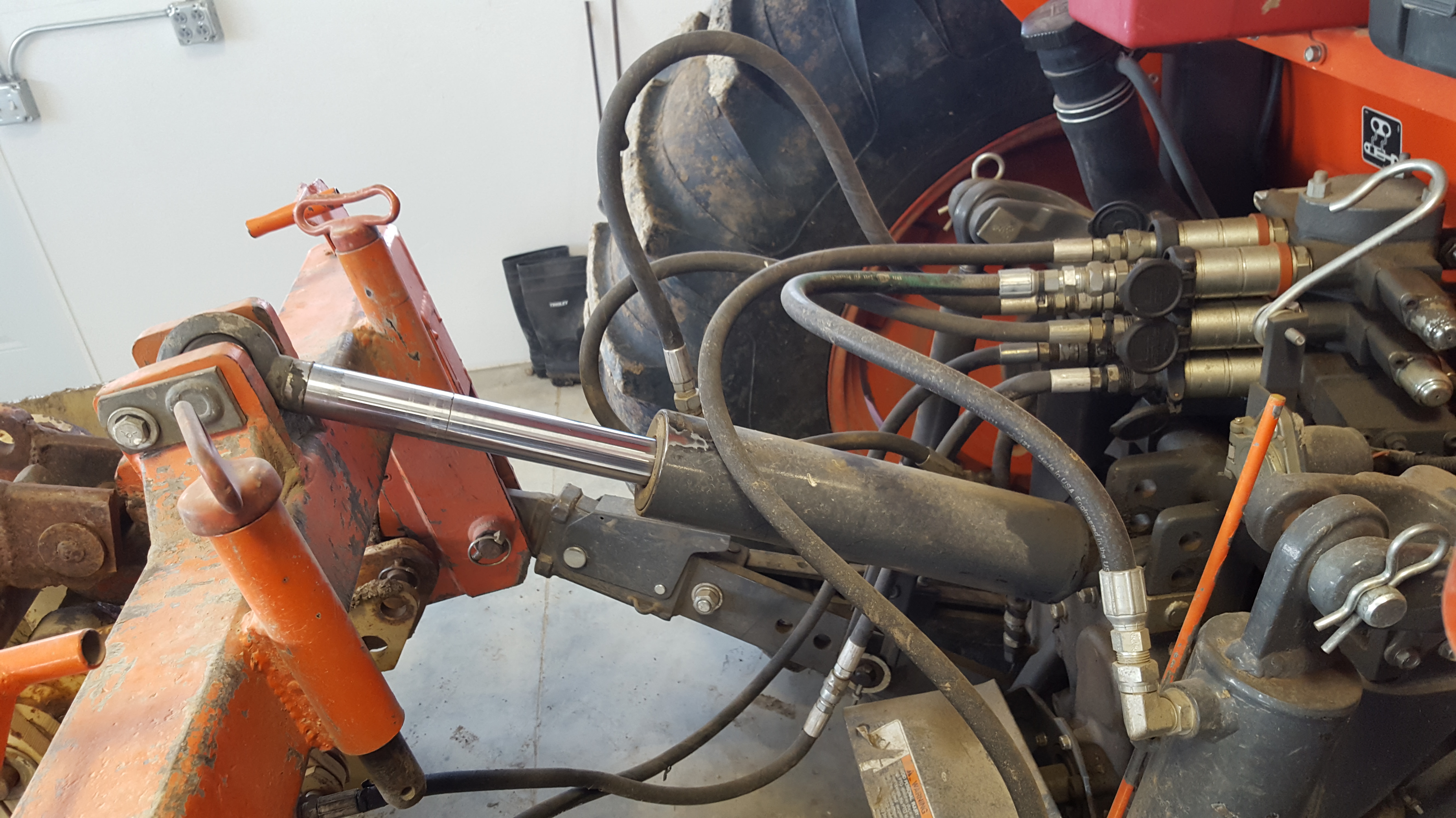

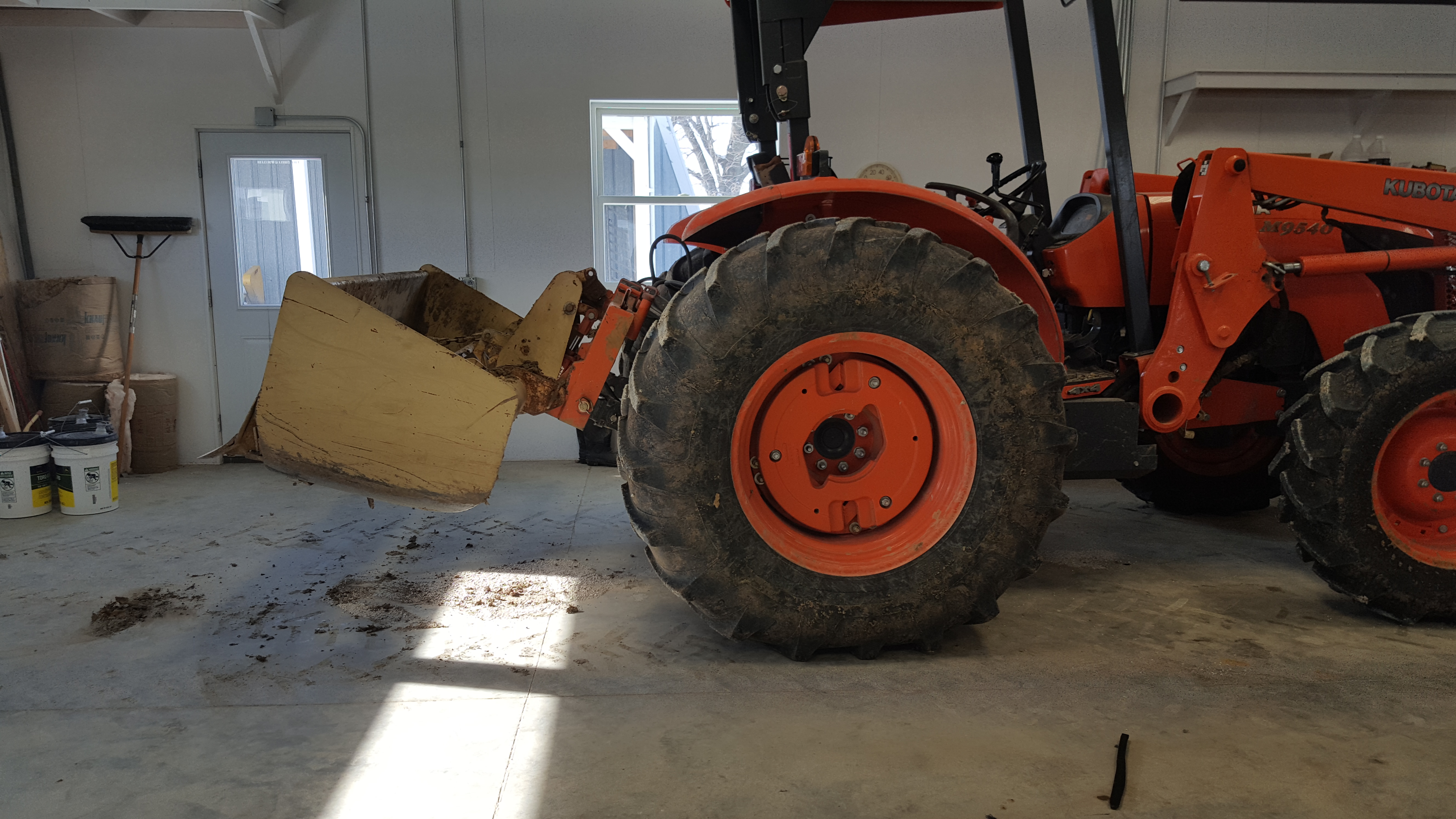

I made mine. Used a 3" diameter cylinder with 1.5" ram. Collapsed length 20". Extended length 30". That's center of pin to center of pin.
I'm very content with the length. I use a QH and never take it off.

I bought this one from Surplus Center. Cat II both ends. 3" cylinder. 1.5" ram. 19.5" collapsed. 27.5" extended.
