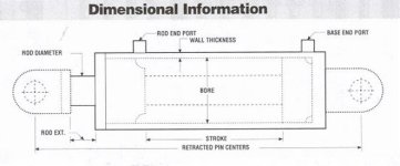

Another question....
Is the bore what the fluid is acting on inside the cylinder?

Derek,
The inside dia. of the cylinder tube is the bore. See the attachment. The outer diameter of the cylinder will be larger.
The Green cylinder certainly has a good purchase price provided the overall dia. along with the compressed and extended dimensions will work for you. Seems to be similar in size to the Prince HTL. Some have spent considerably more for HTL cylinders to get an overall shorter length that more closely matched up to their original toplink's compressed length . +/- an inch or so should work ok.
