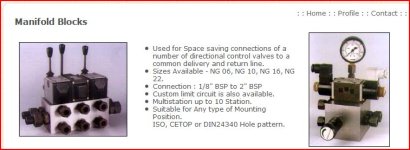

   / Hydraulic valve/spool nomenclature? Hydraulics experts?
Another reference to it being a hole pattern, along with (different?) ISO and CETOP as hole patterns. Boy, wish we had additional hydraulics experts in this thread...
- JC

   / Hydraulic valve/spool nomenclature? Hydraulics experts? #8
Check out this pdf, I've included pages 8&9, references both DIN24340 and A16.
I think the DIN24340 refers to the hole pattern and A16 has to do with the particular "class" of application (plumbing of the ports within the manifold/body)
Does that sound right?

DIN, Deutsche Industrie Normen, 24340, seems to be a standard (German!!) that standardize the shaping and sizing of manifold mounted valves. A16 describes the form or shape (A) and size (16).
So maybe all valves with an "A16" design uses a DIN 24340 std spring on the capped side of the spool....
That's is my "interpretation" of this....
I would try this question at this forum....Hydraulic&Pneumatics....there is a bunch of specialists on hydraulic hardware, especially German Rexroth.....

So it sounds reasonable that valves from different manufacturers should be able to stack together, as long as they have the same DIN 24340 A16 designation?
Yes I think so....I think this A16 is a std about a manifold/valve, size and hole pattern....
