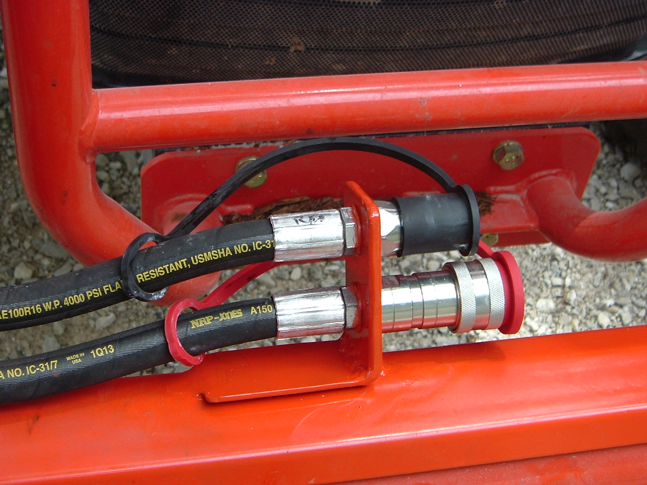

The kubota dump curl circuit surely has regen. On some models it is the furthermost over position on the spool and some it is the first position. I would use my hydraulic circuit that is already sitting there on the torque tube waiting for a hydraulic connection (see below). But if you don't have that, You could use the lift circuit instead of your curl dump circuit and get a simple diverter valve to swap between lift/lower and winch in and out and get away from the whole regeneration thing because I guarantee there is no regen on the lift/lower circuit of your loader valve. here is a simple electric/hydraulic diverter valve that would work fine. You will need the little electrical connector, for it and 3 sets of quick connects. Straight thru left to right side when the coil is not energized, (this would restore you FEL lift function) and left side to face of the valve is the flow path when the coil es energized with 12 volts DC. This would be your new circuit for the winch motor.
