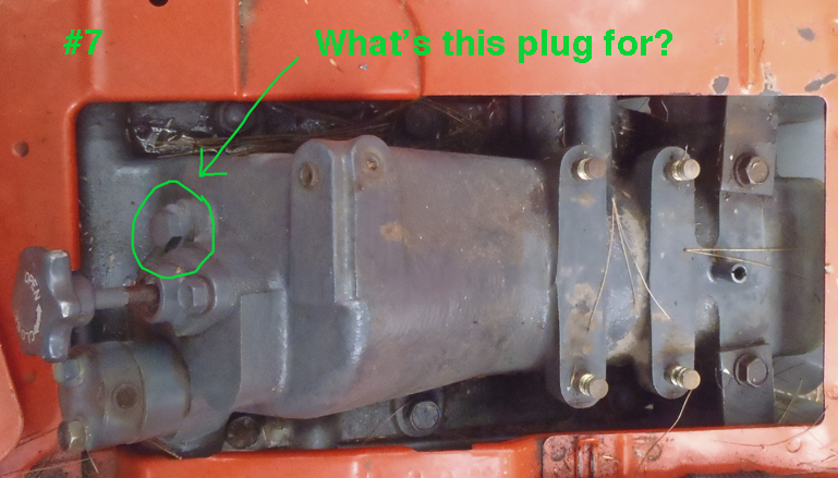

I don't think a relief valve is on the winch and is included in kit to connect winch to a power steering pump. The plan is to attach the winch with quick disconnects mounted on hitch I have to skid trees with on 3ph. Then I can can take it off too attach a rear blade (I don't have one yet) for snow removal on 3ph. Anyone have any idea what the plug is for in #7?

Just found out part #99063-93300 is $276. Is it made out of gold? Leejohn, where does the part connect on #7?

Yes, picture #7 right next to that open & close valve. Did you get your parts manual coming? It's real easy to see then. when you get it go to the aux. control valve and blow it up.
You could look under the round cover with 2 bolts holding it and see if there are 2 holes and 1 oring. The new part well have 2 orings 2 holes in on one and 2 holes out on the other end. The allen head plug it shows is for them to drill the block, I would guess. That block must be kind of thick.
I would not pay $276 for it if you have a way to make it. If you get the parts manual blow it up about to 150% and you can see how it's made. If you can bring your hoses on the left side of knob all you might have to make a plate with the holes going stright thru and just tab one side, and it would not have to be so thick. Then use 90 deg. fitting to hook the hoses to.

Again, thank you all for the info.Yesterday I unscrewed the 2 bolts to the right of the open close valve in photo #7. There are 2 holes coming up through the banjo part of the connection. The cover plate connects the 2 holes together via a passage that is also connected to the allen head plug. I called Messick's yesterday and talked with parts first and Matt told me I needed rear remotes and connected me with sales. The salesman thought I didn't need a set of remotes and back to parts with a quote of $277.83 for part #99063-93300. Talk about being screwed. As I don't have any plans for rear attachments with hydraulic capabilities except for the winch I can't rationalize the expense of remotes. Not sure I can justify $277 for a plate with 2 holes tapped in either just on principal, but sometimes principal is not the bottom line. Mean while the wood is up in the woods and Fall is here and going to need to fire up the wood stove. Maybe back to looking for another place to tap in to hydraulics? or just pay the fiddler so we can get er done? The solution seems so close yet so far because of my shoestring budget!

Like I said before I would not pay that much eather.. Also like I said, if you can run your hoes on the left side that plate is not hard to make. The hardest part would be cutting the face for the orings to set in. You should be able to get it done for 50 to $75.00. If you can get a back facing tool you could to it all yourself. Only one side has to be nice and flat and that could be done with a stone. now your down to about $10.00.
