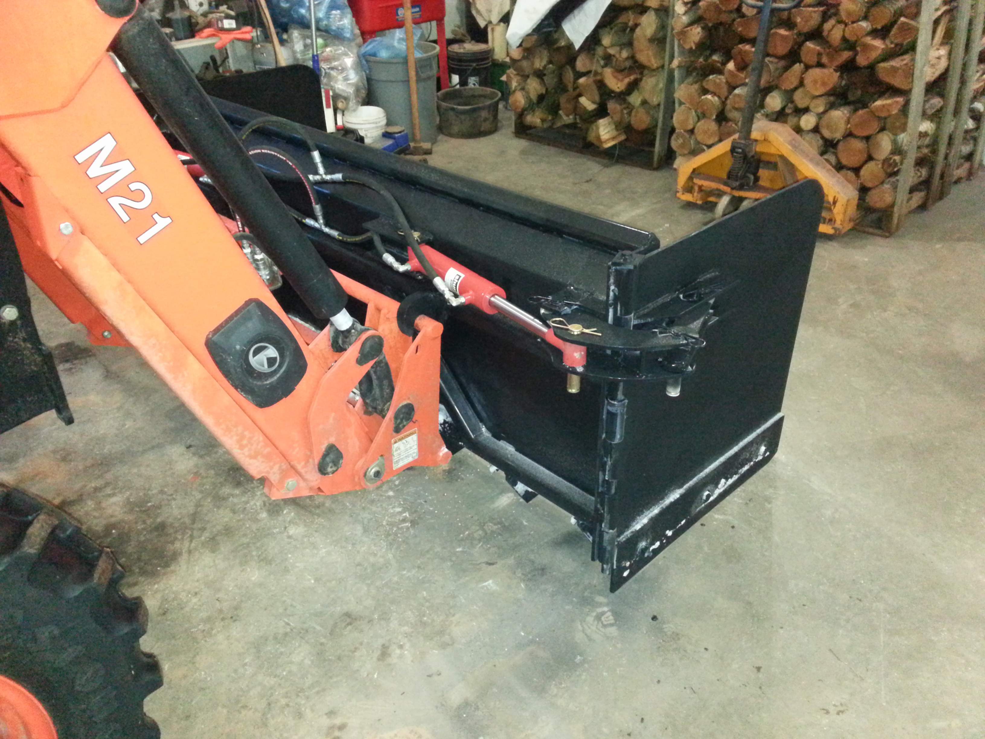

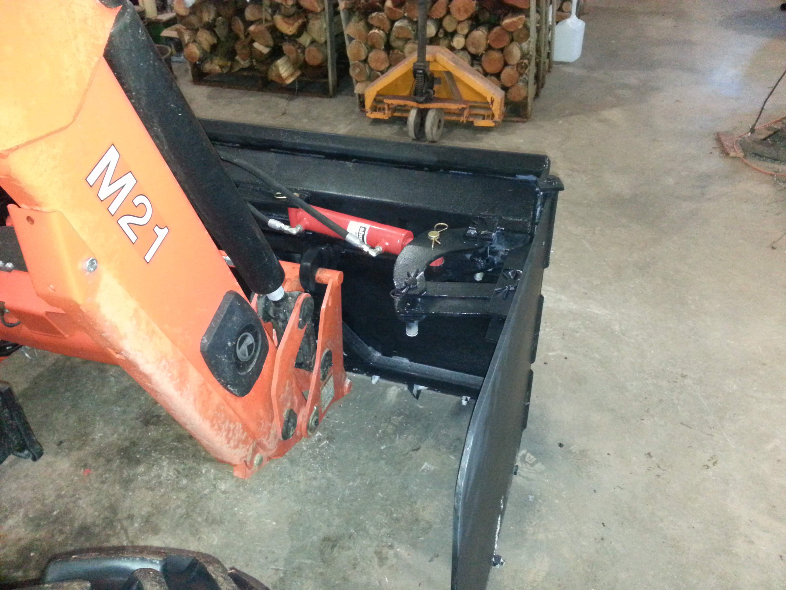

And a picture of the wing folded 180 degrees back.

Lookin good. That wing looks to be 1/2" plate!

3/8" actually. Still way too heavy, I think 1/4" would have been more than sufficient.

She looks good and solid, toxic.:thumbsup:
Ya, maybe 1/4" would have been just as good.
Looking forward to see it mounted.

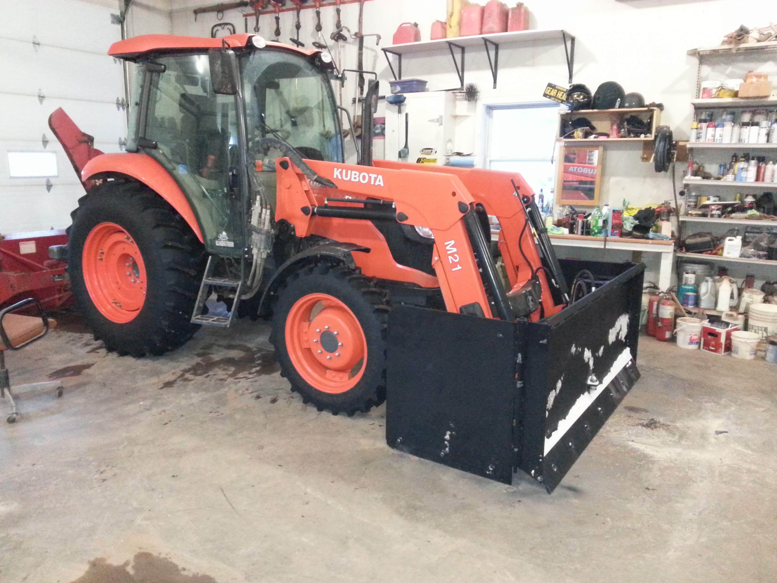

   / hydraulic wing snow pusher
#26

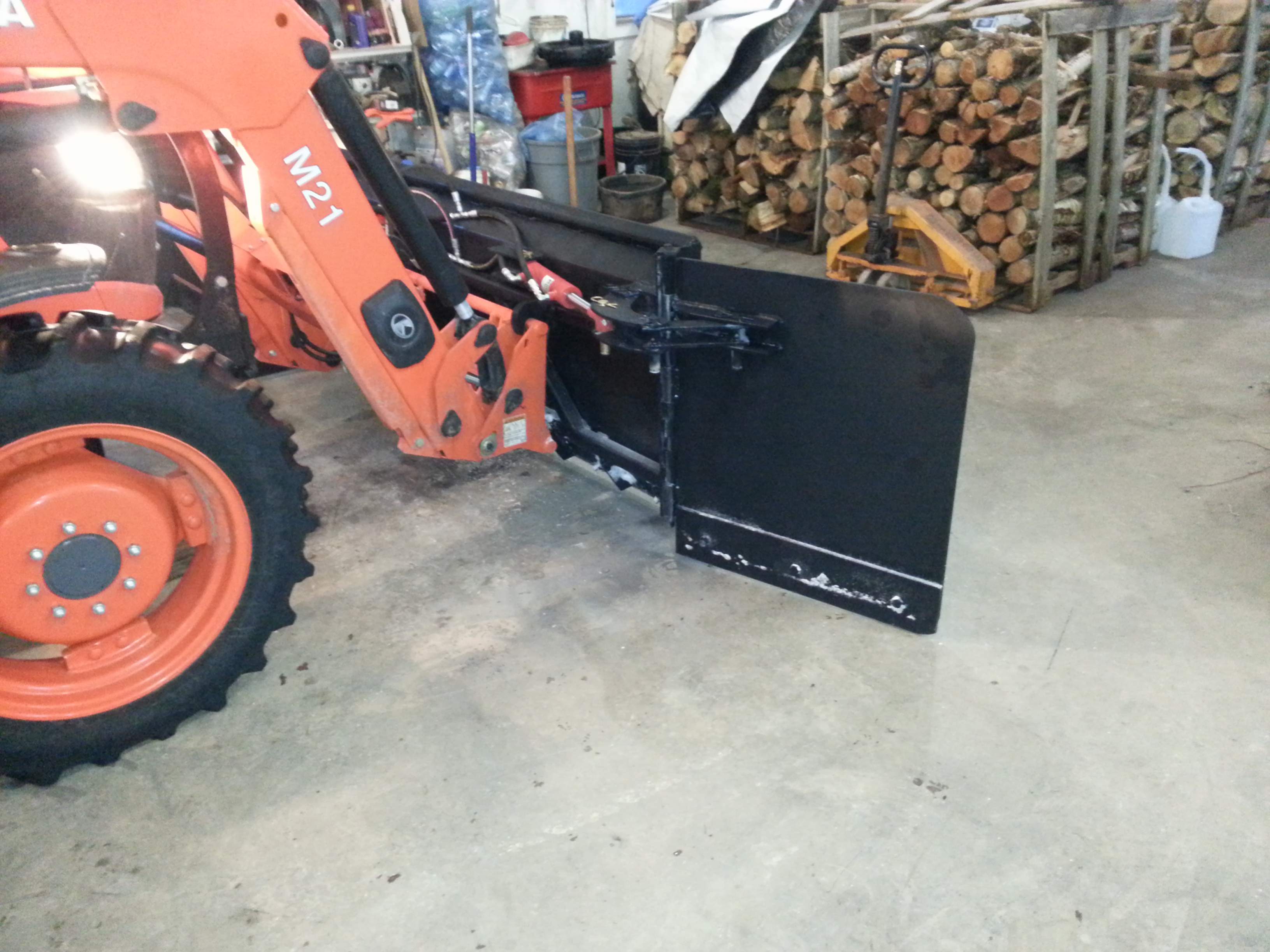

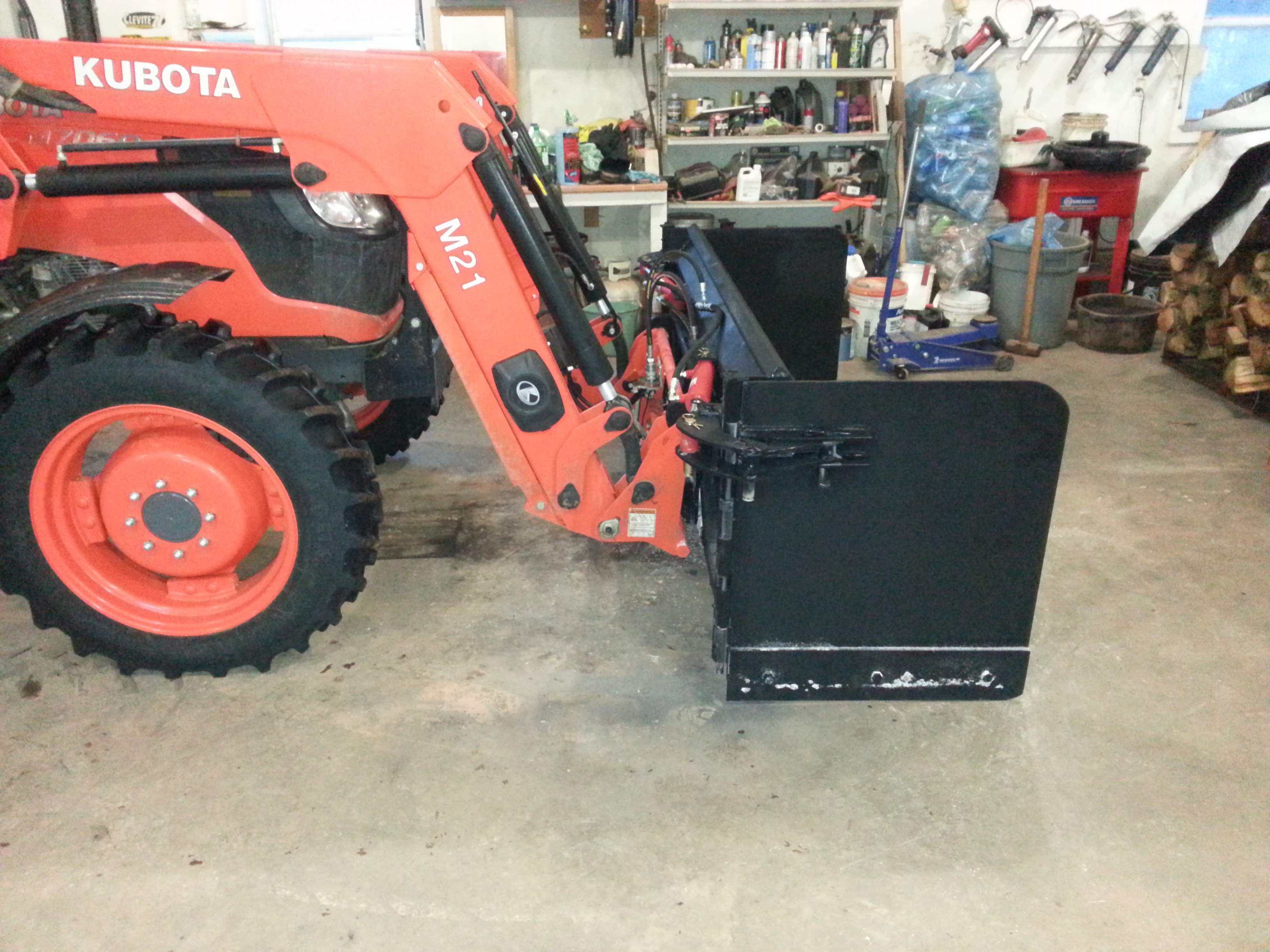

Finally done! Well sort of, done enough that I get to try it out and see what changes need to be made. Just in time too as they're calling for 3 storms this week starting with 12-15" tomorrow. Backdrag position.

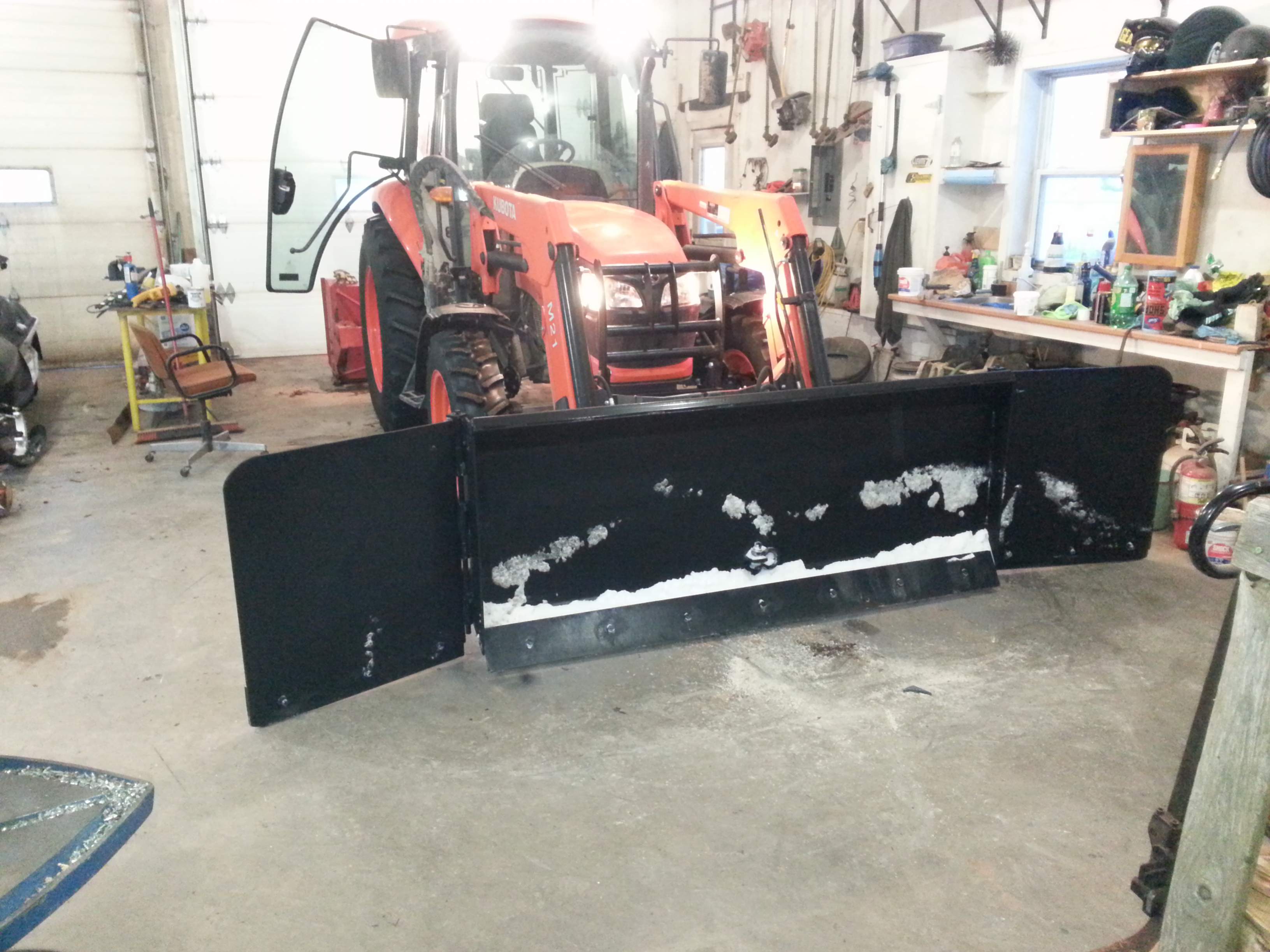

#27
Straight out.

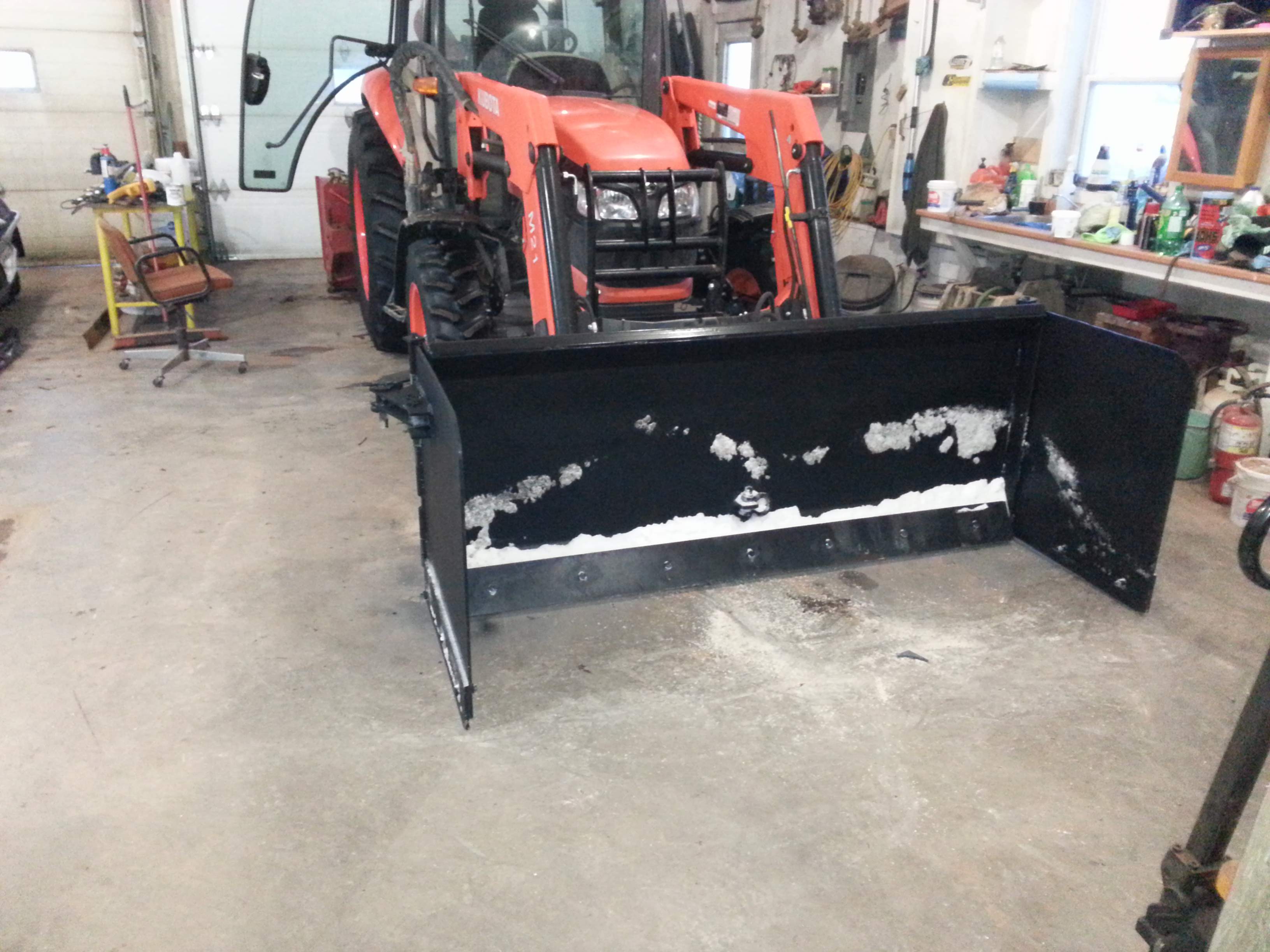

#28
And as a pusher.

   / hydraulic wing snow pusher #29
Looks mean....:thumbsup:
   / hydraulic wing snow pusher #30
It came over very nice! I'm a little apprehensive about no trip at all,I know what you said about the bucket,I would still like a safety so god forbid it doesn't trash your plow or tractor,and slam you in the steering wheel..
