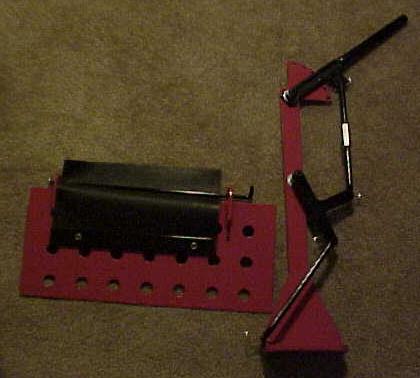

Thanks Alta. Those are a couyple of intersting options. BTW the York site is www.yorksheet.com. I couldn't get a clear picture of the mechansim that controls the deflector. Could you post a couple of pictures of yours? /forums/images/graemlins/laugh.gif
   / Hydraulically controlled mower deck deflector? #7
Heres mine, if I can get the pic to load..

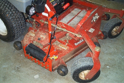

   / Hydraulically controlled mower deck deflector? #8
And another....
Mine isn't the york sheet metal director, though. Its a copy, which isn't set up as well. I wish I'd went with the York. /forums/images/graemlins/frown.gif

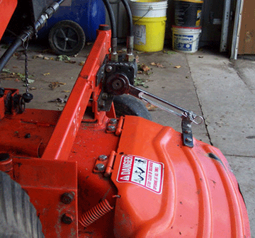

After considerable thought, I realized that trying to use a hydraulic cylinder wasn't going to work, but a hydraulic motor would. So after some more thought, here is what I came up with. This is a view from the rear with the deflector in the down position.
