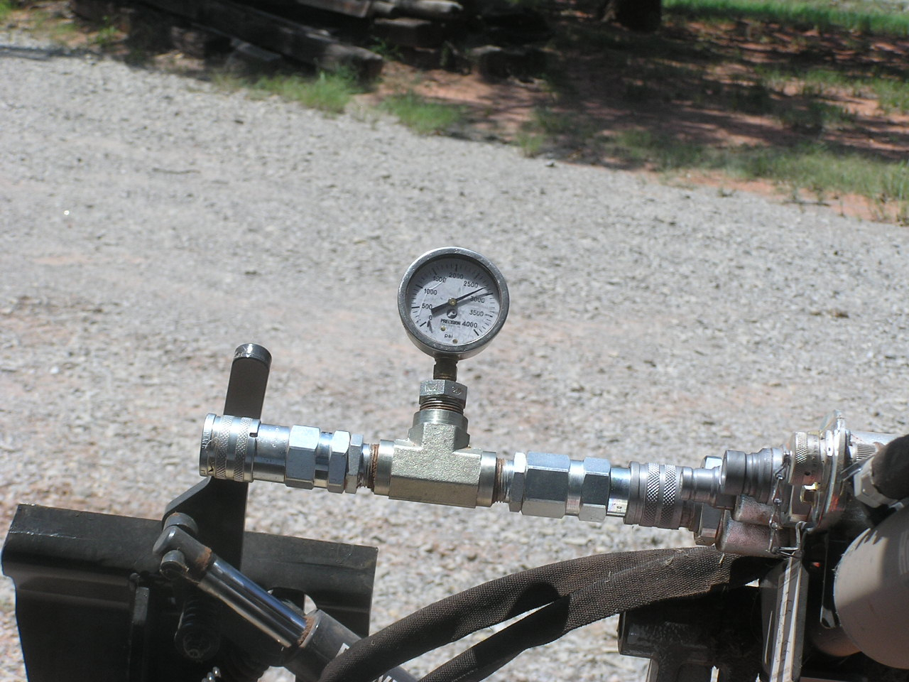

Since I last posted to this thread, I have installed and tested the hoses to all the cylinders. There were a few leaks which I have taken care of. One of the potential problems I was concerned about was whether the hydraulic pump would still be functional as it was a salvage item from an old bale loader. As it turns out that pump is more than I need for this machine. It delivers a volume in excess of the amount required and as a result I'm not able to easily control the movements of any of the cylinders. I'm running the engine as slowly as I can without stalling it when I move a valve. I already slowed the pump as much as I can without adding another set of pulleys and a belt. I would have to do all of that underneath the tractor - not a pleasant prospect! I have looked for restrictor fittings but have come up blank. There must be a source for them because I have seen some. I'm open to ideas here....

You can make restrictor fittings by welding/brazing them shut then drilling a smaller hole in center. You only need one in each circuit to slow the fluid.
I would only do this on the individual circuit lines though. If on the main supply or return lines then the constant flow may cause fluid to heat.
Your valves/controls really should match your pump in flow per minute also.
Example
A 10 gpm(gallon per minute) pump .
With a valve that flows 10 gpm the halfway open flows 5gpm in theory.
But a valve rated at 20 gpm halfway open will flow 10gpm .harder to make delicate adjustments as each bit of handle movement makes a larger adjustment in the flow volume.
And a valve rated at 5 gpm (too small) though slower at halfway (2.5 gpm) is restricting the constant flow causing heat from friction AND the pump to be working harder constantly just
to move the fluid in the system.
Slowing the pump though slowing the flow also lowers the pressure produced.

Thank you to lennyzx11 and ptsg for your helpful advice!! I was considering the flow control valve concept and I also realized it would never do to restrict the flow of the pump without a release provision as lennzx11 cautioned me. As for mating the flow rates and valve capacities, I'll have to work with what I have as best I can for now. The idea of fashioning restrictors is the solution I'll try first if my search for suppliers continues to hit the wall. I have some galvanized street elbows to practice on as I'm taking seriously the warning to not use those for hydraulics. If I succeed in modifying them, I'll go on and make up a batch of restrictors for the seven cylinders that need slowing down. The ones I practice on can be drilled back out and used as normally.

I've revisited the possibility of slowing the pump some more and I think it can be done. I've posed the same issues on my build site (see post#12) as I have done here and it was suggested I use a similar setup to the one I slowed down one of my drillpresses. I'll give that a try as well as the restrictors. I've done a couple to see how brazing works and I think it will work. I'm starting with 1/16" openings as that is what I see on some fittings I have but are the wrong size. I can drill them bigger if need be.

You can also use a Pressure Compensated Flow Control valve and adjust the flow to your needs and dump the excess to tank. Or just get a smaller pump now that you have an idea how the system works.
Link to an example of a flow control valve: https://www.princessauto.com/en/pre...w-controls/product/PA1000000773?skuId=8252785
I have isolated the difficulties I'm having with the hydraulics and it is that the pump is delivering a much higher GPM than I need and when I try to dig, the engine stalls. It's an 18 HP Briggs and Stratton and it should be more than enough engine for the task. I picked up a flow control valve much like the one you suggested but by the time I add in the hose and fittings I'll need for it, I can almost buy a new pump that matches the job. Does "pressure compensated" mean that the pump will continue to deliver the same pressure to the cylinders while dumping excess volume of fluid back to the tank?
