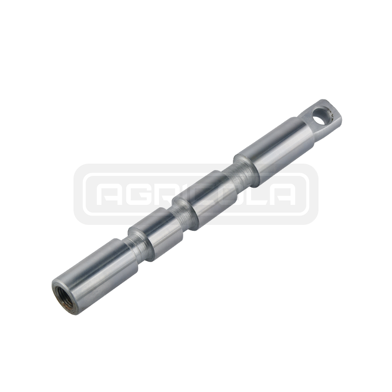

The photo is old and at that moment i missed a fitting. Now the 3 lines are connected to the valve. I do have a spécial fitting for the Carry over, which i bought with the valve. The cylinders which go up and down are single acting. The "thing" in the valve was changed for a simple acting one.
It is the one on the valve. It has a little orange cap on the photo.

Sorry but as I see it the "thing" in the valve with an orange cap is a relief valve adjustment. It has nothing to do with single acting cylinders. If the valve is now plumbed as your diagram shows, and the supply line from the pump goes to the loader valve first, with nothing between the pump and the valve, then the problem has to be either the valve or the pump. I think you need to revisit the valve and that work port with the plug in it.

To convert it from double to single acting, I changed that
