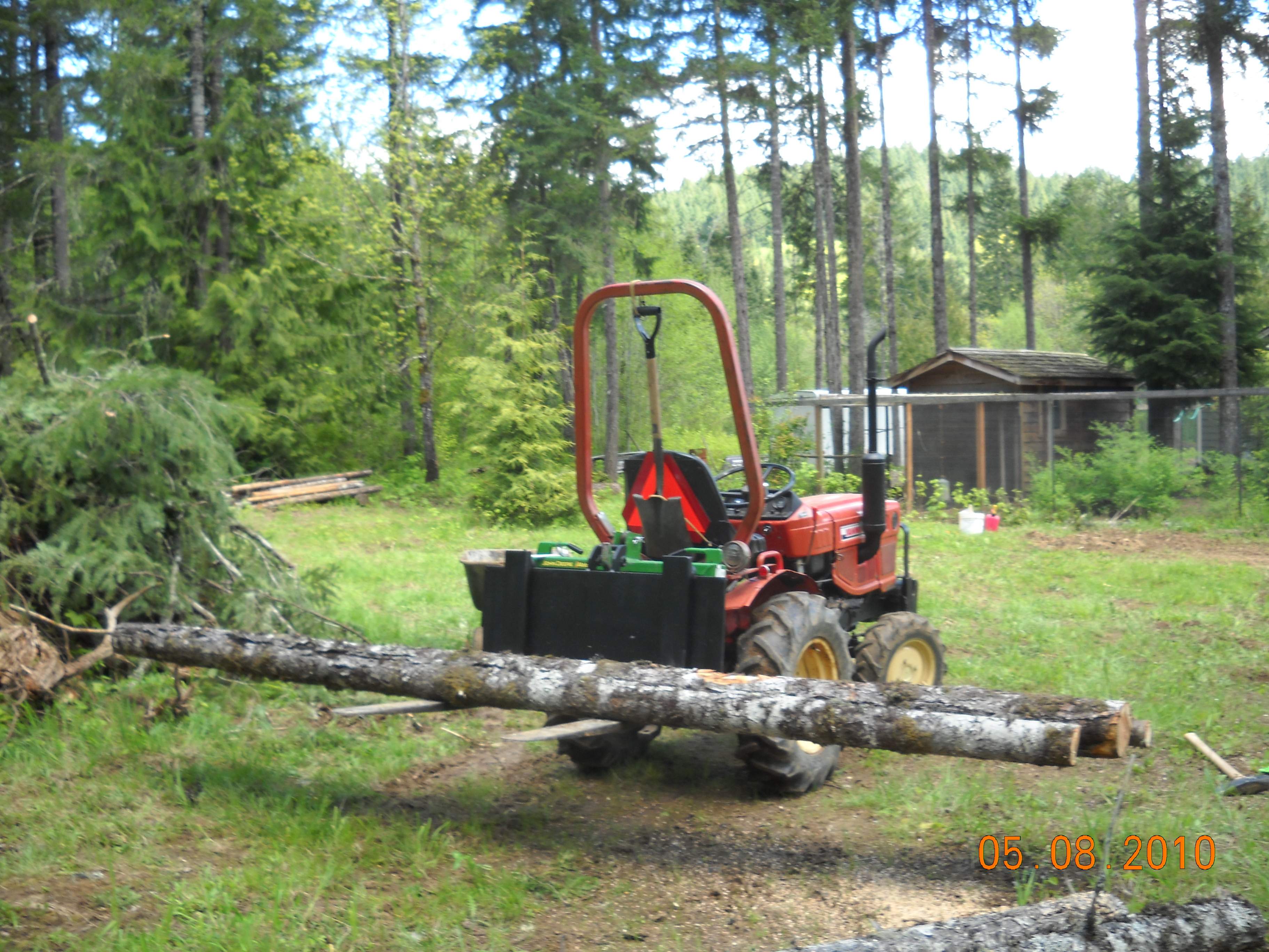

That sure would be nice when Im using my forks and boxblade. I hate it when I have to get off and extend my toplink to get a log off my forks as it is time consuming. One of my tractors doesnt have a top link (yet) so I am now considering your hyraulink since i wouldnt have to run hydraulic hoses or buy a pump.
