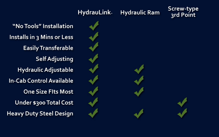

What ever features that you think the HydrauLink may have vs a std hydraulic top link, :confused3: in no way does it have all the benefits of having a true hydraulic top link.
You might look to some of my previous posts regarding the added benefits but the best place to look is our website. HydrauLink (HL) does things that no other top link will do... even the standard htl. And although HL does adjust differently, it can be adjusted up or down without leaving the cab. We understand that you may have applications that a standard htl works best for. But HL is second to none when it comes to delivering quality work, easy adjustments and super easy installation.
