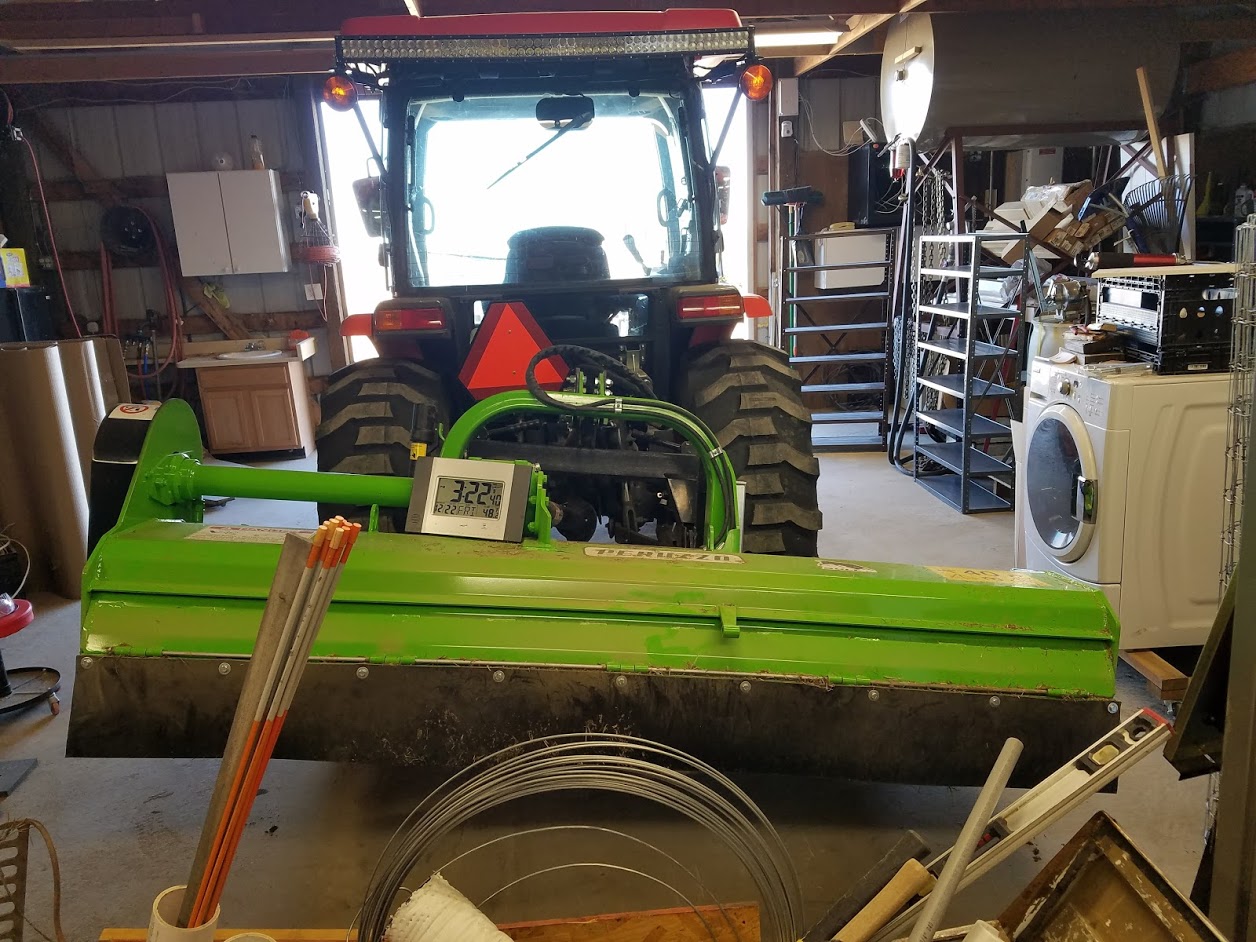

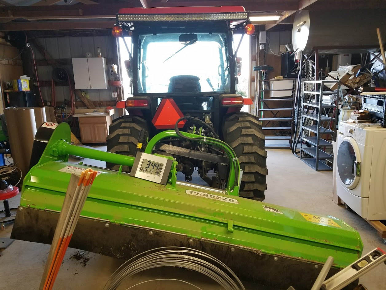

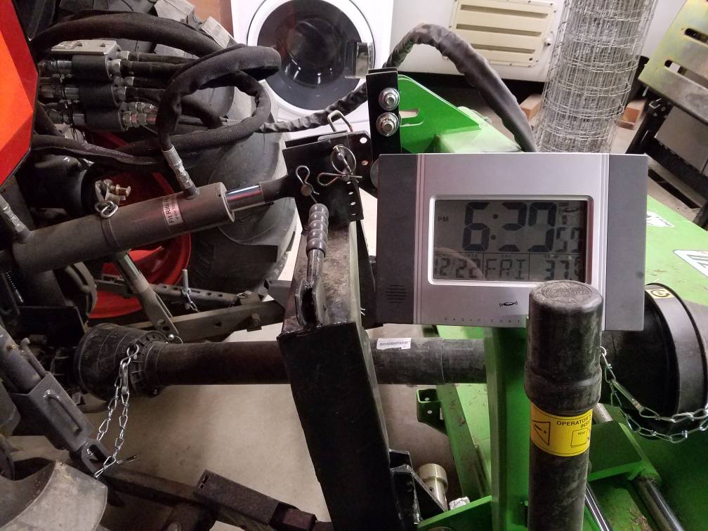

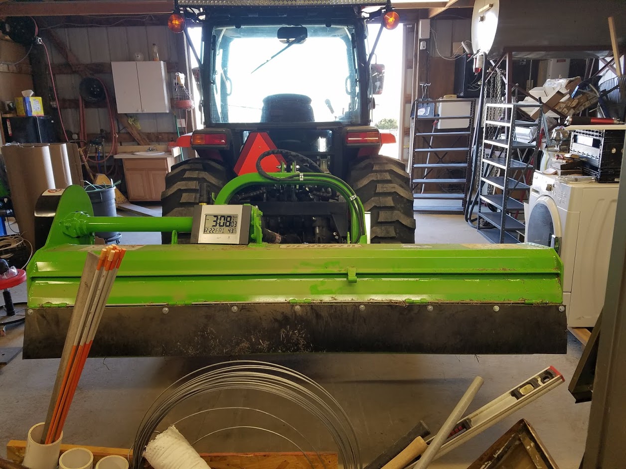

My sidelink extends completely in about an hour or less with a load on the 3pt. The toplink extends at about an inch an hour or so. And this is after the dealer worked on things. The toplink is a fair bit better, although not perfect, the sidelink got a lot worse. The loader will hold position for weeks on end if I leave it up. So it's only the rear remotest that have a leakdown problem. If I unplug the TnT hoses, there are no leakdown problems, so it's the valves, not the nice Fit-Rite cylinders. The TnT crap cylinders that the dealer originally sent (and replaced twice) didn't have any leakdown issues either, except for the couple that spewed fluid out externally. None of the ones from the dealer fit properly at all. I don't view check valves as a viable option. I ordered the machine with 2 float valves & like the functionality of float on my TnT. But check valves by there very nature prevent float.
I'm gonna send the machine back to the dealer again later this week as I'm traveling next week. Hopefully they get some decent valves in there.
You can see the clock sitting on there for reference on how fast it drops.

It's beefy as ****. I had to taper the ends of the clevis tabs for the 3pt to get my quick hitch to fit. The quick hitch compatibility kit doesn't quite work right. I still have to move the hook up from the quick hitch standard height. Annoying, but not the end of the world. The kit also just to be 2 bars & some bolts. Puts a 2nd toplink bushing several inches below the stock one. Not much for the $100+ they charge for it.
There is no pivot or flex link like on any rotary cutter or flail I've seen, which worries or at least confuses me a little. I have float on my hydraulic toplink & am in the habit of using it, so that takes care of float for me. Update: just looked at a photo & noticed the QH kit bars are covering a slot, so that's probably the stock float solution. Can barely see it behind the clock (was timing how fast the sucky Kubota rear remote valves leak down).
Performance wise I've spent 5-10 minutes running it while there was still some snow on the ground. It seems to cut fine. I should have gotten more HP on the new tractor to run it, or maybe a narrower flail. But I knew I was on the low end of HP when I got it.
Hydraulic offset is nice. Grease points are accessible. Looks like there will be a good handful of bolts to remove to get to the belts for adjustment or replacement.
The shipper had the pallet labeled as 1909lbs. I really couldn't lift it with my loader until I hauled it (really skipped it across the ground) to the shop. Unloaded the PTO shaft & packing material & was able to lift it several feet. Lifts fine on the 3pt though.
Oh, an the obvious color match issues... Should have something that goes with Orange better. ;-p20171222_150735.jpg20171222_182931.jpg
