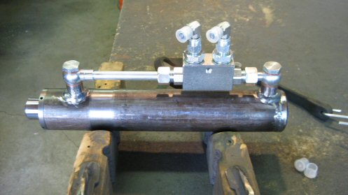

It appears you may need a DPOCV (dual pilot operated check valve) for each cylinder set up. It cured the creep on my top link.
Here is an example of what I am talking about
It definitely fixes the symptoms you care about. But it also breaks float. Relevant to me & some people, but not everyone.

I did not make it, I just pull the picture from some information I had. The reason I added the DPOCV is I had a slight creep down due to and internal tractor valve seep. It would drop about a 1/2 inch per hour when in operation. It critical when using some of my hay equipment that is stays set where I put it.
