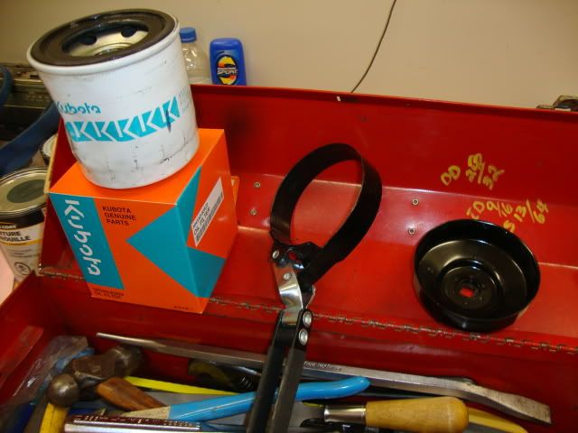

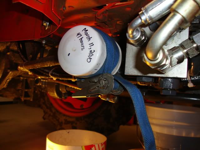

Here's a pic of my filter from last night. Second filter and first fluid change. Just a light coating of "steel fur". Pretty much what I consider normal for a transmission.
47 hours at first filter change, then 114 at second.
The wrenches were no match for the filter, the cup wrench bent the end flutes of the filter, and the strap wrench simply bent.
The ratchet strap with a prybar finally loosened the dam* thing enough to get it off. It was tightened following Kubota's directions..

Chilly807, I feel your pain.
It took a chain-style pipe wrench and a come-a-long attached to its handle to get the transmission filter off of the L48. What were they thinking?

I know what I was thinking, and I'm not allowed to post it here..:laughing:
If this one is as bad to get off, the next one won't be installed as tight as they recommend.
