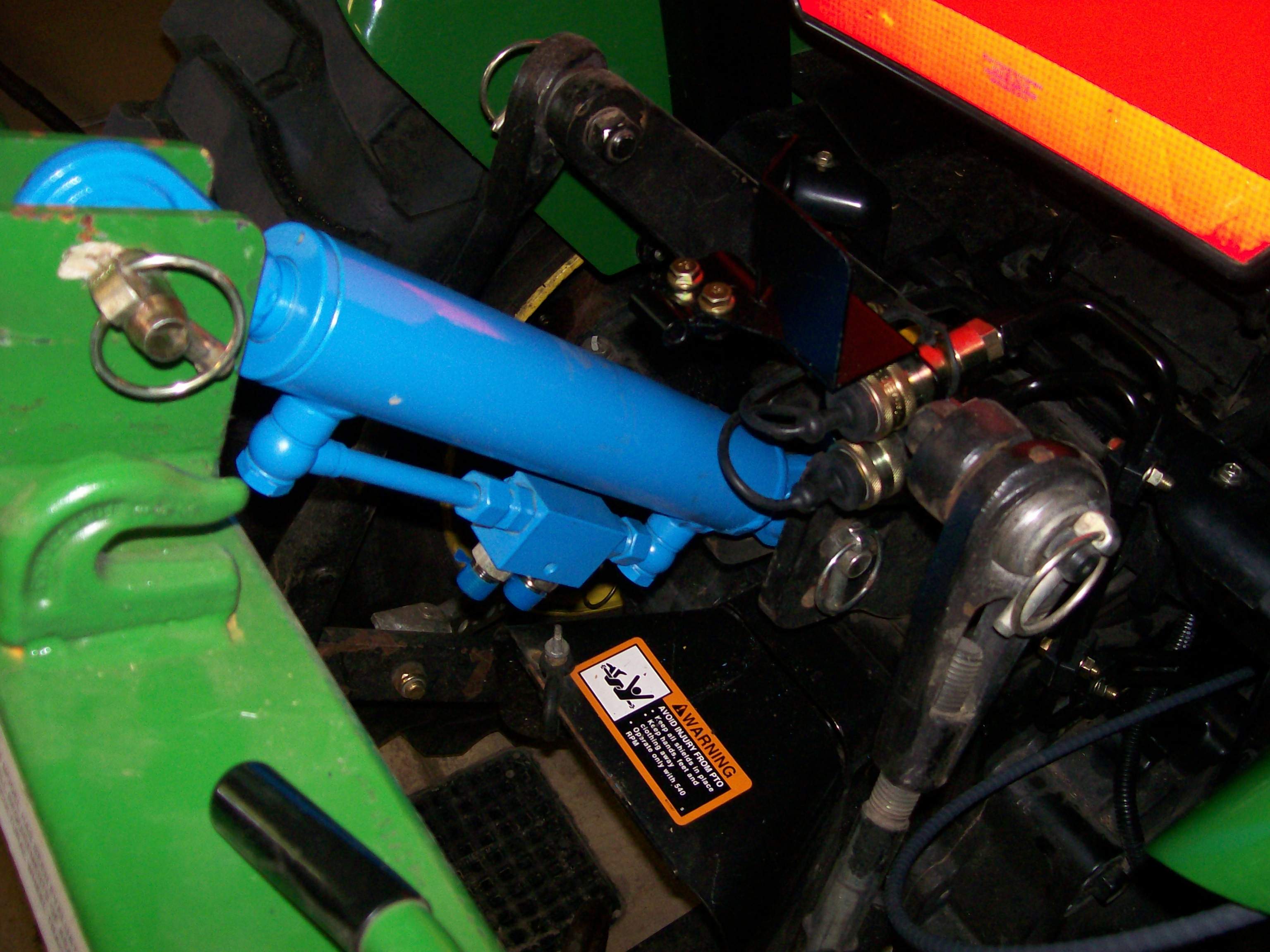

I went the Surplus Center route, but learned that the cast part on the tractor was too narrow for the SC ball swivel to fit.
I bought the one that fit, and couldn't be happier. Shown before hoses connected, and before painting black.

Your tractor looks like my 4200 with the Surplus Center cylinder. Mine came painted dark gray, so I left it alone. I just wish the rod was 1" diameter instead as the cylinder housing is just a bit big and rubs on my PB & SCV quick-connects if I'm not careful.
