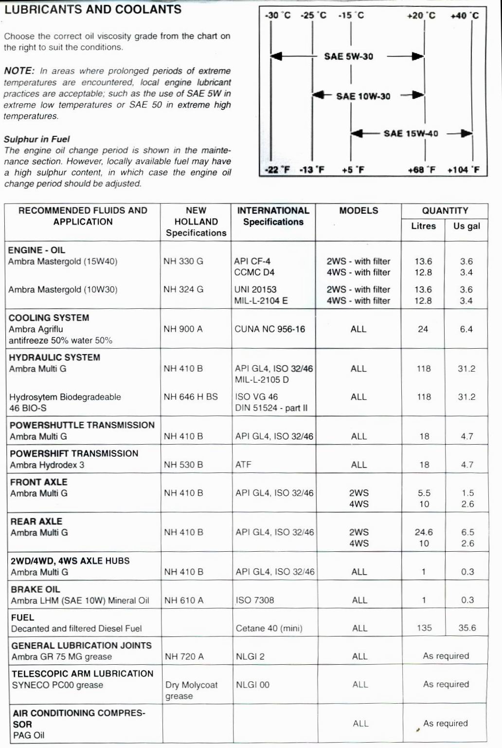

This has been the source of confusion with NH since Fiat showed up. Traditionally, North American (NA) Ford used M2xxxx oils, that was their spec numbers, be it a tractor, auto or truck. European Fords used other numbering. Ambra is Fiat's oil. That's why they use Ambra 134. They combined the Fiat/Ford names.
When the Fiat based machines showed up ( TN, TL, LB, LW), the owners manuals were calling for 410B oil, the brake oil had different numbers, the only ones that could be figured out was the engine oils. Now that Case/IH is in the mix, and more cross branding, there's more confusion. NH has a chart showing the NH/Ford, Fiat, Case/IH, Sae and Mil specs, along with current part numbers.
Long story short, NH410B is multi G 134 which is M2C 134D.
The cold weather substitute for 134 is F200.

I think it is interesting to note on the pail of Multi-G 134 above that it says "Transmission Oil" instead of hydraulic oil. It seems the better grade of oils by all manufacturers specify that they are acceptable for transmissions as well as hydraulic systems.
Just for fun, I scanned the lubrication spec sheet for my NH LB75.B TLB. There are plenty of specs to "chase" on this page. :D
