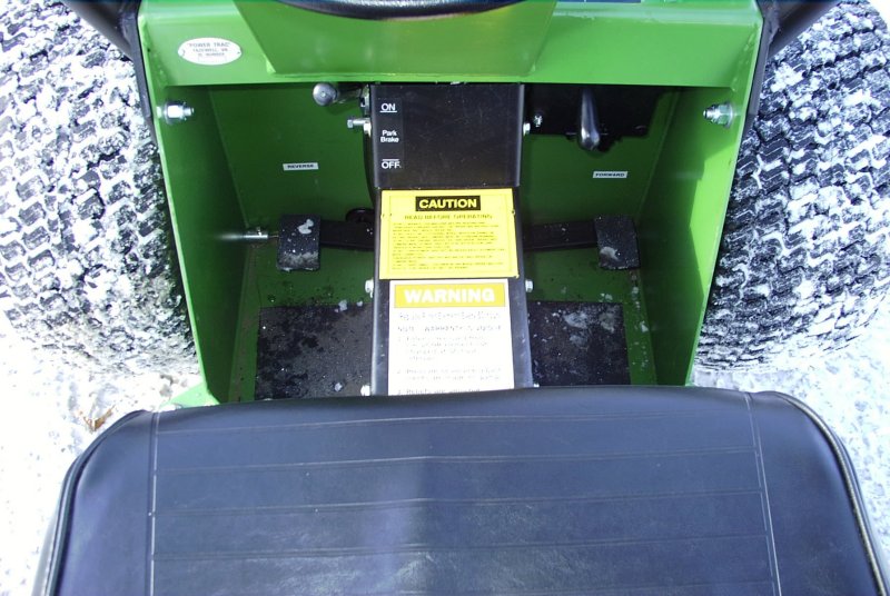

My NH TC35D has it's brake pedals on the left side, hydro pedal's on the right.
This configuration is one of the reasons I didn't want to go smaller then the 35D when I purchased. I do use the brakes. I have never liked the models of "any brand" with all the pedals under the right foot. I find it very comfortable and easy to ease off the hydro with the right foot while applying a little brake with left foot. Lift my left foot off the brake pedal and depress the hydro pedal with my right foot.
I also never really liked the rocker type hydro pedal although I am sure you would get used to it in time. I love the NH's seperate hydro pedals for F/R

My JD4200 has individual brake pedals on the left and one main brake on the right. The left ones really do help steer when clearing snow. The right one locks both brakes. When action is reflex it seems the right brake is the one that gets used.:D

I have a gear transmission on my Kubota, but if I were going to buy a HST compact tractor it would not be a Kubota because of their treadle pedal and brake pedal arrangement. I have always thought the separate F/R pedals on the right and the brake pedals on the left were the way to go. I don't understand why Kubota doesn't go to it. You see the other setup on tractors from every other mfr., so I don't think a patent problem exists.

When I'm back dragging the FEL on my Kubota B21, the front wheels are out of the picture so you can only "steer" with the brakes. Often when doing this you drift off to one side or another depending on the tilt of the surface you are on. So you bring your left leg over and make it work. It would be much easier if the brakes were on the correct side, the left as they are on my JD 4520.
As for the front/back treadle, B21 was my 1st non garden tractor, so that's what I learned on, it's not a problem. I do like the side by side better.

I have a small Kubota, and it is light enough to have a mind of it's own when I am using the bucket to clean small snowfalls, etc. Those times I sure wish that I had the JD set up. You can use the cruise control, and then steer with the brakes. I thought that stepping on the brake disengaged the cruise, and it does when both pedals are locked together, or you step on them both at the same time. However, if you just use one brake pedal at a time, they do work for steering. I find that helpful if going across my field in the snow, or up my woods trails, but often you really want a little assistance from a stop, and that is harder. You can use your toe for the brake, and your heel for the hydro, but it's awkward as is using both feet........ tried it both ways. Now if I could get my quieter 3 range hydro, some other Kubota features, and position control, and the steering brakes on the other side in a tractor the size of mine, I would be a happy camper.
