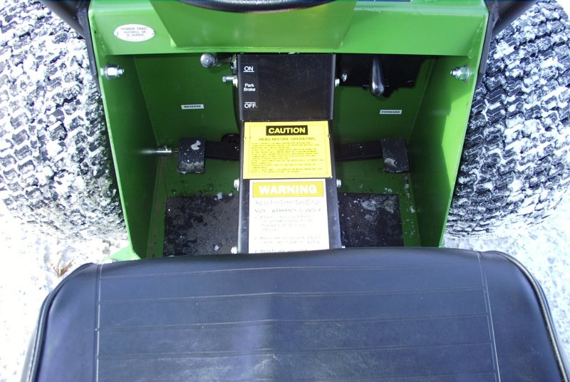

We had a late 70s IH2500b that was a 50PTO HP 2WD tractor loader with HST. The split brake pedals are on the right, the two hydro direction pedals are on the left. A differential lock is behind the right heal. A foot throttle is to the left of the split brake pedals along the tranny tunnel (it was a low boy, so it had a high tranny tunnel) and it had the hand throttle that would stick where you set it. The split brake pedals had a latch that allowed you to lock the pedals together. The operator's manual said to ALWAYS lock the split brake pedals together when operating in high range. Why? Because if you are going along at 16MPH and accidentally hit one of the split brakes instead of both brakes, the tractor could suddenly and violently turn to one side and flop over on one side. ;) I liked that tractor's pedal setup. I used the brakes when operating in close quarters on slopes. For instance, when going up hill to get something with the FEL that requires a gentle touch. There is that point on a hydro where the tractor will roll forwards or backward ever so slightly just enough to get you out of position. The brakes really help in those situations.
On our current tractor, we don't have any problems with the brake pedals being on the right or left or split or solid because we don't have ANY brake pedals on it! ;) The right pedal goes forward. The left pedal goes backward. Its a treadle. I like that setup the best. However, I am told I will hate it should I bust a hyrdro hose while on a slope! :eek:
