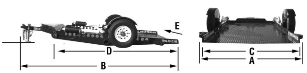

What about similar to this Lo Riser trailer design.

Again I like the orignal design, First post last pic, shows the kneeling action, I would build it very simular, with the exception, that I would set the cylinder back, using a longer rod, Simular to the kneeling trailer pic, Ive had the ride factor pluged in from the start, and Iam leaning towards an independant supension, meaning not tying each axle together, with a cross tube, and using air cylinders, instead of hydraulic for the kneeling action, and ultimatly then I can use them for an AIR RIDE, Suspension, :thumbsup: simple to do, and very nice ride, you not only have air ride, but independant suspension, ta boot,:thumbsup: And my front axle would pivot at the articulating point, with shocks. Should result in a pretty nice ride. The false floor has many flaws and offers little. Eric

What if you used a short axle (such as for a jet ski trailer) as your pivot points (mount the swingarms where the wheels would go), used hydraulics for the lifting the axle and put a pair of accumulators (with solenoids to allow them to be shut off) on the lifting line of the cylinder?
That should allow you to lift the swing-arms and (if you also installed a pair of pressure gauges) you could set your ride height/firmness based on pressure.

Air ride is much more sensitive, I thought about hydraulic accumulators, but buy the time you buy the accumulators, (2), and electric silinoids, and add the control valve, your spending sum real C@SH, and dont have the nice ride,air gives you, The 12 volt air compressor is going to run around 100-125 for good quality, and air valves,switches,fittings,gages, etc are CHEAP, and much eaiser to dial in the ride, Eric

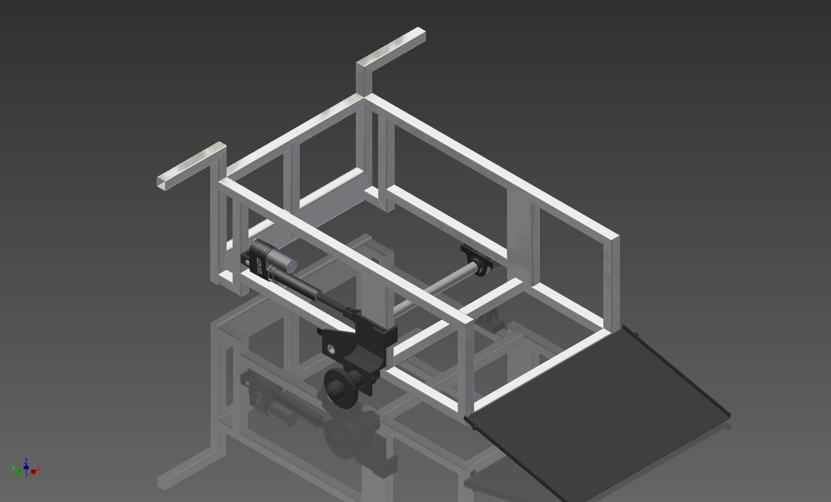

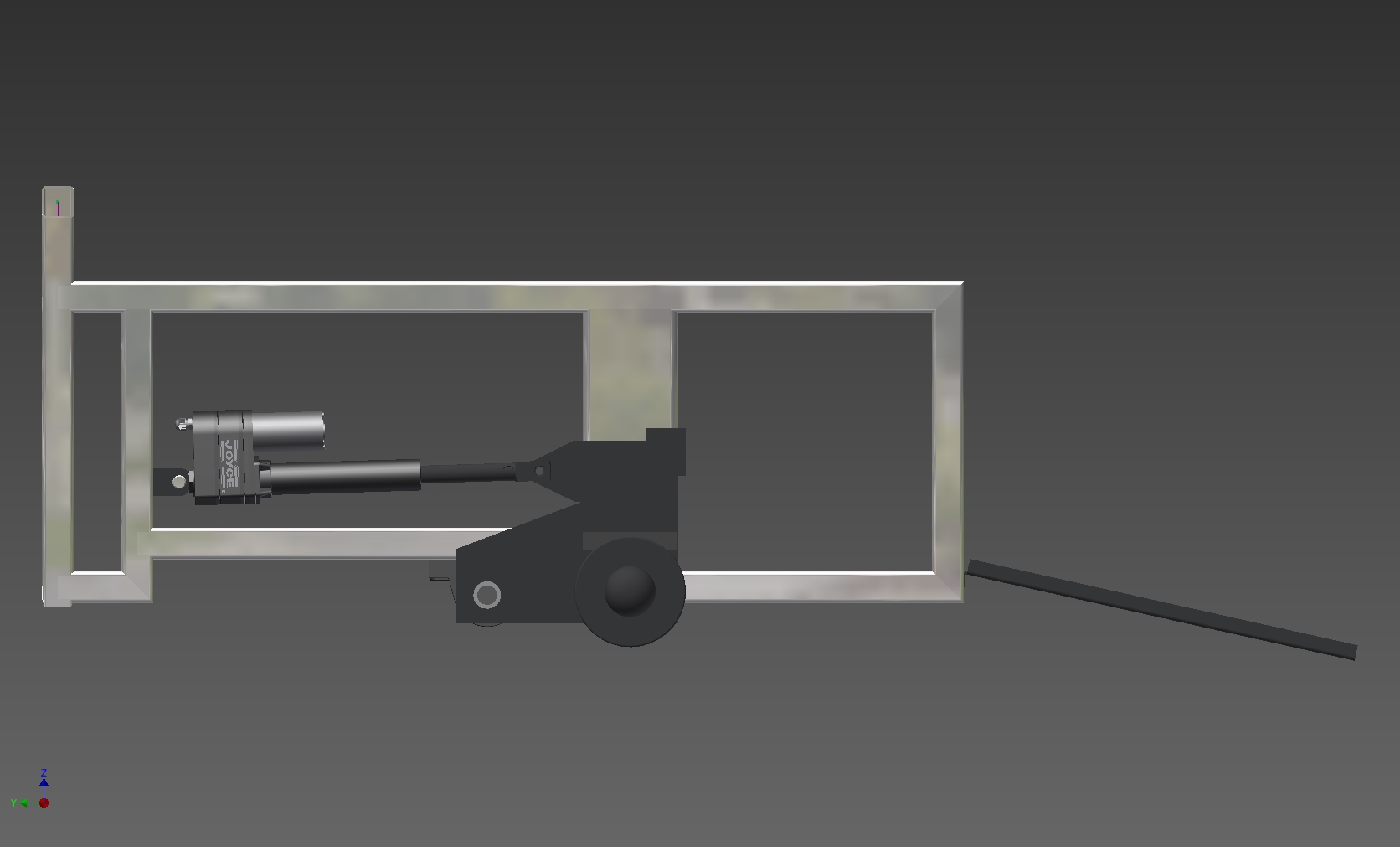

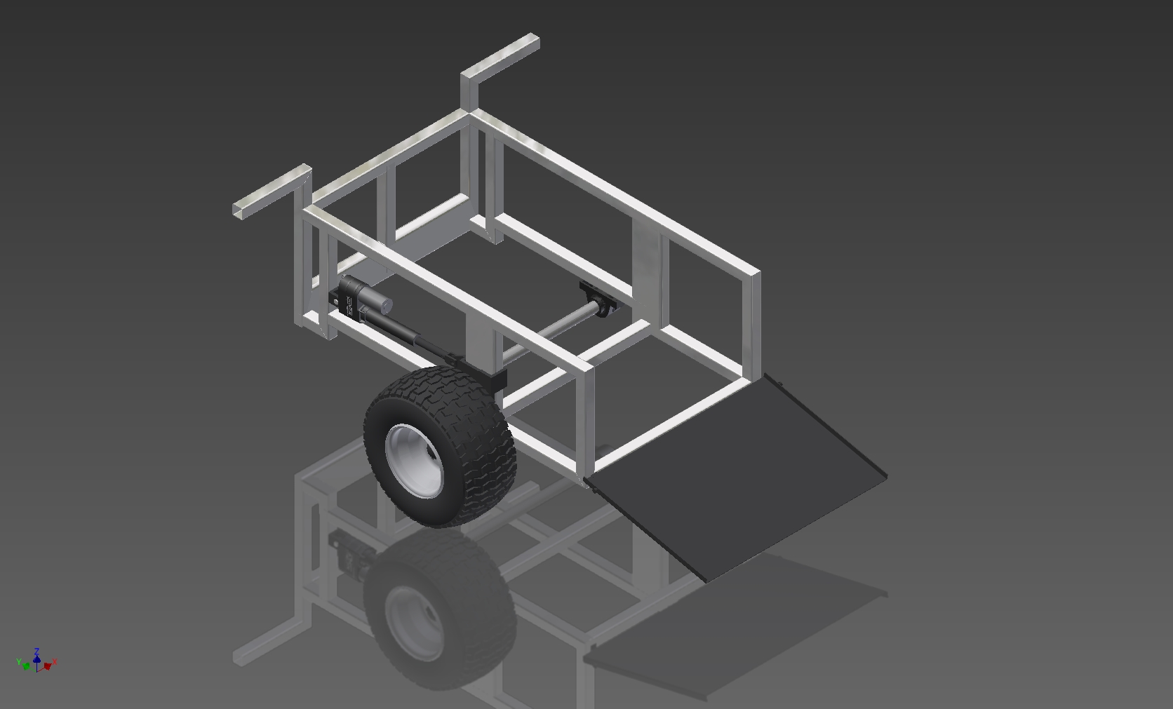

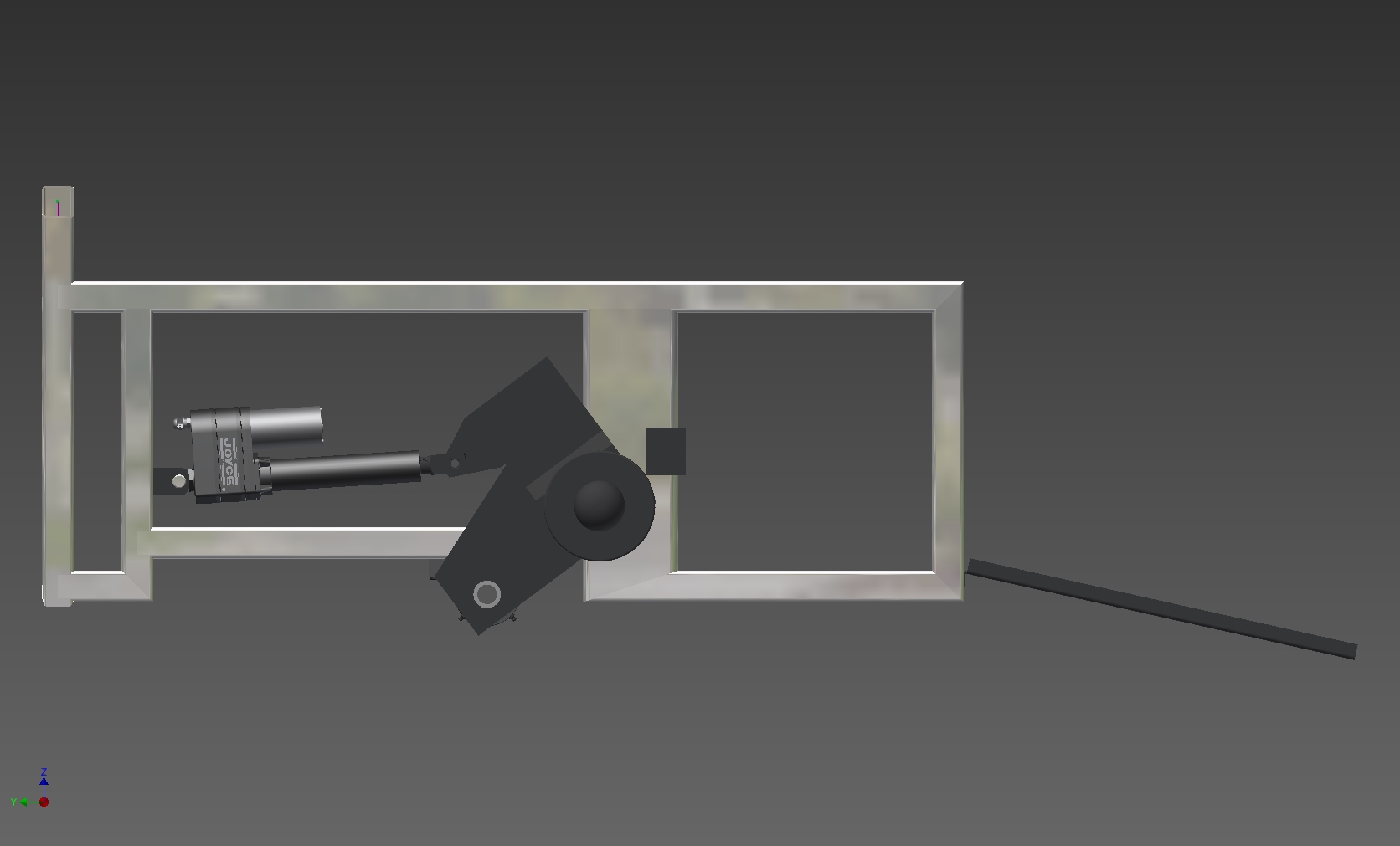

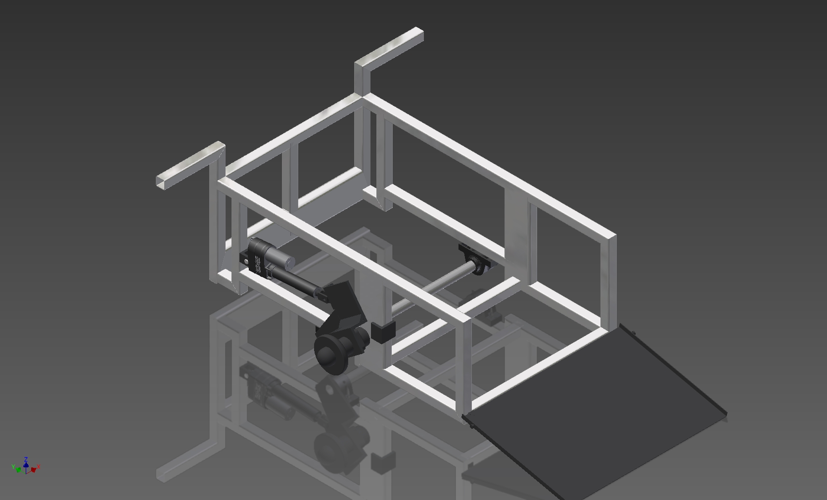

I think I've got something here, that I'm very happy with. I've taken bits and pieces of excellent advice from many different people. The linear actuator was something I've been thinking about for some time. I've got ones that I use several times a day, that I've had for 20 years and they still work as good as the day I got them. So I think they're a good option. The ones I put on here have a lifting capacity of 750 pounds. Which is more than enough. They would be so much simpler to install, not needing hoses, pumps and etc.
I haven't incorporated the ramp yet. I put a shaft going right through the floor which should give it a great deal of strength. But I'm just waiting to get some input on my progress so far. Let me know what you think.
Keith
Are they waterproof? One advantage to hydraulics or air is that they dont mind getting wet.
Aaron Z
Aaron Z
I will definitely have to find ones that are going to be waterproof, and can withstand pressure washing. And if they don't exist, I will just go the hydraulic route. The hydraulic company doing the specs and prices has already incorporated that in.

...I'm just waiting to get some input on my progress so far. Let me know what you think...
Brilliant! Retractable wheels.
