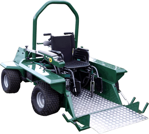

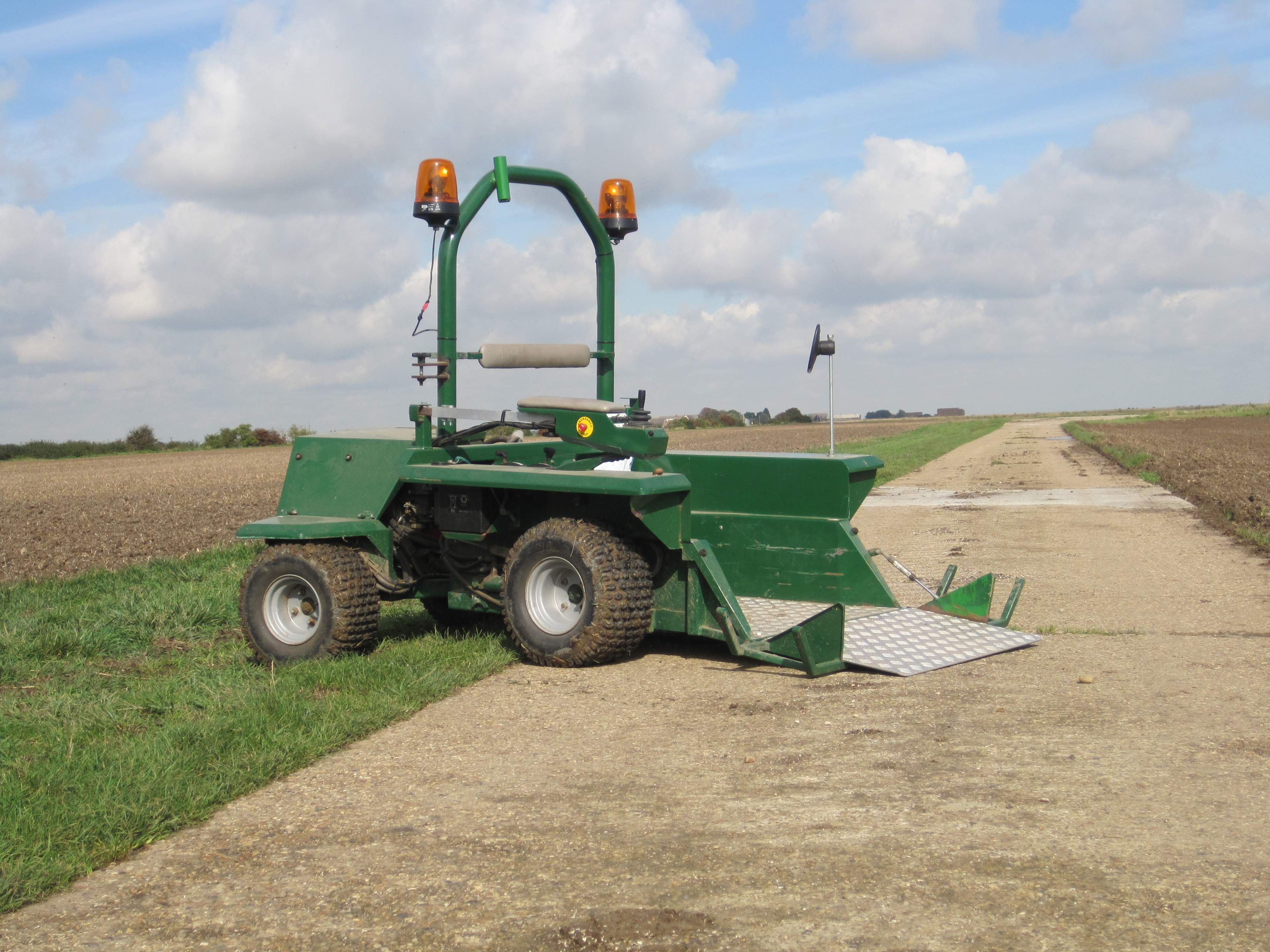

This is not exactly what you are looking for, but this is an articulating,oscillating AWD vehicle for someone in a wheel chair not nearly as fast as you want but will suit many other of your needs.
YouTube - New Style ATV
/ Hydrostatic ATV
#14
yes that is very much what I'm looking for, and I have seen that before. But it requires the user to transfer into the machine. Which I would like to be able to avoid.
