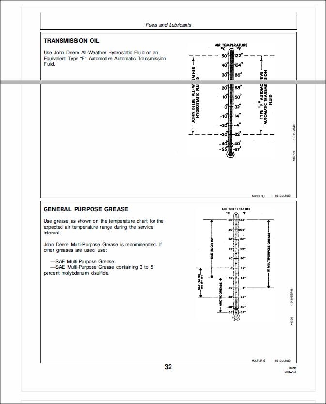

Jun 28, 2025 / Hydrostatic fluid #4 arto98607 Veteran Member Joined Aug 27, 2014 Messages 1,673 Location Southwest WA Tractor Kubota F3060, Grasshopper 721D, Ford 1310, John Deere 440 ICD, John Deere 300 & 430 Mike S. said: I have jd 400 hydrostatic lawn mower is there any hydraulic fluid that is compatible with jd hydrostatic fluid??? Click to expand... As far as I know JD400 is using the same Sundstrand 15 hydrostatic transmission as my JD300 and JD430 are and both approve use "Type F" automatic transmission fluid as an alternative to John Deere fluid. I have been using Type F in the JD300 since 1993 Here is a page 32 from JD430 operator manual:
