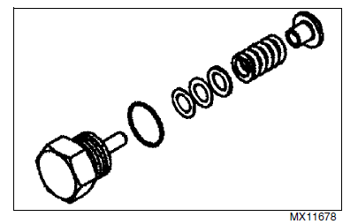

Like said above, you need to check the charge pressure first, but that is tied to the power steering, so if the steering is good, you probably have enough pressure. There is a pressure relief valve that controls the hydrostatic trans pressure, you need to add shims to it to adjust. There is a seat there that might be damaged. Located under the center of the tractor next to the test ports. The hydrostatic trans is a pump and motor just bolted together. It is probably rebuildable, but not thru JD. My 4210 has a Sauer Danfoss tag on the trans I noticed when I was under there.
In my case the steering worked fine but charge pressure was low which caused the transmission to chatter at low engine RPMs. It ended up the charge relief valve that had jammed open. Removed it and re-assembled, fixed the issue.
The steering relief valve opens at 1500 psi then dumps to the charge circuit which reliefs at 100-150 psi.
Did you have to buy a new charge RV? Is the charge RV adjustable, or fixed (welded) to keep you
from adjusting it? How did it fail?
From my understanding it's just a plug holding a spring into a round piece of steel that presses into the orifice to maintain charge pressure. It was my dad who actually took it out and he said the spring felt like it was jammed off center somehow. No clue how it got like that, but simply re-installing was enough to fix the issue, that was about 100 hours ago and still runs great.
You can add shims.
   / Hydrostatic Issue - Dealer says replace - About $8000 #18
Here is the picture from the service manual.
It should be part number LVA12615 on the parts diagram I think. You need to order the shim kit which I don't see.
Part Number: LVA12615
Remarks: CHARGE RELIEF VALVE, (SUB FOR LVA11862) (ALSO ORDER LVU14595)
