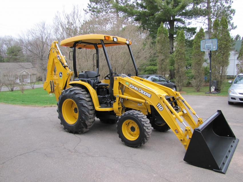

Don't know of any other tlbs' being available larger than the M59 at 59 hp. You might find an ag tractor that is larger with a hoe on the rear but doubt the hoe will be larger than the 12' hoe on the M59. Deere used to make the 210 with a hoe available but I think that was many many years ago and doubt it would measure up to the 110 or L45 offerings today.
The combination of the three, tractor loader and backhoe seems to be limited to large compacts. You can get the larger tractors or larger loaders or loader backhoes or larger excavators but not the combination of the three.
If anyone knows of a larger dedicated tlb with removable hoe and three point hitch I would like to be corrected. I would particularly like to know of any of these large tlb's that are within the $20,000 budget. Might buy it myself.

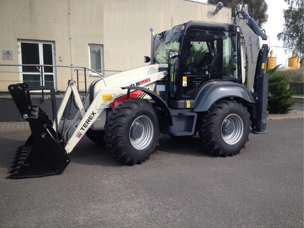

JCB makes a line of tractors in the size you are looking at but I"m not sure how the hoe attaches and if it can be removed easily. They come in several configurations including backhoe and box blade on the back

I thought about mentioning JCB as I seem to remember they offer a wide variety of options.
I looked into JCB and Terex before buying the 110tlb, both had some good options or pricing at the time. The first time I looked at the 110 I was not impressed and was considering a Cat 904 loader and 304.5 mini excavator. Just did not pencil in well with the extra moving costs for my jobs.
Still have not seen larger tlb's that are big enough to make a difference. JCB looks pretty good imo.
