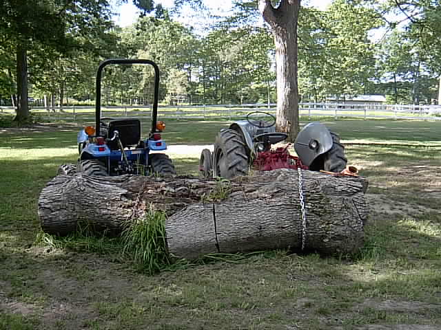

That doesn't work. All of my tractors are gear models, and I can't keep my wife off of them. She actually prefers the 8N over the new one though.
I love my TC18, but if she would have let me spend a little more, I would have bought the TC30. Great value for the same price as a TC24. I don't mind not having hydro one bit.
