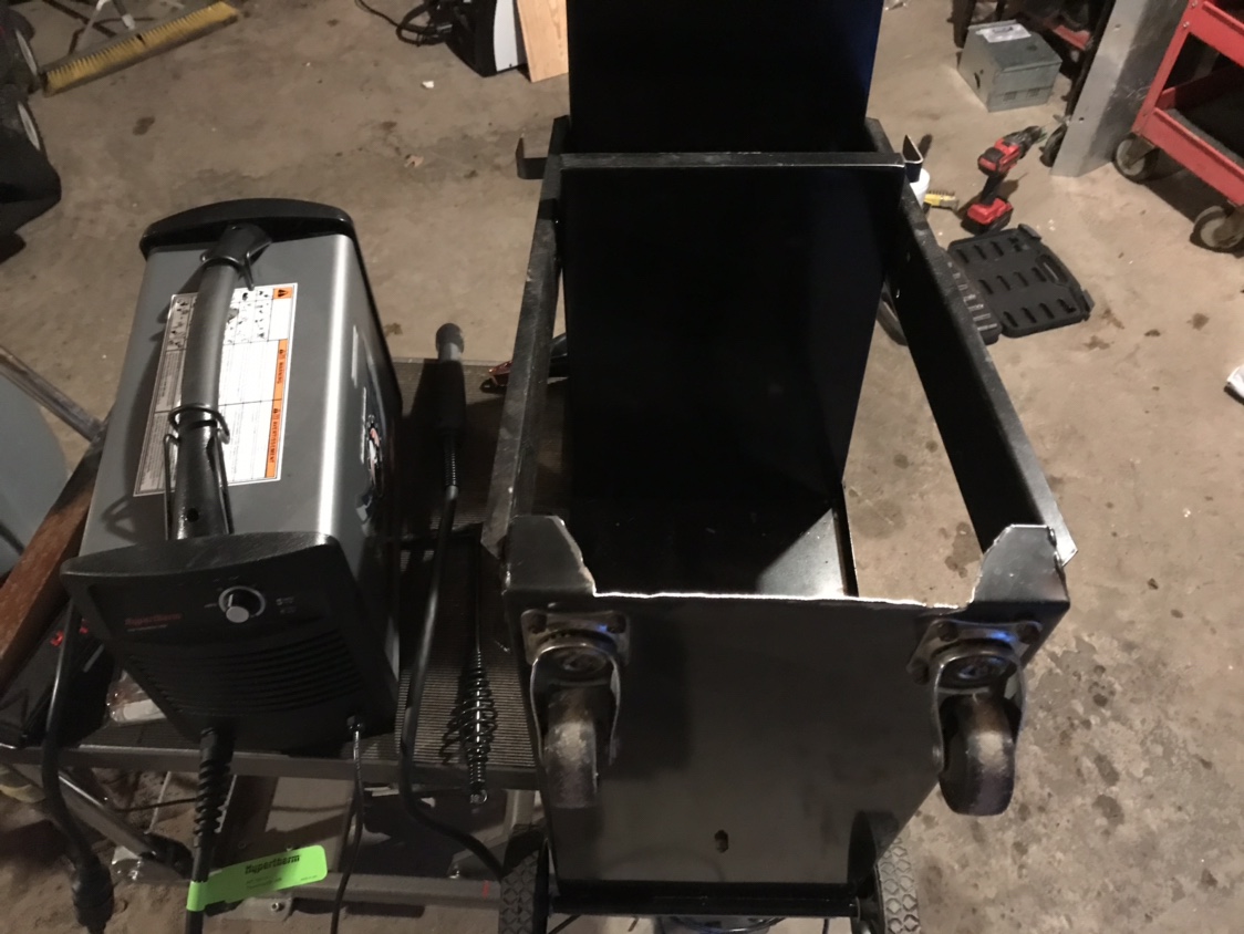

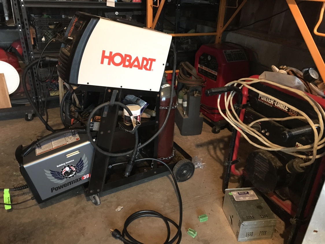

Not to hijack HCJtractor’s thread. I picked up my Powermax air30 today. I wanted to install it in my cheap HF welding cart with the Hobart 210MVP but ran into the first problem. It wouldn’t fit in the bottom. Too tall. IMG_0127.jpg
So. I wasn’t taking the handle off. I looked at raising the upper shelf slightly but the depth wouldn’t allow the cutter to set flat because There is a lip on the bottom shelf.
So I cowboyed up and decided to use my new plasma cutter to cut metal(who woulda thought?) and trim the lip.
Short version. On 110volts and 20 degrees in the shop, it was like a butter knife cutting through the lip. 5 minutes later I was putting everything back on the cart.
The plasma cutter had to go on the bottom as the Hobart has a side opening door that opens to replace the wire spool.
So Day 1 Cut 1, this thing was impressive!

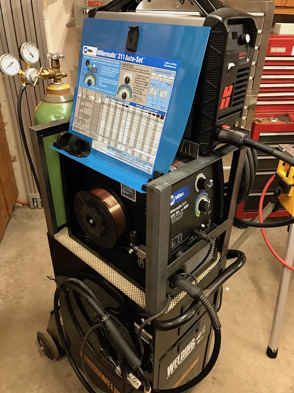

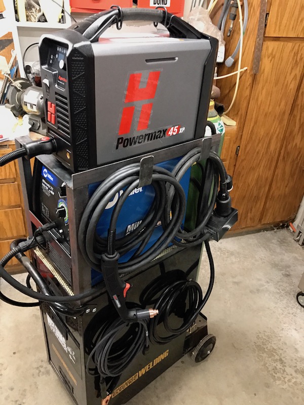

Congrats, lenny! Enjoy your PC! Here is what I did to add my Hypertherm to my HF welding cart. I made a frame that fits on top and is offset so I can access the wire on my MIG. It's match painted now and looks like it belongs!
I coerced my wife to make a custom cover but this is going on a year + project as she isn't very excited and is trying to make it perfect.

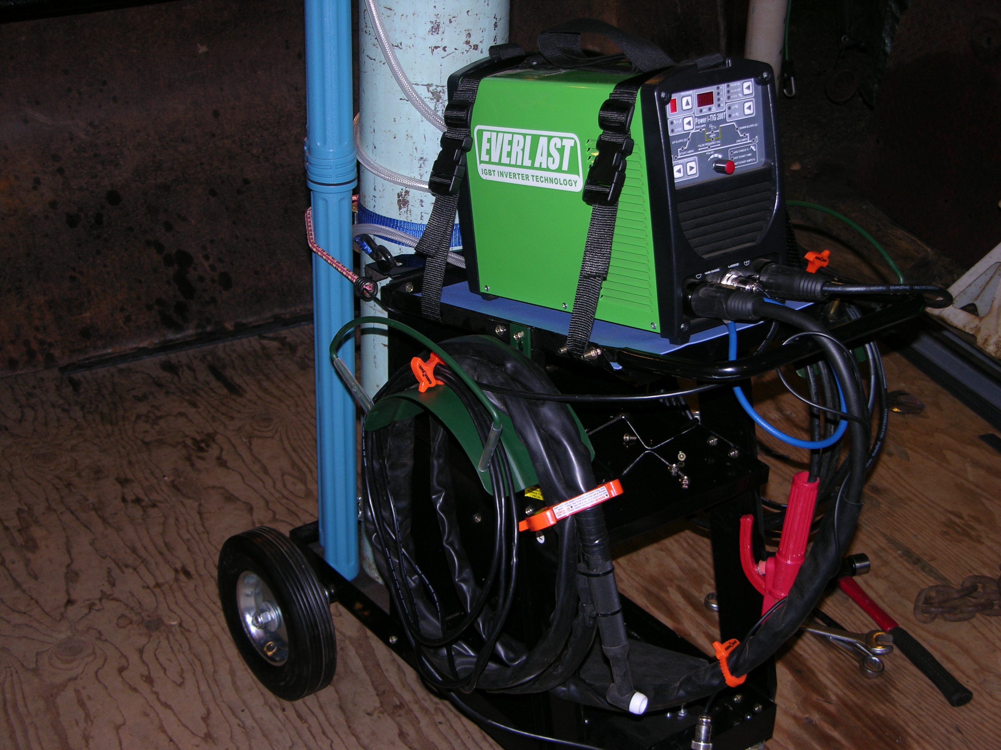

Lenny, congrats on adding to your fab capabilities, you picked a good brand to avoid buyer's remorse :thumbsup:

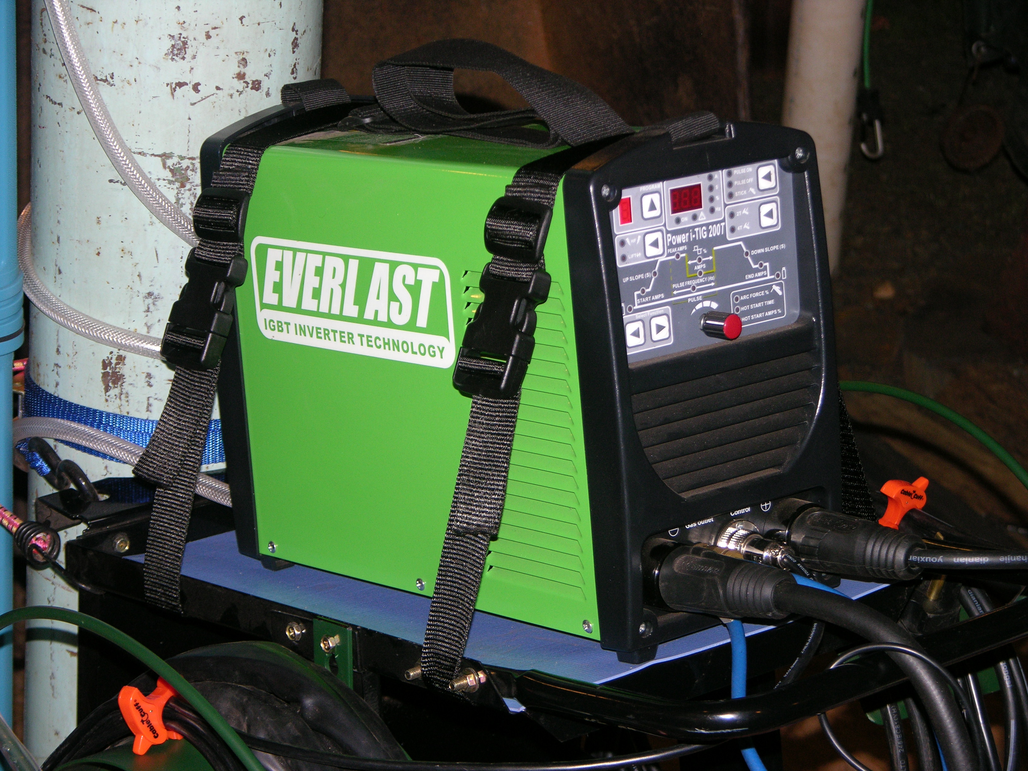

I bought one of those same HF cheap carts for my little Tig/Stick Everlast (except I got my cart from Amazon so it's BETTER 'cause I PAID MORE :rolleyes: )
Seriously tho, it appears to be identical but with a different NAME on it. Seeing what you did to yours so the 30air would fit, kinda makes me nervous for you - those things are marginal to begin with, so I can't help thinking that yours may give you problems with excess flex around the front casters. Pretty sure I woulda found a way to beef up that lower shelf with some angle UNDER the shelf.
My situation may be a bit different than yours, in that my "shop" areas are more gravel/dirt than concrete at the moment, so I modded my "crap cart" with bigger solid rubber rear tires and bigger, LOCKING front casters (I prefer to be the one who decides WHEN things can roll around)- I also threw away the chineseum bolts and assembled the cart with slightly bigger (likely STILL chineseum) ones :rolleyes:
The bigger wheels/casters help noticeably with "rough terrain" - I also lengthened the rear axle (needed 5/8" diameter anyway), so went with allthread and a couple extra nuts - feels more stable with the slightly wider track -
I haven't measured yet, but expect that cart will go bye-bye when I get around to adding a tig cooler :rolleyes:
Anyway, advise here is usually worth every penny you pay for it; I just hate to see ANYBODY have problems that could've been avoided, and I've messed with enough HF stuff to know that if something wasn't necessary it wouldn't have BEEN there... Steve

Thanks Steve. I did leave two 45 degree angles down on each side above the casters and a slight lip across the bottom to maintain rigidity but I will check and see if there is any flex. And beef up the bottom shelf like you describe if so.
