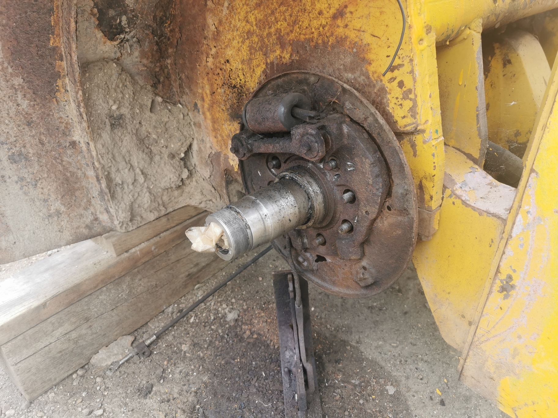

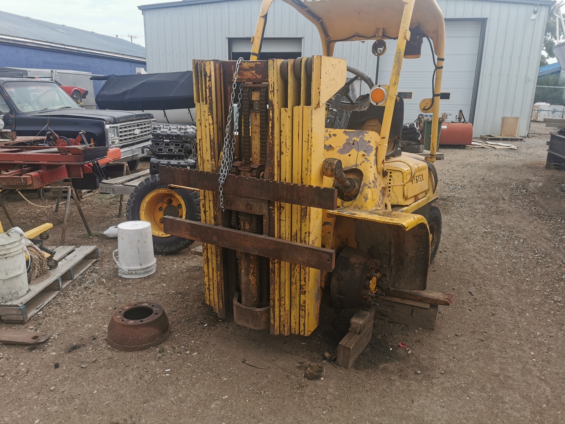

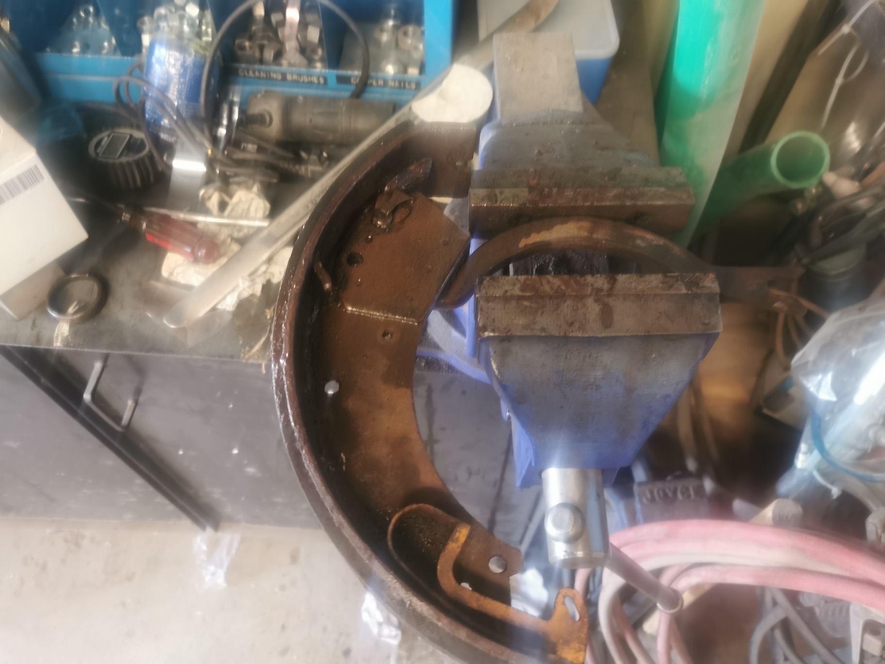

this morning after charging battery fired it up, lots of grey smoke turns out the idle was way down, after adjustments it runs decent, blows dark smoke when accelerating brakes are not like a car, they do stop and hold but thinking a further bleeding is in order, easily lifted a old car but need longer forks the ones on it are 54 inch
will run it round for a week or so then another oil change, still have to figure the dash electrics but all in spent under 400 including a new seat to be installed

I lucked out and found some 4x8" I beams about 7 feet long on craigslist a while back. Got two of them and a stick of .250 flatbar that was 9" wide for $40. Made me a set of 8' fork extensions. A little thick for pallet work but for picking up cars or pickup toppers they work great, and were a lot cheaper than any other option.
