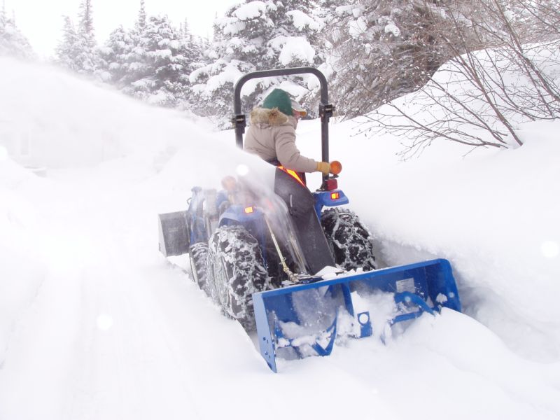

Hard to pick what someone else might like but I can tell you that I'm thrilled w/ my TC24D. First tractor I've owned and I wasn't sure what to expect other than a bunch of learning about a new piece of equipment.
What I found is that it's an amazingly sturdy little tractor that has made several chores around my 10 acre property a lot more pleasureable. One caveat ...I too have steep property and this tractor is skinny enough that side hilling will make you pucker. Initially it scared the daylights out of me but I've since become somewhat desensitized to it, particularly on snow.
I've reversed my rims for add'l width but didn't get too much. If you have steep property the 24 might not be the perfect choice but I'm certainly happy w/ mine.
