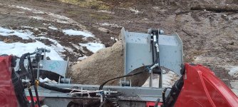

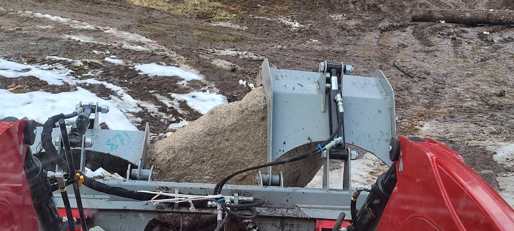

#16

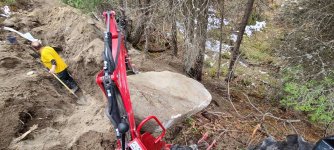

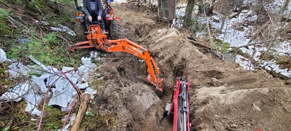

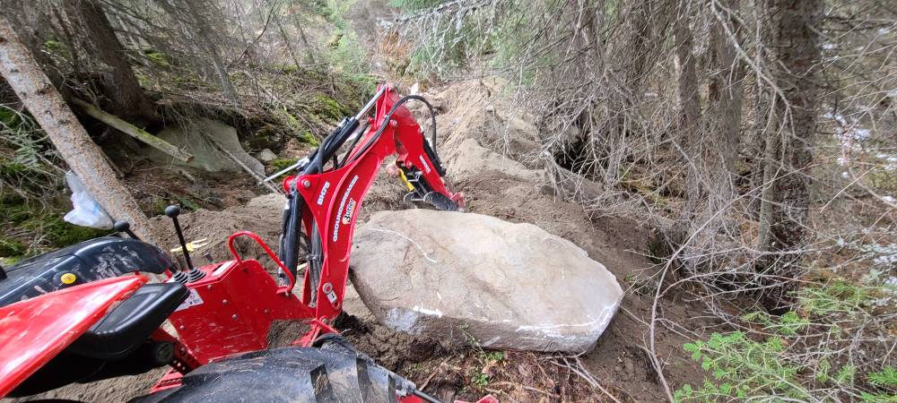

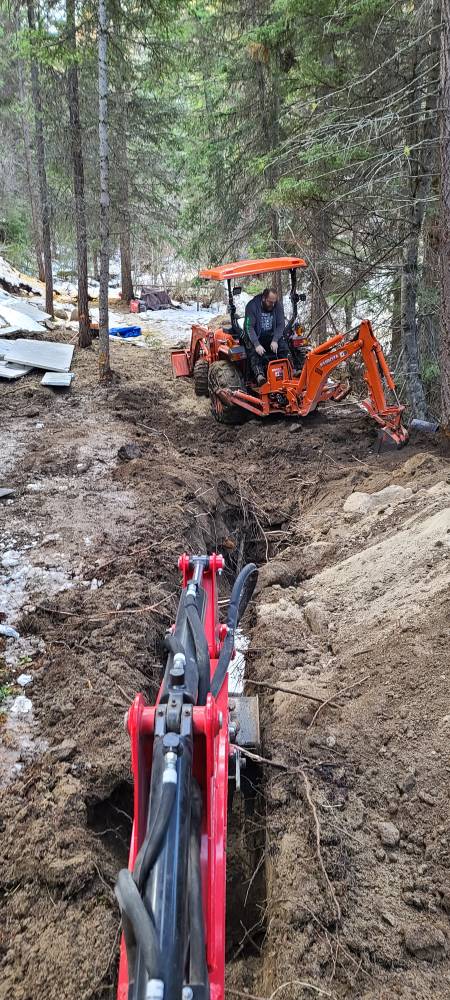

Second week of November helped my neighbor dig his 350 foot long 6 foot deep water line ditch in 28°to40° temps, never missed a beat or suttered once and 95% of the digging was at idle. I have to admit I was totaly impressed at the size of the granite boulders this hoe would move!
He was only getting 6-8 feet a day with his smaller Kubota (and less operator experience) I finished it in 32 hours, I dug the ditch and he layed the pipe and backfilled behind me.
He would have been in a bad spot if I hadn't stayed till completion because there was no egress to get his tractor off the ledge untill the job was done.

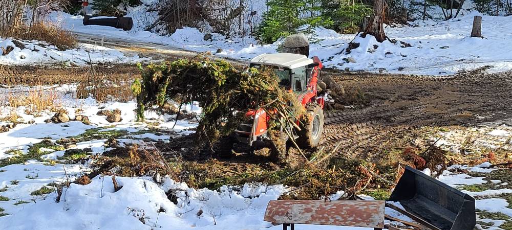

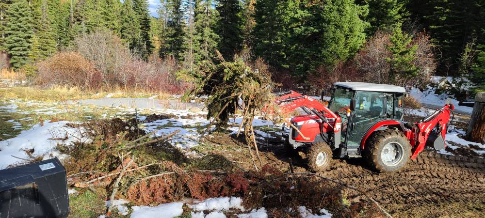

#17

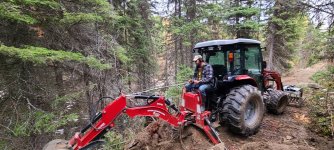

The following week I put about 20 hours on her moving slash piles and boulders with the grapple and doing some ground leveling in preperation for winter in 20° to 38° weather. Neber acted up even once.20201104_142038.jpg20201104_141947.jpg20201104_152525.jpg

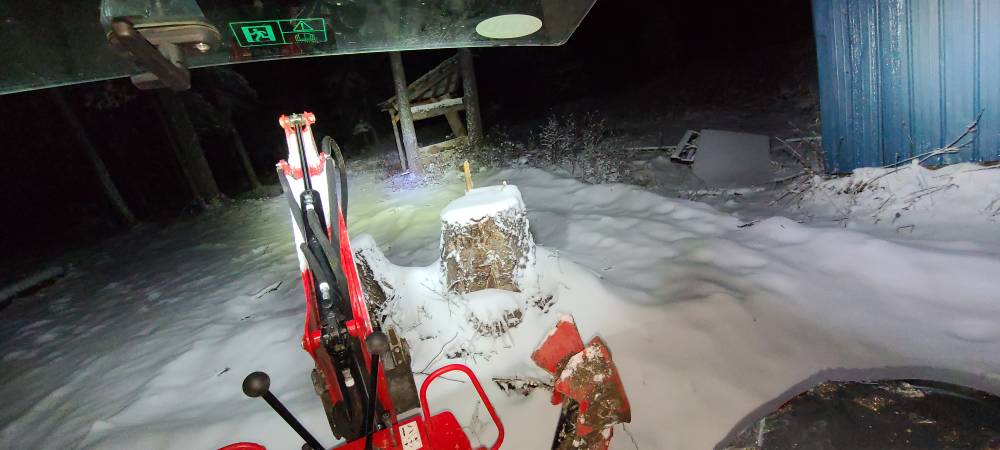

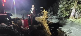

#18
I dug up 18 tree stumps in the middle of the night while snowing in 15° to 20° temps and once again, running strong, no black smoke, no stumbling, running like one would fully expect it to.20201107_224355.jpg20201107_235317.jpg

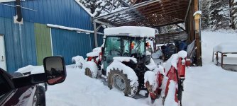

#19
Then the BIG test!
Left it sitting outside in single digit to teen temps in the snow for 3 days (no block or oil pan heater plugged in) and never touched it.
When I went to start it, I cycled the glow plugs three times, cranked it over and started it.
Of course it chugged and rattled for 20-30 seconds as one would expect it to, let it warm up for about 10 minutes or so and went and removed the backhoe and bucket and installed the front and rear blades and and moved some snow.
