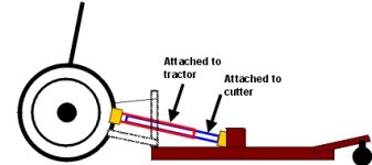

</font><font color="blue" class="small">( Generally PTO equipment comes with a long PTO shaft that must be trimmed to fit the particular tractor. There is no standard on distance from the end of the lift arms to the PTO spline.
)</font>
Here's a simple illustration that may help to illustrate your point, Hazmat. It's attached.
In the illustration, the red part of the PTO shaft is attached to the tractor by a u-joint (yellow box), and the blue part is attached to the cutter. If the cutter is raised or rolls over a bump, the blue sliding part of the shaft may bottom out in the red sleeve. That would put excessive force on the PTO shaft attached to the u-joint. Actually, if the tractor was strong enough, then the PTO shaft on the cutter might break or the entire shaft might bend.
What needs to be done to eliminate this problem is to take the PTO sections apart. Cut some off the ends of both red and blue pieces so when the cutter is raised, the two pieces don't jam. You also have to be careful that you don't cut too much so the shafts become uncoupled while spinning.
That's a brief explanation of what Hazmat described and ronjhall's link describes in greater detail. There is no way an implement manufacturer can know what the measurments are for your tractor, so they normally supply PTO shafts that are long and expect you to trim them if required. /forums/images/graemlins/smile.gif
