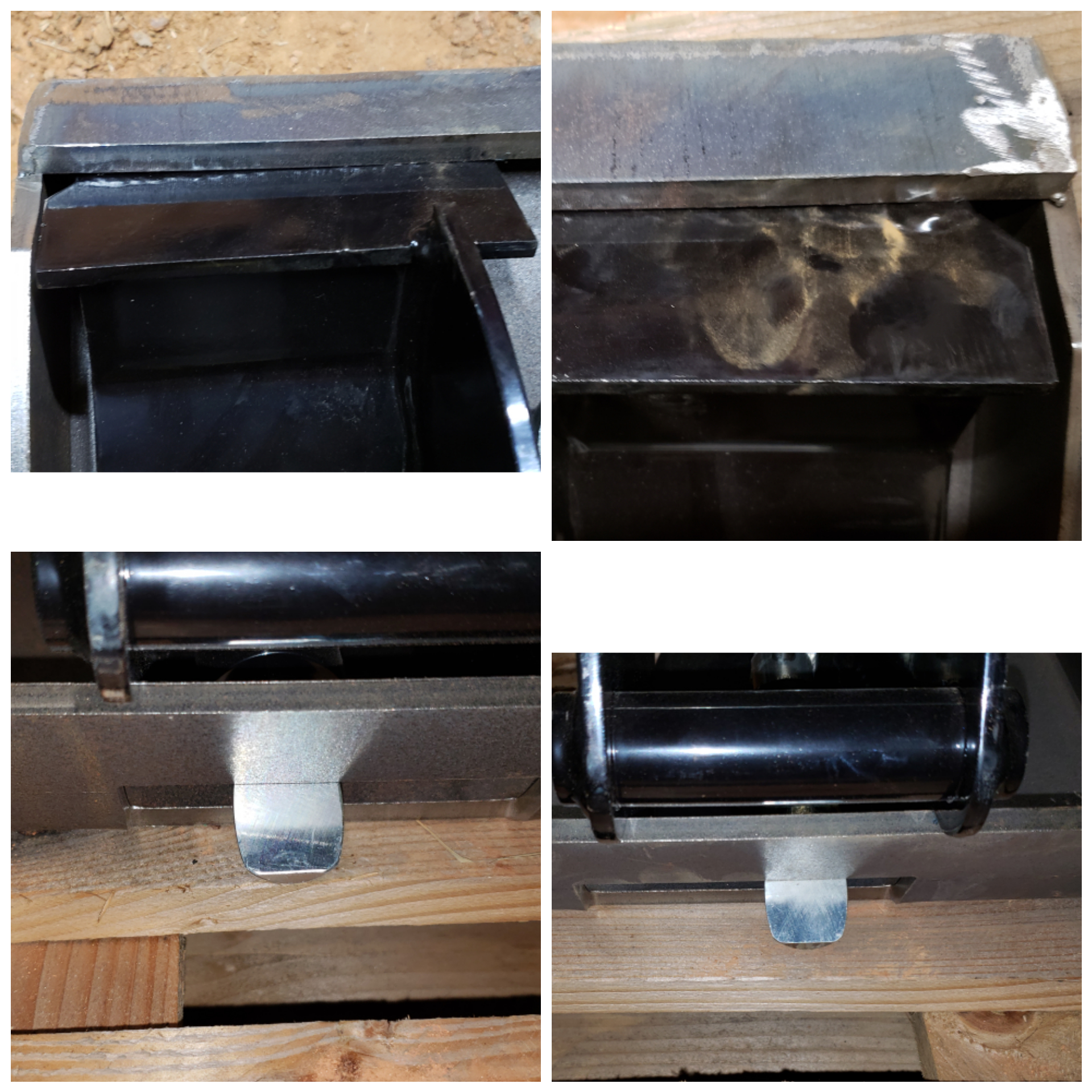

The tool holder is a very nicely made piece.
One good/bad thing about working from home. You can take a break and check on something.
I went out and checked on the fit. I tried it with the adapter plate and the pallet fork plate.
The seem to fit nicely.
Here is the bucket adapter.
Here is the pallet plate.

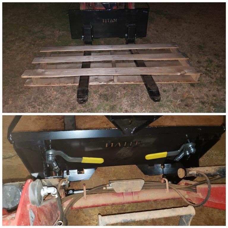

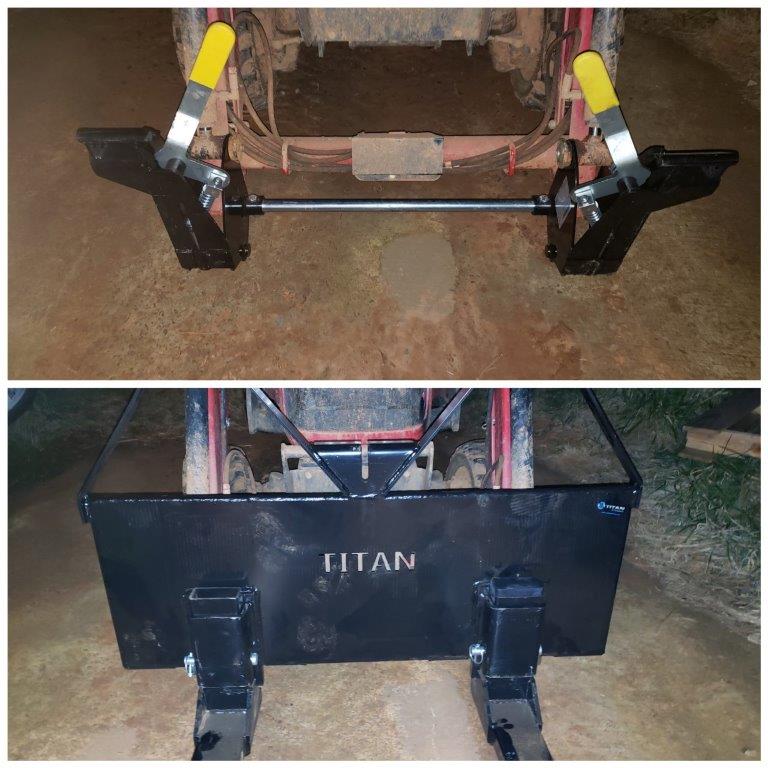

I have those Titan forks and love them. I can make any type of adapter and add to the brackets where the forks go. Here is what I use to move trailers around with.

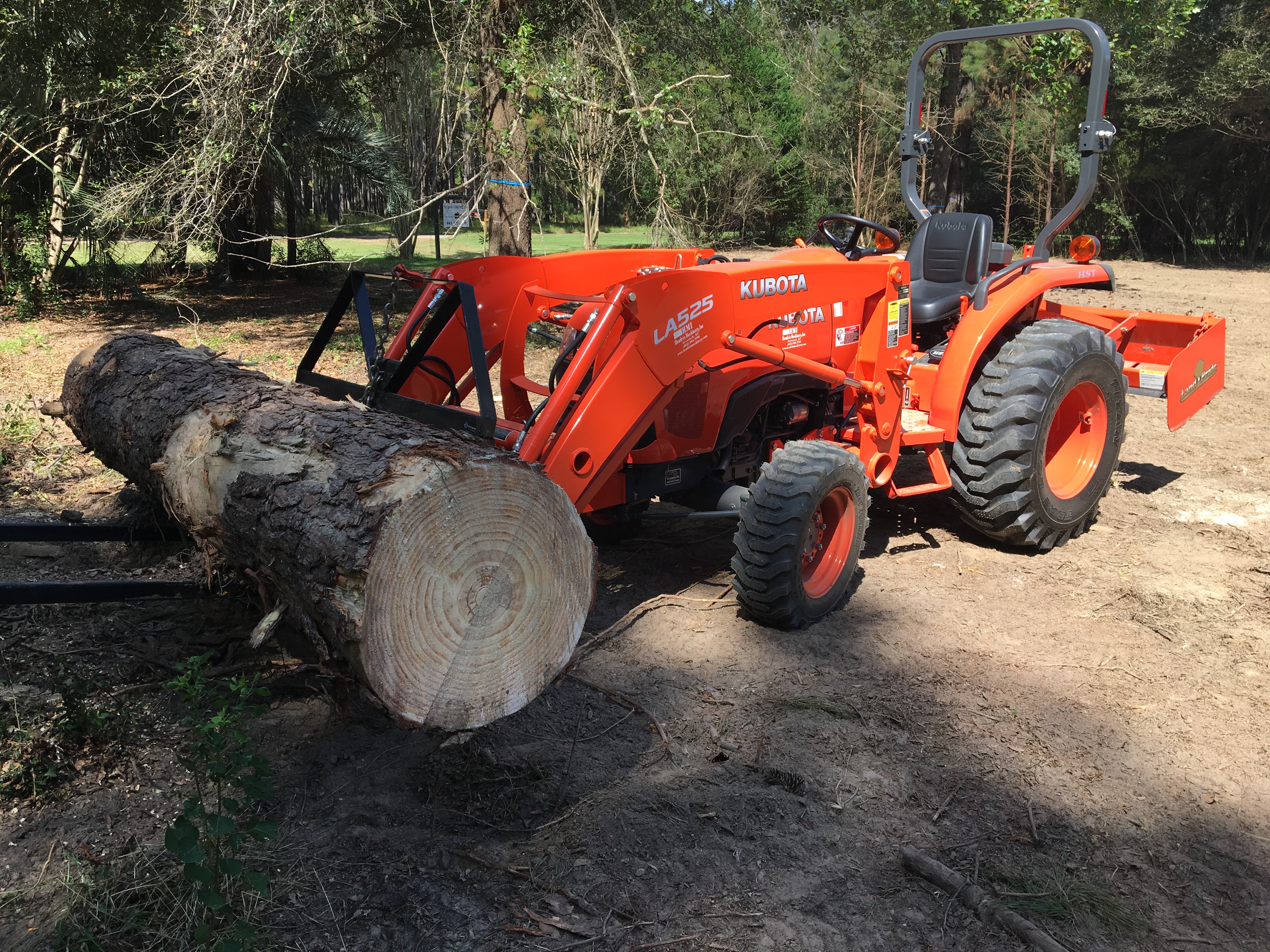

Nice thanks for sharing pictures. I want to make something similar for moving trailers around but not as heavy duty as yours.
I want to make an adapter to put my boom pole on it I think that would be handy.
I was thinking about maybe making something like this.
AGRI supply sells 43" bale spears for 32.99 each. Maybe make a 4-5 spear one?
My new pallet SSQA forks total weight 229 pounds. If I compare them to what I was using.
I think the stock bucket is 155 pounds 4,000-pound bucket forks are 113 pounds with stabilizer bar.
The total weight bucket and bucket forks. 268 pounds but it pushes the load you are lifting out some distance from the pins. (bucket depth)
I need to weight the SSQA tool carrier but it is under 100 pounds.
My new setup will be 60 pounds heavier than the bucket plus the bucket forks but the load is moved much closer to the pins of the FEL.
This is a fair trade off.

The SSQA tool holder is installed. I tried out the pallet forks. I dropped them off and connected them back up a few times.
Very quick and simple design. This was my first time using a quick attach. It left a good impression so far.
One step done one more to go
I will cut off the bucket brackets and weld on the new adapter plate this weekend.
