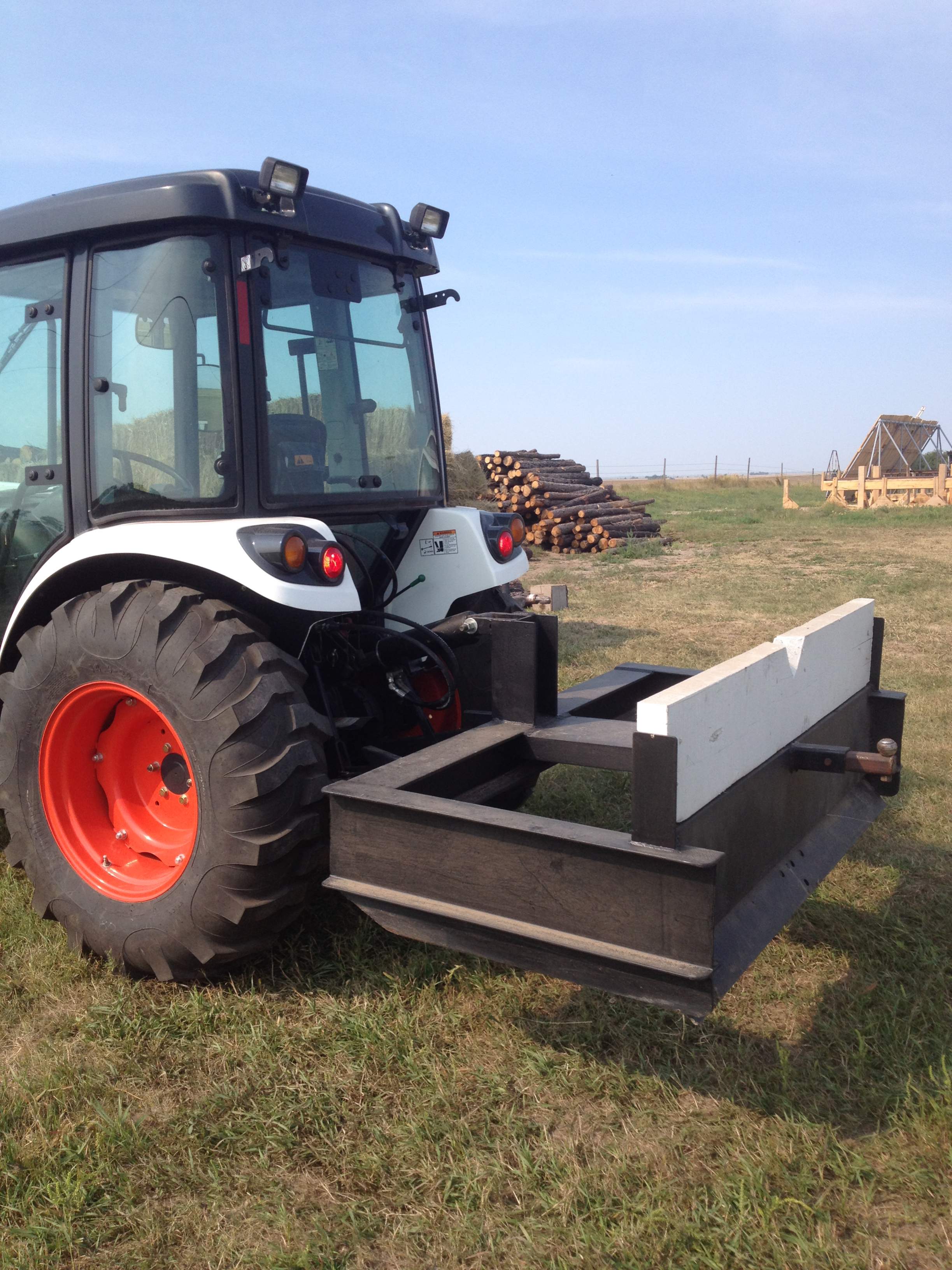

I have an 8" I-beam segment slightly wider than the crown of my rear R1s . I want to weld it into a heavy duty box blade have any of you seen or done this? It will be used for leveling compacted soils for clearings, footings, ect. Pictures are helpful.

I made one out of some scrap I beam, channel,and a large piece of angle.

Wow brother! That is one substantial piece of Iron. I will not be grading gravel but more like leveling a surface for a greenhouse, trails in the wood, ect. The sides are not so important to me as are the attachment points. My tractor has draft control so I have some down force in addition to the weight of the beam.
To all who use one: How critical is it to attach an expendable cutting edge, how would you do it and what angle would you use?

IF you are just doing dirt, you arent gonna wear the metal away very fast, especially for light homeowner use. Somewhere around 20-25 degrees off vertical. Call it 70* or 110*, just depends on where you reference.

Whats the white piece on top, is that for weight.
Thats for when I used to to push snow in reverse. Essentially gave me a taller blade to push more snow.

I just purchased some weld on ears off ebay for attachment points. There are lots of inexpensive options out there. I would not worry about a replaceable cutting edge. I doubt you will ever wear it out. I used a large piece of angle. I want to say 6x6x3/8. Laid it with the open side facing down and it seems to work good for grading and snow removal. Having an adjustable top link makes a box blade much more useful IMO.
Before I build this I just used a big piece of I beam and drug it around behind the mower.
