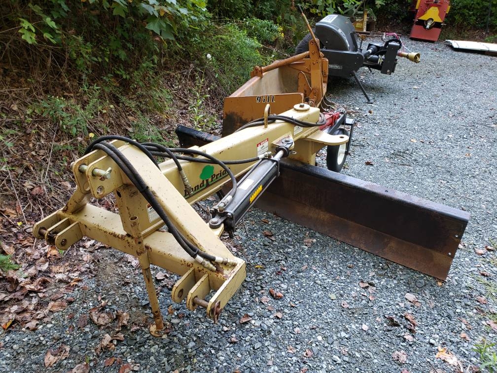

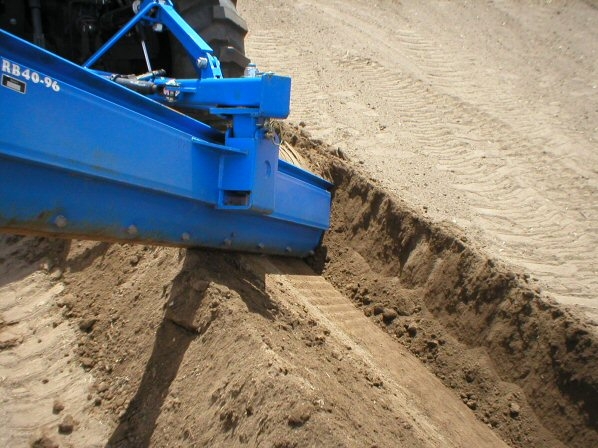

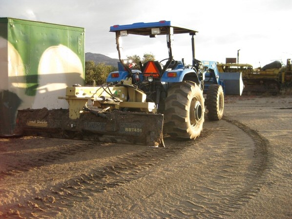

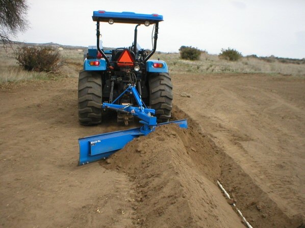

I used it for the first time today, fixing the county road that goes to my farm. I have a lot to learn as far as technique and efficiency goes, but I am really happy with it. 8ft is actually a good size. For what I was doing, I could angle it sharply and not need any offset. For most of my work, it’ll be angled the full extent. Tractor felt plenty heavy enough.
Pictures
