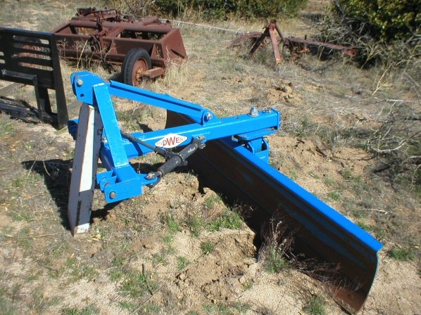

I have nearly identical conditions at my place. I have a Ford 782A blade I use all the time behind my 3910. I think it's a 7-foot blade. Adding side wings and a hydraulic cylinder for angling left and right has been on my "To Do" list for a while. What really helps is a 3PH top cylinder that lets me adjust the blade attack angle. It will dig deep or not depending on the angle.
I looked but couldn't find a picture of mine but the one below (from an auction) is identical to mine. I've added a drop-down stand post on mine to help connect it with my quick hitch.

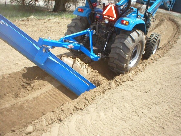

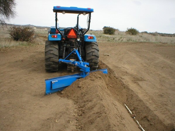

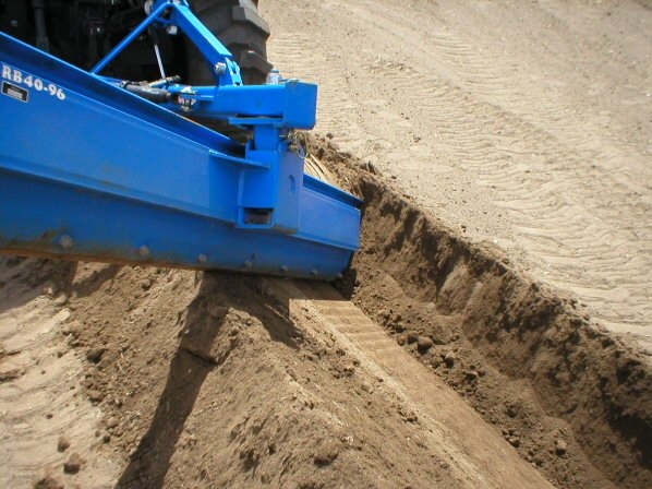

I've found that the more adjustments the grader blade has the better work it can do. A 7 foot seems to be OK to handle, but an 8 footer is too much for our 60 hp Kubota. It tries to steer it in our dirt. .
Like everyone, we started with an old blade that would only angle and added a box blade.
Then much later we got this one that had swinging offset, adjustable tilt, as well as angle & were amazed at how much more work it could do. But it sure did cost more, too. I was lucky & found a used one online. Adding a set of side wings made it better at crowning and allowed it to pretty much replace the box blade for finishing. Fits Cat 1 or 2. About 600 lbs.

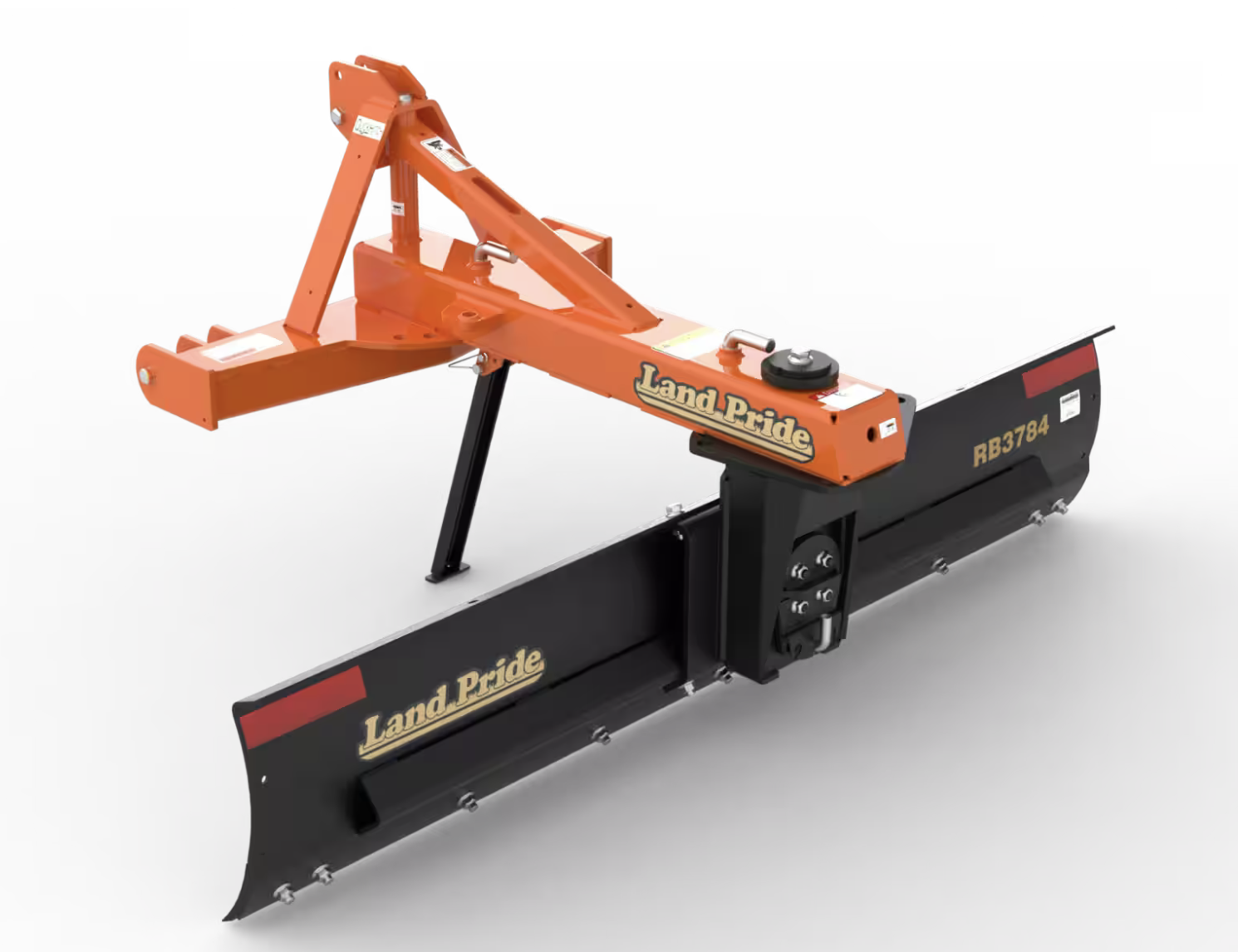

Ours is an older Land Pride & I don't find the same model today....but looking at their catalogue a 7 footer manual adjust would be similar to their RB3784 today. Ours is basically a RBT35 series but without the hydraulic cylingers. It could be made into hydraulic, because the attachments points for cylinders are there, but ours is manual and uses pins like the RB3784.
It's hard to figure the right width for someone else. You can use a shorter blade when it has swinging offset and tilt like these do, we are just doing one roadside at a time when crowning anyway. For crowning I run ours with a single side plate sometimes. and for that a six footer with offset would do the same job.

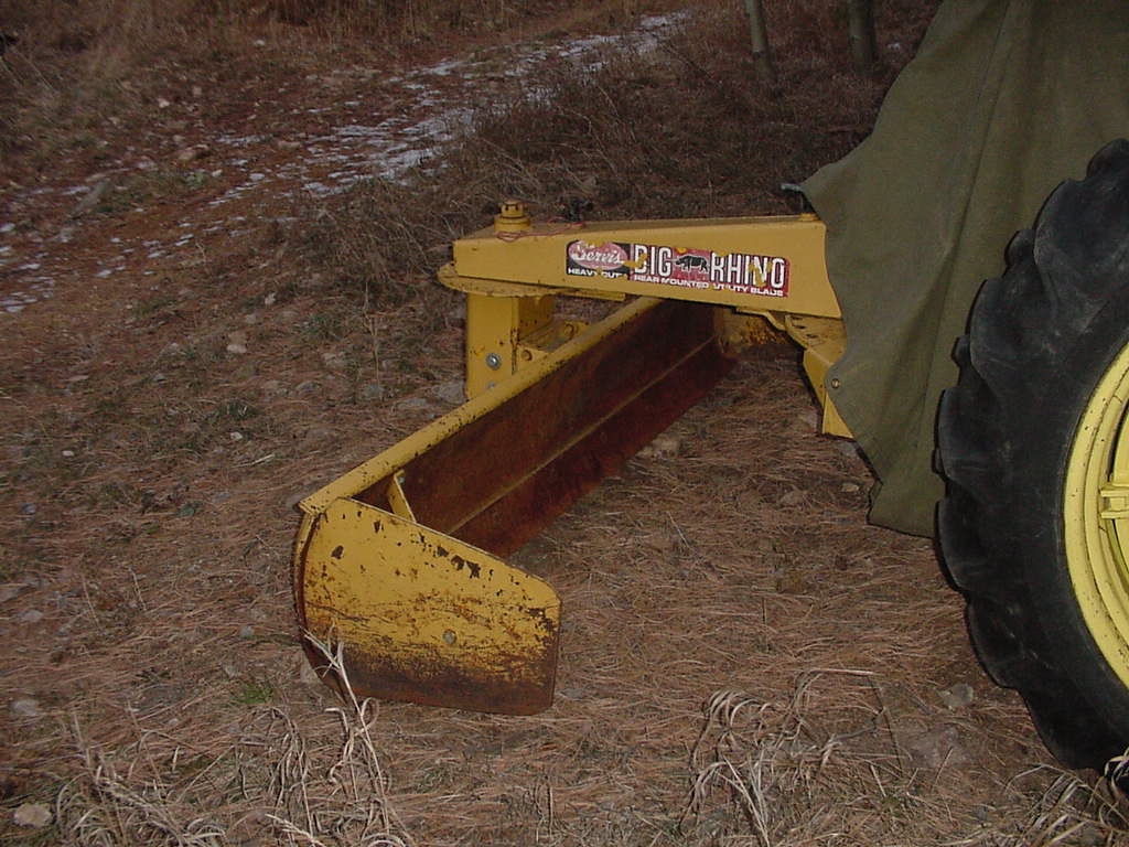

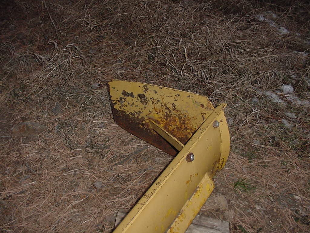

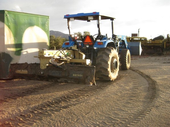

I realize that. Here's a picture of our 8 foot Big Rhino blade by Servis. It has similar reinforcement, and was rated at 90 hp. Very heavy construction...
Servis was the predecessor to a lot of ther 3-way adjustable blades sold more recently by Woods, Monroe, LandPride, and Bushhog.
One advertisement I have from years ago called this blade design a "Gill Design" after the engineer who orginally designed that style of 3-way adjustment.

I like that side spillage diverter. Does it act like a box blade or does it still move dirt across the blade and just pile up there?
/ grader blade size? #11
It all depends on the angle of the blade and the dirt. With the blade not angled and with both end caps mounted I think it would work just like a larger box blade. I have used it that way, but it fills up fast enough to stall my tractor. .
So even though it has an end cap for each end, I often just pull it with one cap mounted and give the blade a slight angle. That way the dirt moves along the blade and spills out the far end. Useful for widening a road.
With a little tilt, a little angle, and a cap on the "digging end" - and a heavy enough tractor - it works fairly well for cleaning shallow ditches along a dirt road and creating a crown. I don't know of anything other than a road grader that does that job well, but this does sort of OK. The problem is whenever it hits a rock or root the blade tries steer the tractor so it's not perfect.
I've only seen end caps for sale as options on the 3 way blades, but they would be worth having on any sturdy blade.

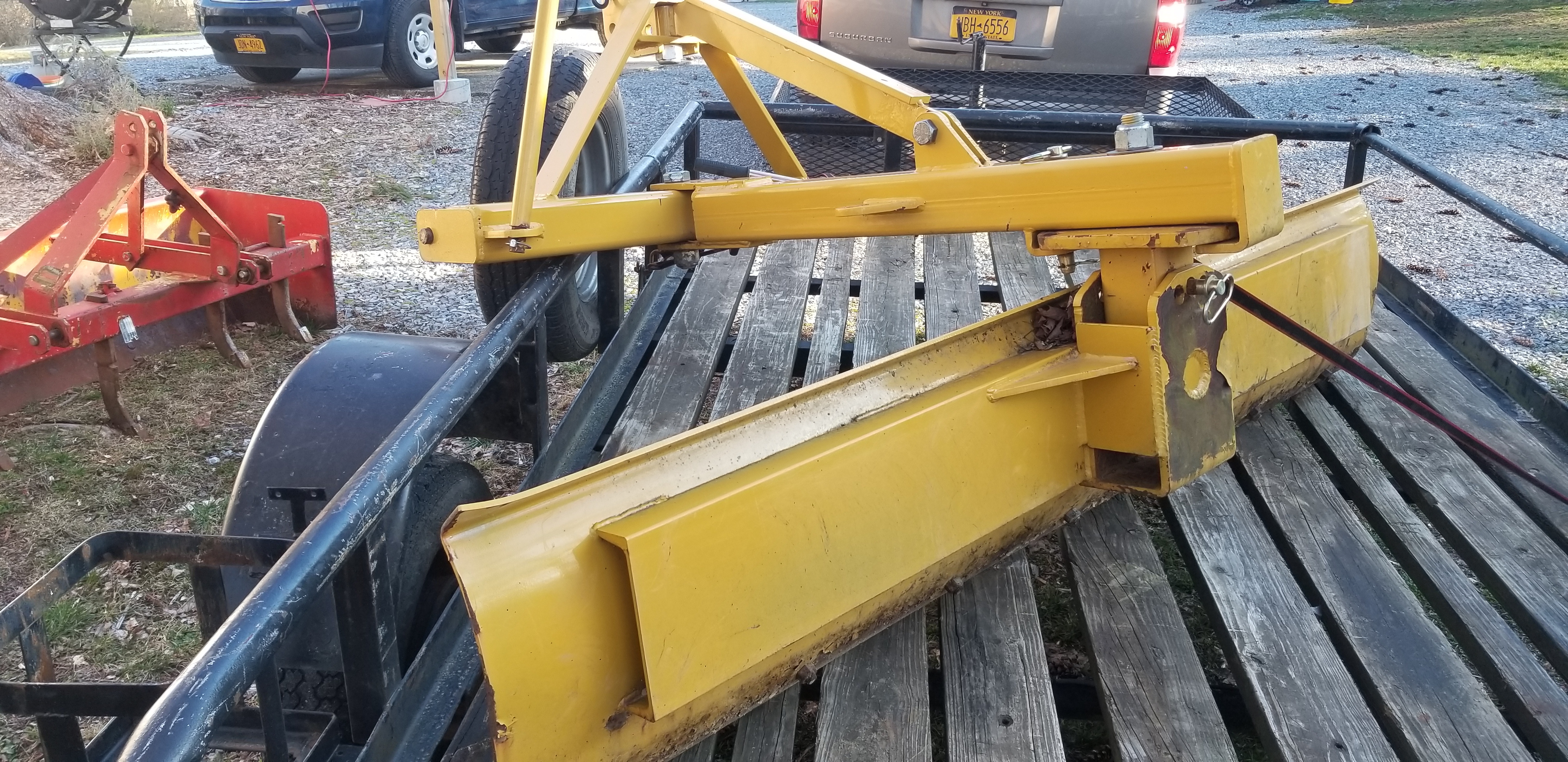

I had that same model on the trailer 20 years ago, built by Midwest Implements. Strapped to the pallet, it weighed 680lbs. Put it behind a 10,000lb machine and it bent the very first time I used it. I bought it on the recommendation of the dealer.
As I had mentioned earlier, it may not be the blade that bends, but the turntable and guide as well as the main pivot pin are on the weak side. I used that blade for 2 years before getting my LandPride RBT45108.
