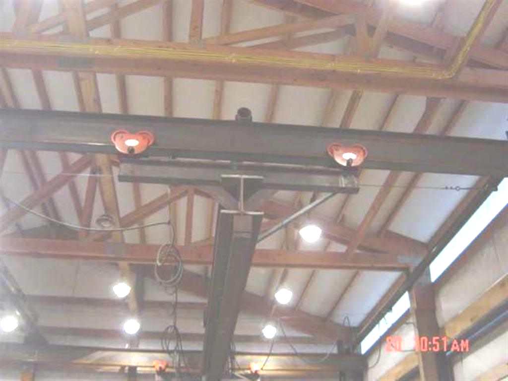

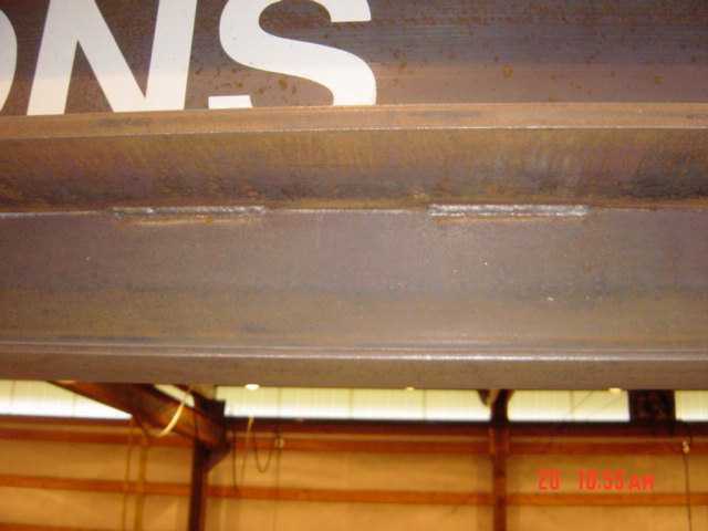

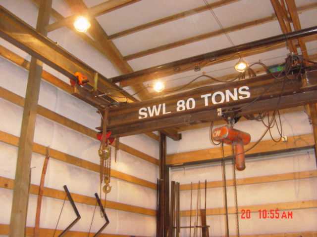

In this situation I wouldn't even look at an I-beam / S-shape. They will get very tall before getting any real load capacity! I would look at wide flanges, and rip an S-shape and weld it to the bottom of the wide flange for the trolley to run on. That is what a structural engineer suggested to me for my 24-foot span bridge crane.
/ I Beam for structural support #25
Your shop is close to putting MARCO to shame
/ I Beam for structural support #26
Does that for real have a SWL of 80 tons??? Cause it dont look anywhere near stout enough. Heck, our 15ton crane at work is massive in comparison. The two beams it rides on (above and not suspended) are 36" depth and span 30'. The hoist itself is on beams at least as big as the one you have labled 80T, AND there are TWO of them AND only spanning 15'.
Not saying it wouldnt do it, just skeptical is all.
/ I Beam for structural support #28
No! Those were two beams in a spreader bar I used to set precast utility vaults on an aircraft carrier pier I worked on.
Thats kinda what I figured. Scrap re-used from something else. I just was unsure how to ask (and almost didnt) for fear of starting a pizzing match:mur:
Have you calculated or know what IS a SWL for that?
Doing what you did makes it a bit harder to figure...with adding a cut section to the bottom.
/ I Beam for structural support #29
According to my engineer buddy, center of the span beam which is a W 12x87 is the strongest point of the crane, with a SWL of 2-tons, with a 5 to 1 safety factor. The weakest point is between posts in the center of one of the rails which are S 12x31.8, SWL of 1-ton.
I designed the crane, but my buddy approved everything but the welding. He said if I couldn't handle that he'd kick my ***. :laughing:
/ I Beam for structural support #30
I trust him not to double check everything but that does make sense. That main beam is huge compared to the two carrier beams. He's saying that those are the weakest links, and just looking at it, is probabally right.
But the welds.......:rolleyes::laughing:
