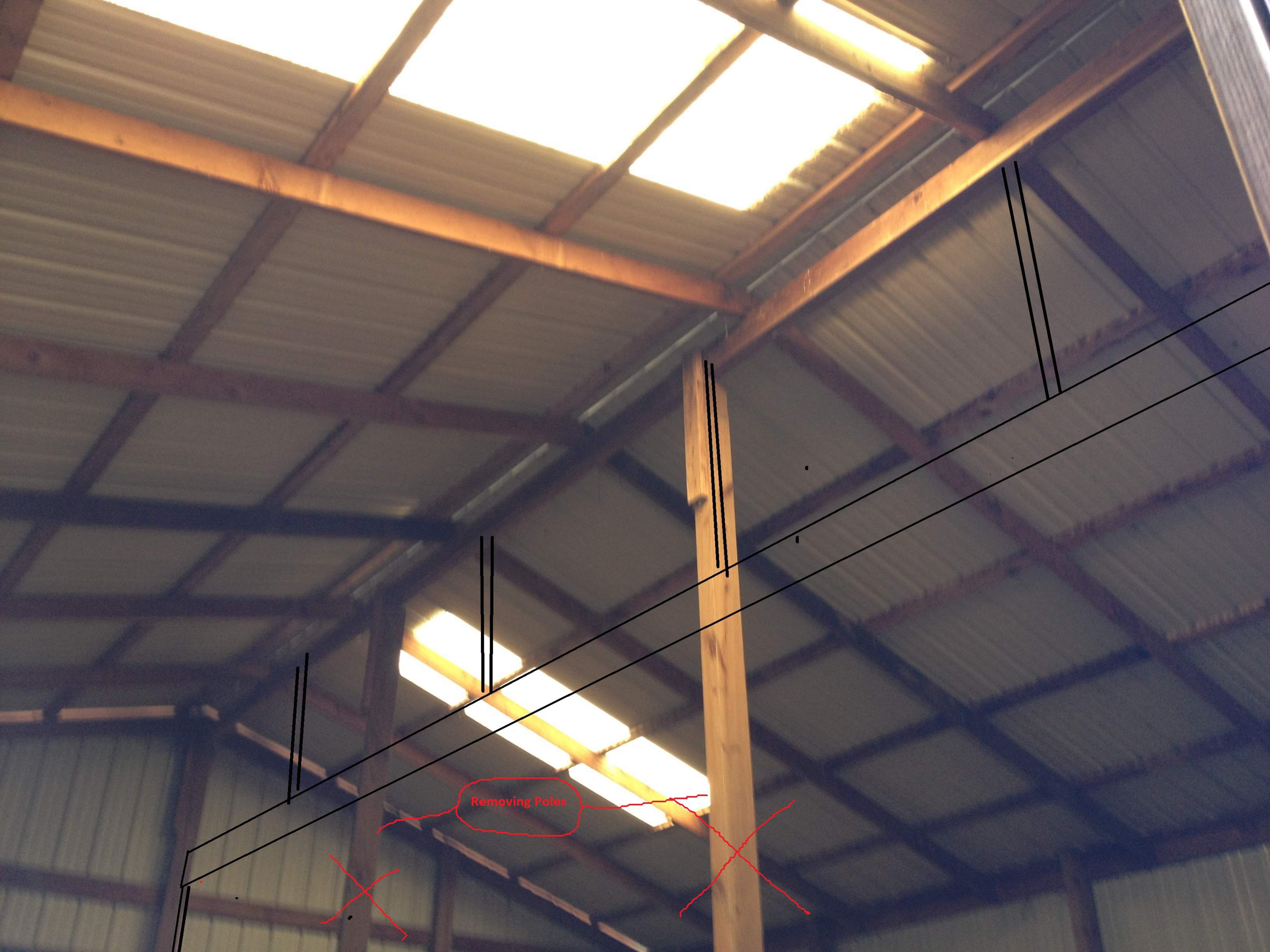

I can add as many vertical supports as necessary to evenly distribute the roof load couldn't I? Wouldnt that accomplish a similar effect of the floor joists against the beam? As far as the beam supports I planned on doing something comparable to crazyal's set up. Would it help if I upload a pic of my current set up with a drawing of what I plan to do? Its going to be a really rough drawing... but it will depict the basic idea of my approach.[/QUOTE]

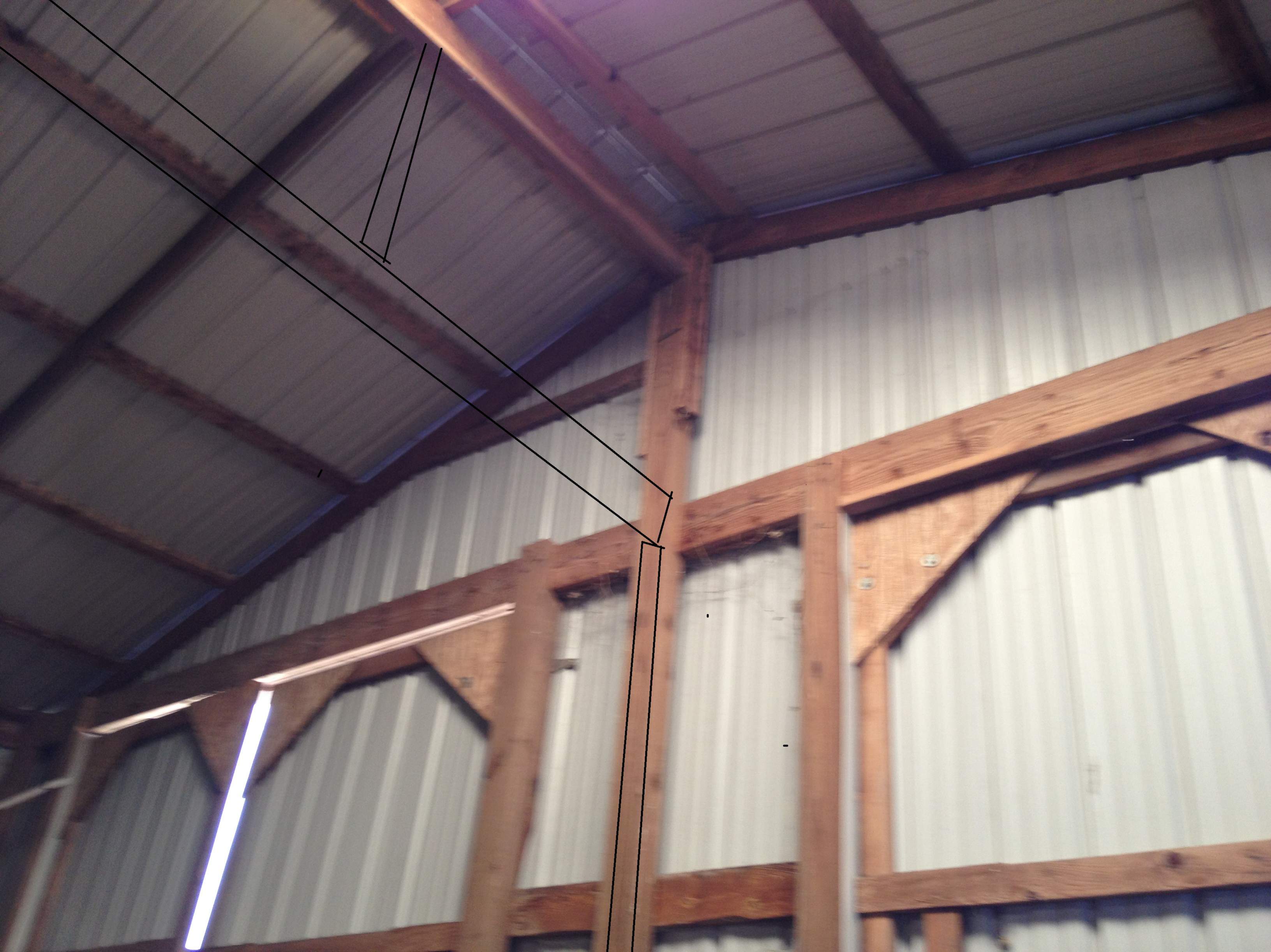

here's a couple of rough drawings of my plan.... any suggestions how to improve? As far as snow load goes...I live in North Texas not sure thats a huge concern.... but then again the old saying wait five minutes and the weather will change here in texas comes to mind!

After looking at your pictures, you'll definitely have to convert those rafters to a truss system, and need a stout beam to bridge that span. If you do it right the trusses can be separate from the beam, leaving the beam to be nothing more than a trolley track.

so you dont think my drawing on the picture will be sufficient? (assuming the beam is the correct size), starting to sound like this may be more trouble than its worth. Maybe I should just live with two poles as the support.

The pics definatally help. And adding more vertical posts will certainly help distrubute the roof load. BUT the roof load is still a big unknown. We need to knwo what it was designed for. Until then, we are just speculating. But we can get close but need a little more information.
For starters, I dont remember if you mentioned, but how wide is the building in the direction the rafters are running, what size are the rafters (they look like 2x6??) and how far appart are they spaced.
If we knwo this, we can do a little reverse engineering to see how much load the rafters can handle. Knowing that we can better get an Idea of how much load the roof was designed to handle.
