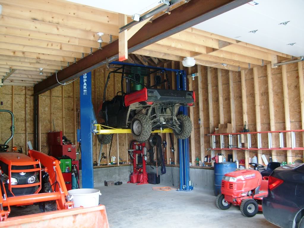

Just throwing this out there for a comparison. I have an i-beam supporting the second floor of my garage/ shop. It's 32' but has a 4"x4" post a couple of inches in on each end. I had a choice of using a w18x 55 or w21x50. The roof is trusses so the only weight is the load from the second floor. I went with the w21 since it was cheaper, had less deflection under the same load, and the loss of 3" under the beam wasn't an issue for me. I don't remember what weight was used for a floor load.
If you get it wrong then you could be starting all over again (unless you are under it when it fails). If you don't want to deal with an engineer then I oversize it by quite a bit and deal with getting it into place. I was able to use my backhoe but if I couldn't then I was going to use staging on each end and jacks and blocking to get it into place.
what else was done to secure the beam? I could be way off here but I would think the second floor load would be more than my wood framed metal roof? Is the beam exposed? Do u have any pics of the beam installed?

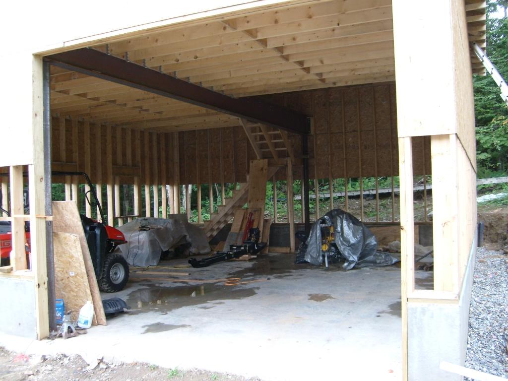

The 4x4 posts are welded to the i-bean and are sitting on some 3/4" 10x 10 plates mounted to the floor. Because of how I have the second floor mounted to it and the 3/4" flooring nailed and glued down creating a giant square there's no way it can move side to side or front to back. These are the only pictures I have.

thanks for the pics crazyal... nice set up u got there!
