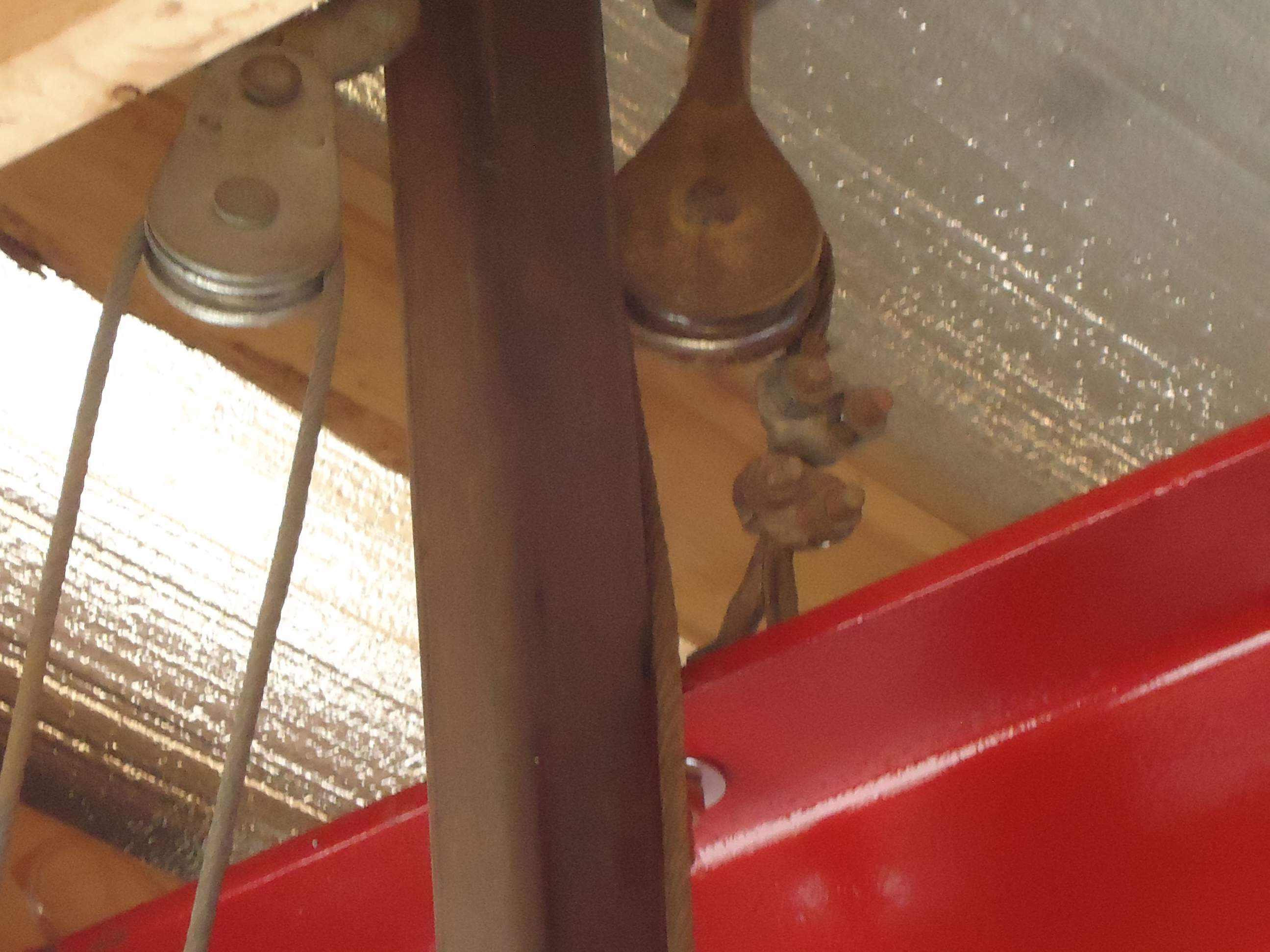

I made jibs to lift the beam. Space was limited, so had to do some pretty close calculations. I used double dogged 2 ton come-a-longs to winch it up there. With the space I had to work with, I had to take the hooks of the end of the cables, and ran the cable through an 11/16" hole, with a thimble in there to keep from cutting the cable, in some lifting brackets I made. I used the ole' IH 656 on the right, and Massey 180 on the left for boat anchors, pulling off the drawbars. I added some hook points, for pennant lines, to keep the pull off the uprights. Just got the cables taught on the smaller come-a-longs.
Took about 45 minutes to winch it up there by myself..., and that was taking a break about half way up to get a drink, and look things over... 10 clicks = 6" of lift. Look at the picture closely, and you will see just how much lift I had left... Didn't need it,as the beam was in place when this picture was taken. I figured the distance on the lifting rigging, so as the beam would swing in, and be on center. I did have to take a bar clamp,and scoonch it 1/2" to be OC., and 3/8" longways to be OC there too... Not bad for an ole' dumb country boy..., LOL...

7/16" flange X 5/16" web...
   / I-Beam up in the new shop, and 320 amp service set-up #13
How wide is the flange?? and I can tell you the size for sure.
And do you know if it is a Wide-flange type (h-beam), or is it the s-type (tapered flanges on the inside like channel iron)
#14
7" flange, and wide flange. I looked for the markings on the beam, but all I could see was USA, and another place New York, being most distinct. THAT in itself made me feel better..., LOL...
   / I-Beam up in the new shop, and 320 amp service set-up #15
I am just going to throw out a guess and say W16 x 36 beam.
Following specs:16 x 7 36 15.85 6.992 .428 .299
Section depth=15.85"
Flange width = 6.992"
Flange thickness = .428
Web thickness = .228
36 pounds per foot. So at ~27', that beam weighed 972lbs
Also, single load at midpoint would give a rating in the 17k range. I think it would work for about anything you want short of working on a sherman tank:D
