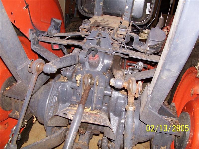

On my L the ROPS sort of clamps onto the axle housing. But I looked up the p/N on mine. About $300 and the replacement doesn't look that bad. The hardest thing looks to be removing the rops and wheel. Perhaps the fender to get some more work room.
Good Luck,
Rob

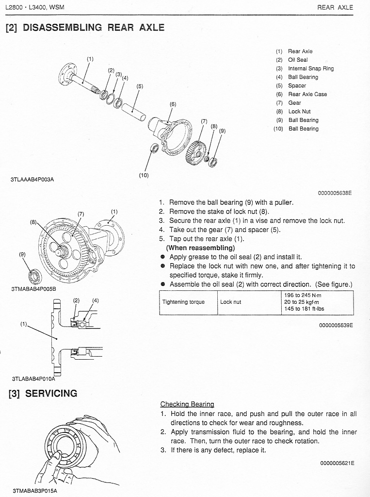

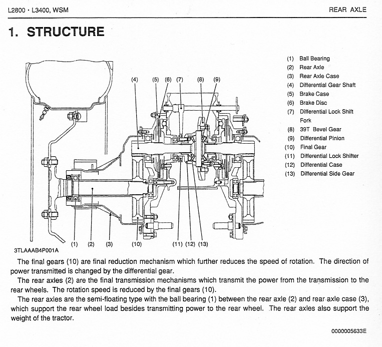

How much wrenching experience do you have? Have a ever done major engine repairs (rebuild, head gaskets, valves)? Have you done a brake job before (drum brakes...cylinders and springs and all)? If you have then I would definitely give it a shot. A manual may help but not always. I have a copy of the Kubota L2800/L3400 workshop manual and I can scan pages if you need. From reading the rear axle section, it looks like something you can accomplish in your garage. Looks like you may need a puller. Otherwise it looks pretty straight forward. I would also ask a mechanically inclined friend to lend a hand. I'll scan a diagram when I get a chance. And if you need help you always have TBN friends who can lend a hand over the net. Good luck!
   / I Broke It $ $ $ 3400 HST #17
Here's a diagram of the rear axle from the manual...
   / I Broke It $ $ $ 3400 HST #18
And one more...
