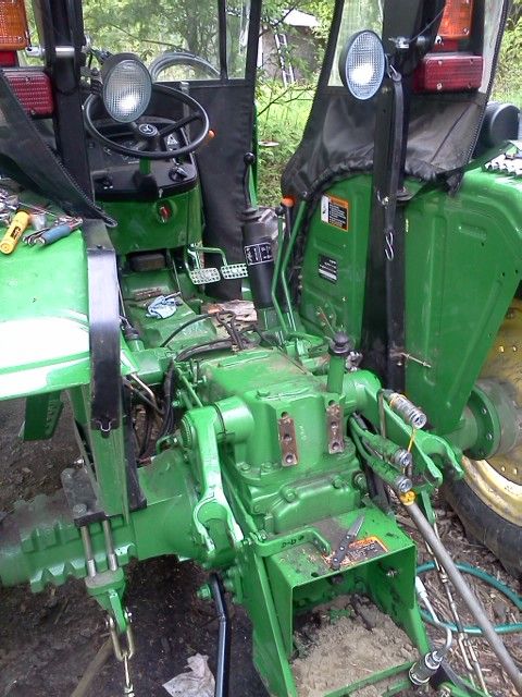

Anybody do this disassemble/reassemble before? Any info you can give me would be very appreciated.

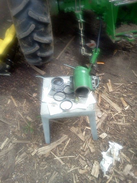

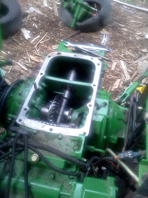

Well I got it apart. I couldn't see any damage to the piston rings or the cylinder so it must be the relief valve or it's o ring.
Free advice about proper reassembly graciously accepted. :D

I wouldn't say it let me down. I abused it beyond it's limits. At least no casting or other exorbitantly expensive part broke. There is just an awful lot of stuff you have to take off to get to this part.

Well I've got part way through the reassemble process. I found that three bolts going through the valve bodies were a half inch too short. Apparently the mechanic that installed the second rear remote used the wrong size. they only came through the valve blocks by three threads. have to wait till Monday to get the right ones. Anybody got a good trick to expand big (Two inch) snap rings. I have snap ring pliers but not ones big enough to spread these. They go on the ends of the rock shaft and hold on the lift arms.

What did you find broken, since you are into reassembly? You might be able to use needle nose pliers for the large snap rings (you have to pull them open, rather than squeeze them shut)
