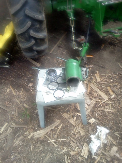

O ring part #21 was flattened. I changed both O Rings and the piston rings and the relief valve. No way to tell if the relief valve was working properly so changed it out to be sure considering how far into the tractor it is.
How did it get flattened? I understand you hooked onto a frozen log and asked the hitch to do more than it should, but isn't that the point of the relief valve? (i.e. how do you prevent it from happening again if you don't know the weight of the log or if it's frozen?)

What is the green part on the table with the rings?
Well for starters if you think something might not come along peaceable you should hitch to the drawbar not the 3PH. When I came to the end of the chain I must have brought the pressure inside the cylinder well above the relief valve setting and the pressure is what flattened the o ring and let oil escape past it afterwards. Also the pressure relief valve may have failed or it's o ring but I could see nothing wrong with them and don't have a test block to check it. I changed both O rings and the PR valve out as well as the piston packing to give myself the best chance of having it right when all finished. Noway to besure until you get the whole thing back together.
It was about ten below zero F when I did this and even though I was a half mile from the house the rear end and it's fluids may not have been all that warm so that might have had something to do with it.

The relief valve may not have been able to relieve the pressure fast enough. It it designed to pass the flow of the tractors hydraulic pump with a certain amount of pressure accumulation across it. The force of the tractor moving and the sudden stop may have forced the fluid to move fast enough through the relief that even more pressure accumulated behind it, as the OP said. A relief valve designed to pass 2 gpm won't do much to help components if the pump is several times larger.
Yes but I'm unclear as to why it would then pass fluid all the time. What keeps it from closing after the pressure spike is gone?
Take it apart and see what you can find. Maybe dirt in the seat. Maybe it was moved beyond it's design range and became stuck. Maybe a metal shaving from machining inside that never got cleaned out jammed it when it opened.
